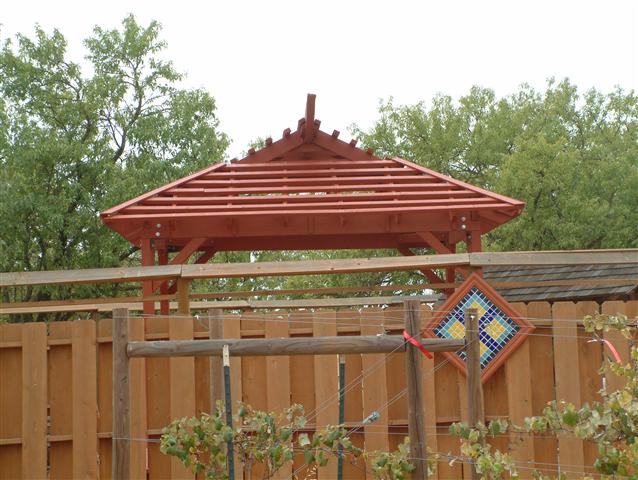

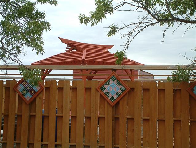

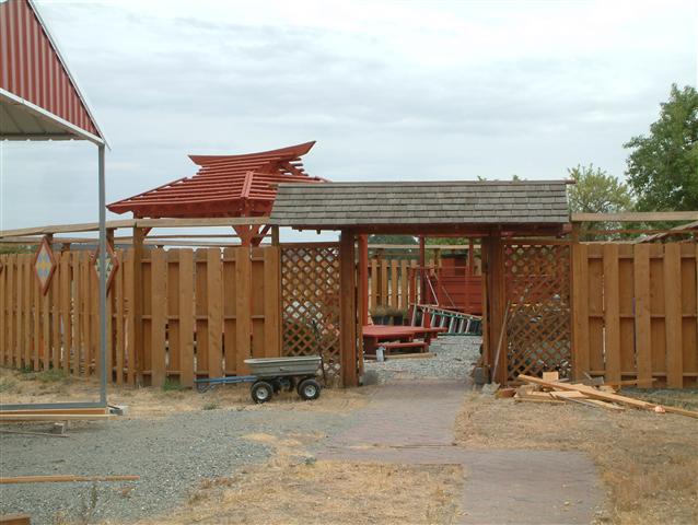

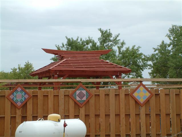

I like shadowbox fences like the one I built for my Japanese garden. I think they have a lot of style.
Posts are pressure treated 4x4s 8 ft long. The bottom 2.5 feet are coated with black automotive undercoat. The horizontals are pressure treated 2x4s. The fence slats are dog eared cedar 6" wide by 72" tall. Total fence length is about 140 ft.
