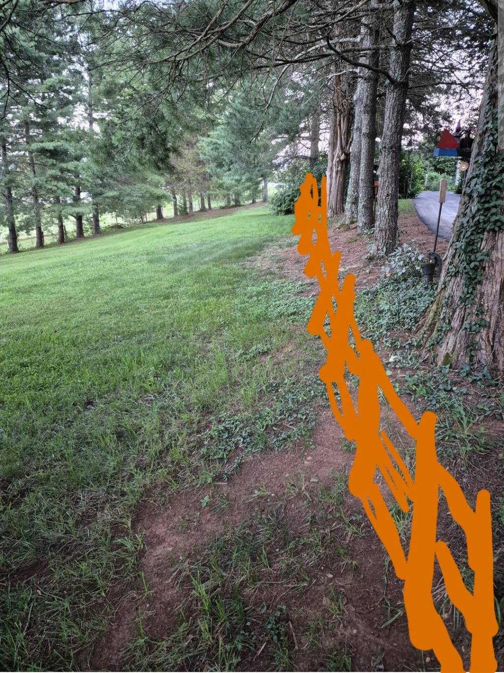

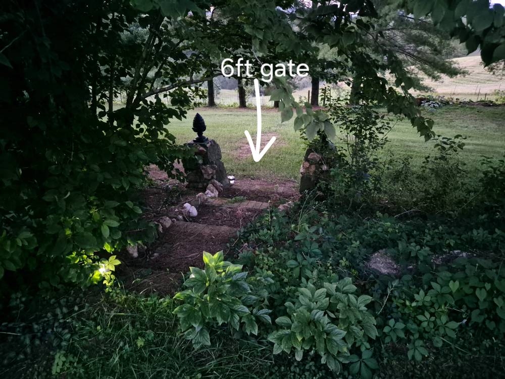

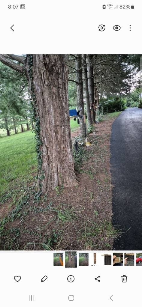

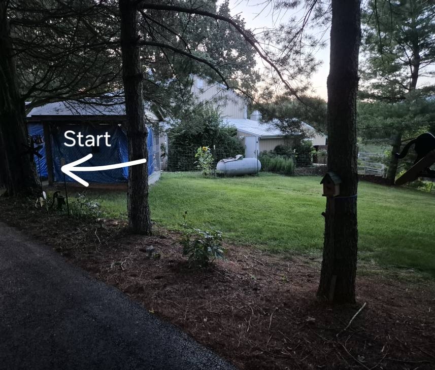

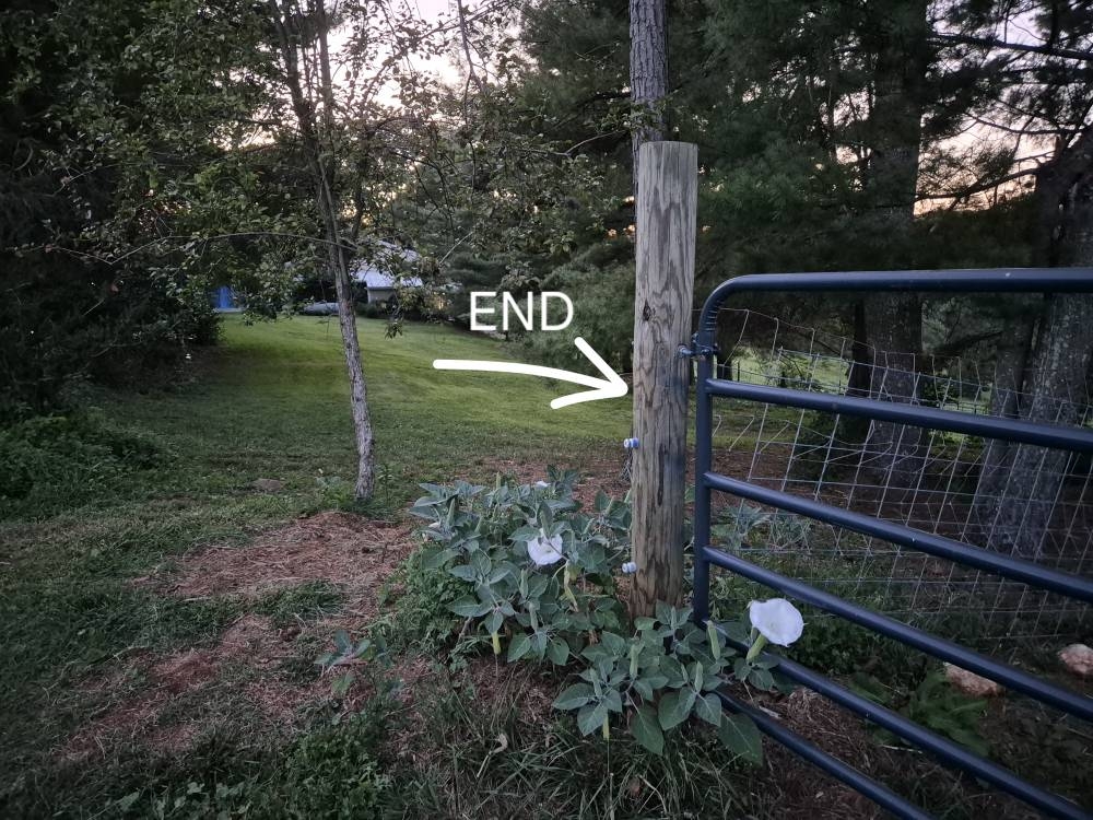

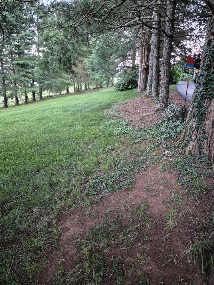

I want a simple 3 board fence. All pressure treated, 4x6x8ft posts, 1x6x16ft boards. Posts 8ft apart. Three gates, a 16ft, a 6ft & 4ft. Tarter steel farm gate.
It will be 186 ft. total, downhill about 10-15 ft. below driveway, fairly straight and level. We have horses and it will enclose about a 200ft x 300ft area. Another gate near horse stable I can close it off if I want.
I have a pto auger but it's a 9" Danuser.
I had a fence contractor look at it, he said even near trees posts every 8ft the holes won't hurt trees (??cutting through roots??).
His estimate was $5,010.
I priced Home Depot (lumber) & Tractor Supply (gates).
Contractor said 4x6 posts, 3 boards with upright board on post face.
If I do it myself:
186 ft.
4x6×8ft=$19 (24) $456
1x6x8ft=$6 (96) $576
16ft gate=$170
2) gates=$200
_____________________
$1400+nails,screws
Should posts be 2ft in ground?
Should I use 9" auger and set posts in cement?
Buy a 6" Danuser auger bit $250?
I have air nailers & deck screws...would screws be better?
I drew in about what it would look like.View attachment 929832View attachment 929833View attachment 929835View attachment 929836View attachment 929837View attachment 929838
