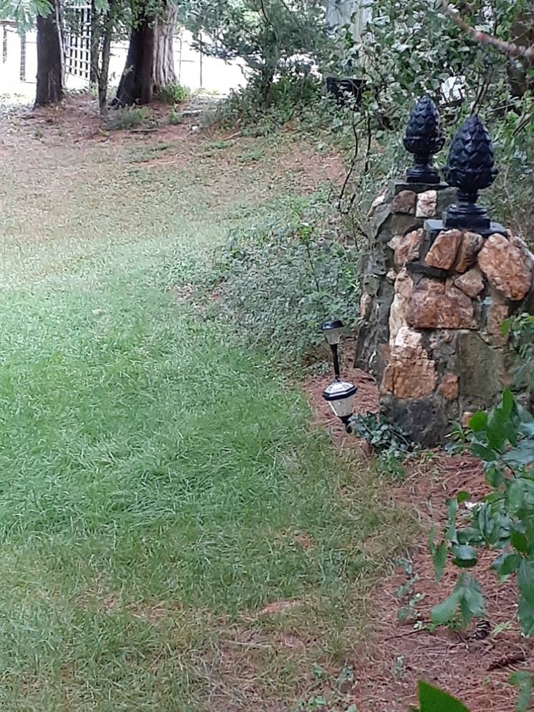

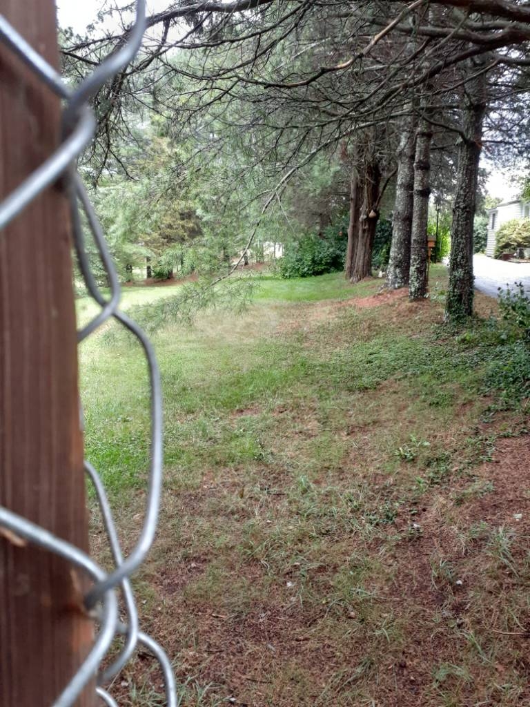

I'd like to fence 250ft near house across driveway and row of evergreens. First picture shows it, second is it starts at a building (6x6 pt post in concrete), run just below pines & cedars, a 10ft gate, over to step columns, a 4ft gate, over to an 8" pt gate post set in concrete. Sketch shows the idea.
10ft gate to rarely drive truck or tractor through, 4ft walk through.
It would be for horses, they now can go on two sides of area and I'd just put a gate there.

Close to trees I'm thinking I'd hit tree roots, my Danuser is 9" digger.

I would think digging anywhere near those trees you will hit roots and it will not be fun with a pto powered auger. A hydraulic one on a skidsteer would be ideal as if the hit a root and wind in at least they will unwind via the machine.
I think if you place a wooden post on each end of the trees and use t posts along the trees you will be ok, the trees act as somewhat of a visual barrier for horses and the fence will be the physical barrier. For fencing I like high tensile, it simple, its strong and durable and cheap and if done right looks great. Barbless wire of poly rope would be my second choice.

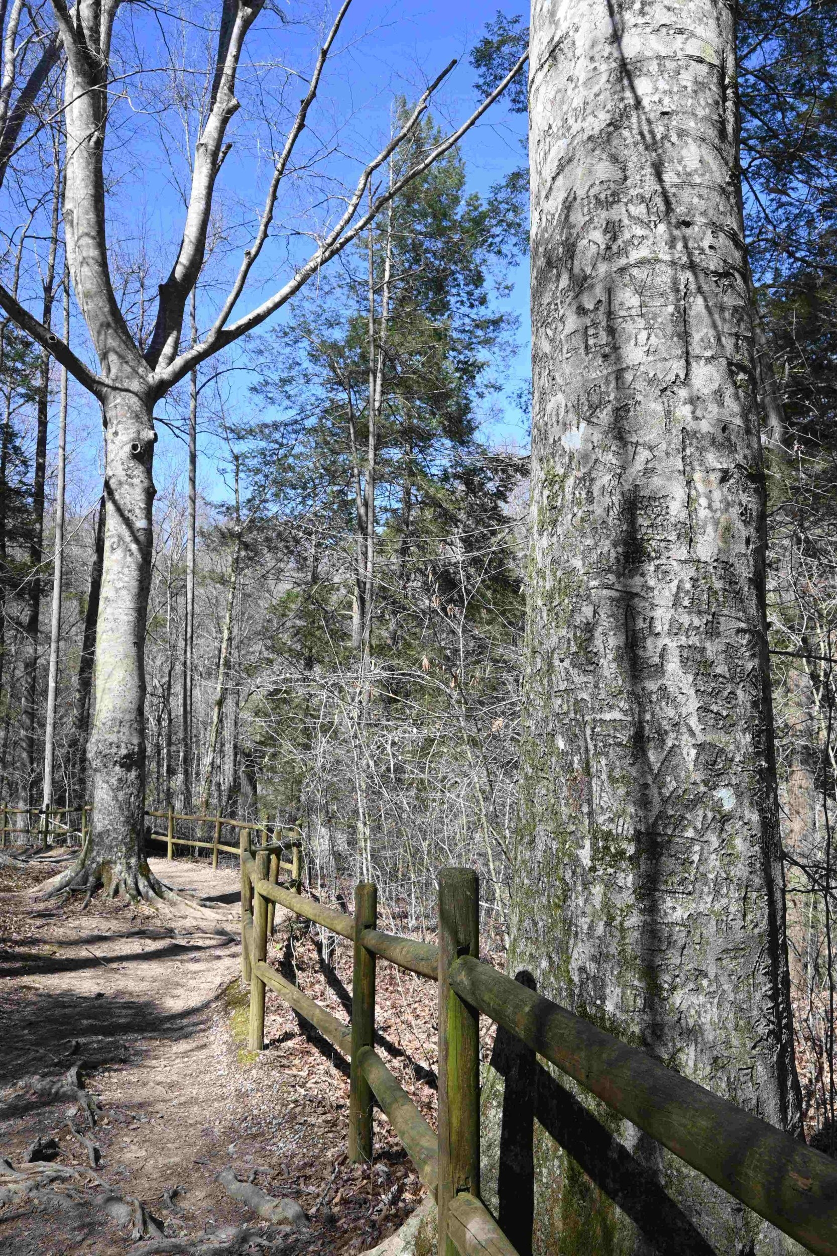

Traditionally, split rail was made from trees cut down on the property because it got rid of the trees and the material was put to use as fence. Most split rail I've seen seems to have been oak, not sure, but some kind of species that they could split. PT wouldn't look the same because it's been cut to dimension, it's pine, and pine doesn't split in the same way as oak and how would you split it all?
The most similar vintage style wooden rail fence I see being put up isn't a split rail, but round PT posts with round PT beams that pass through slots cut into the posts.

More of a picture of all the initials carved in this tree off a state park trail, but this is the style of rustic fence I see being installed these days. Still, it's a little modern looking because it's all round PT material where back in the day it would have been split oak and probably three rails instead of two.
