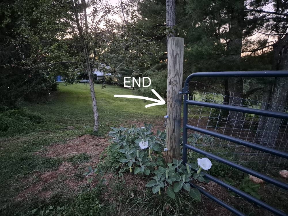

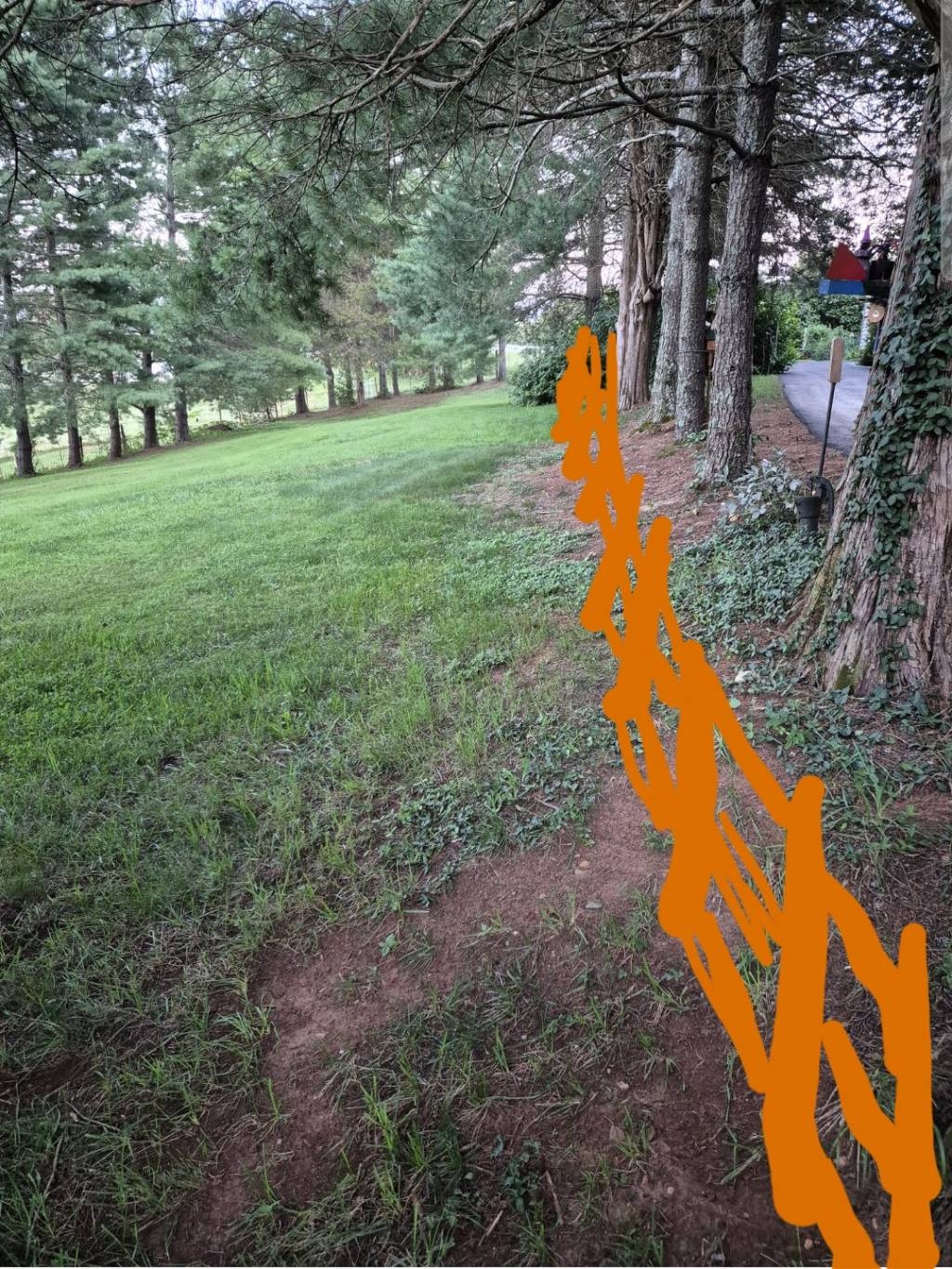

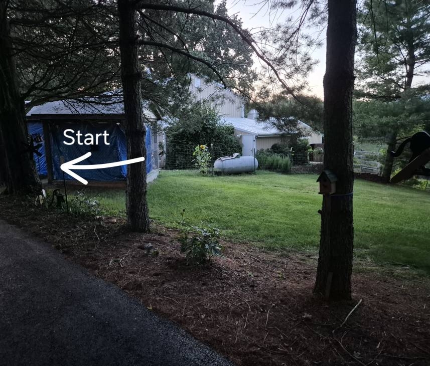

I want a simple 3 board fence. All pressure treated, 4x6x8ft posts, 1x6x16ft boards. Posts 8ft apart. Three gates, a 16ft, a 6ft & 4ft. Tarter steel farm gate.

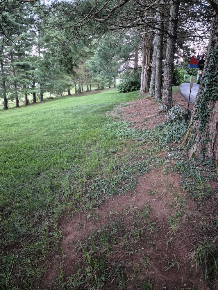

It will be 186 ft. total, downhill about 10-15 ft. below driveway, fairly straight and level. We have horses and it will enclose about a 200ft x 300ft area. Another gate near horse stable I can close it off if I want.
I have a pto auger but it's a 9" Danuser.
I had a fence contractor look at it, he said even near trees posts every 8ft the holes won't hurt trees (??cutting through roots??).
His estimate was $5,010.
I priced Home Depot (lumber) & Tractor Supply (gates).
Contractor said 4x6 posts, 3 boards with upright board on post face.
If I do it myself:
186 ft.
4x6×8ft=$19 (24) $456
1x6x8ft=$6 (96) $576
16ft gate=$170
2) gates=$200
_____________________
$1400+nails,screws
Should posts be 2ft in ground?
Should I use 9" auger and set posts in cement?
Buy a 6" Danuser auger bit $250?
I have air nailers & deck screws...would screws be better?
I drew in about what it would look like.

I think that using the auger that close to those trees, your going to be fighting roots. I personally like to go 36"inches deep and I just dry bag the concrete but I tamp it with a piece of rebar to pack it. The 36" depth is for when I am setting an eight foot post and want the fence to be 60" high. I suggest screws that are rated for PT lumber. The tendency for PT to twist may pull the nails out. There is a lot of board fence around me. Most use rough cut poplar boards which is readily available from local sawmills with treated posts. They add a vertical board over the horizontal board seams to stabilize them since poplar will twist too.

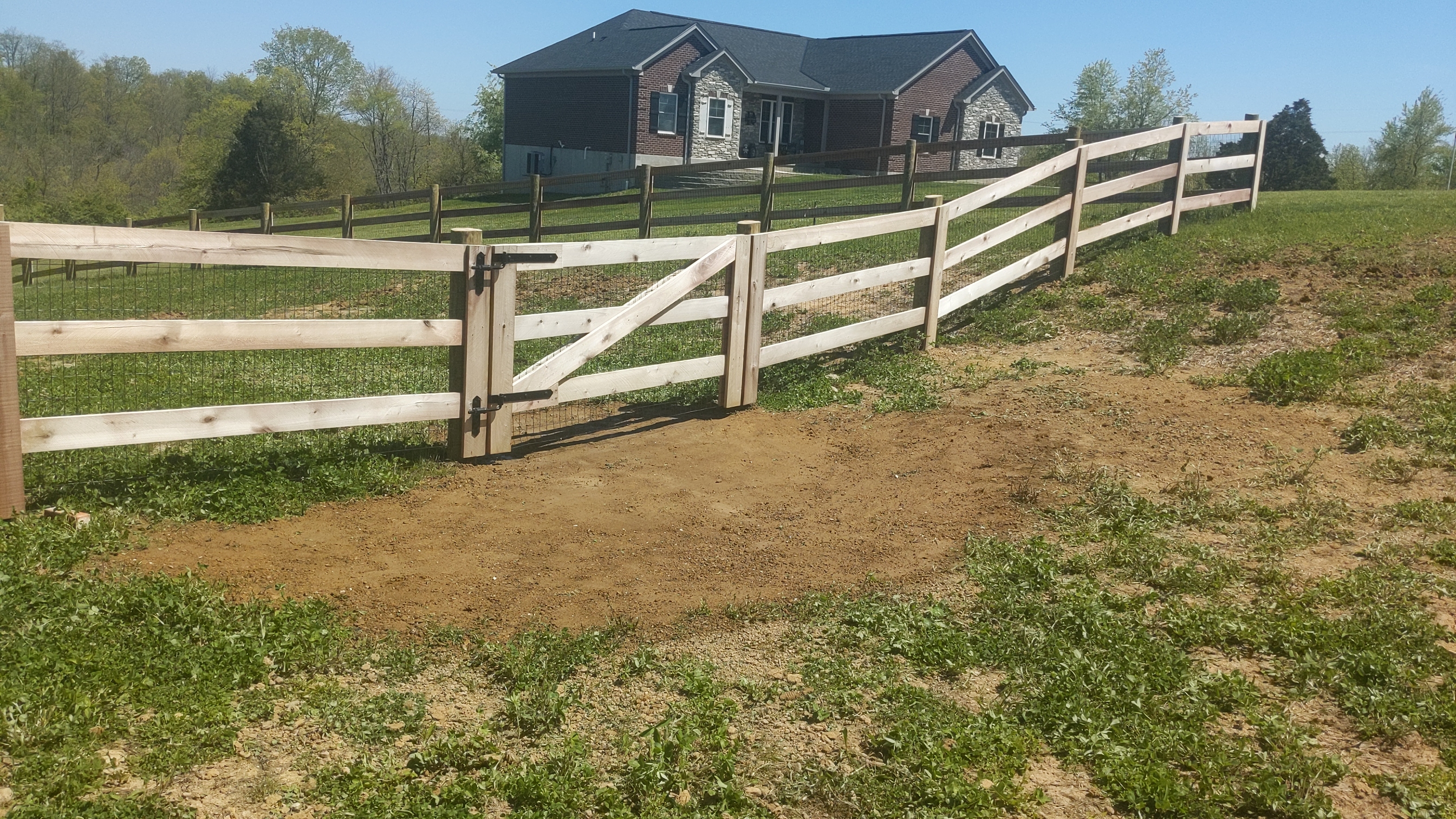

Consider a four-board fence. Looks much better and the spacing is better for animals -- in my opinion. The extra 4th board doesn't really add much to the cost after you have the posts and the rest installed anyway. (The classic horse fences that you see in KY are always at least 4-board fences.)

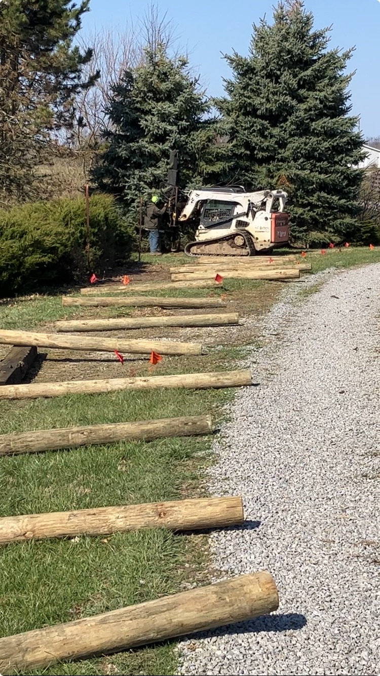

You're not talking about a lot of fence here, but it's still a lot of work. We had a bunch of fence installed last year. I hired it out and the guys that did the work really knocked it out of the park. They showed up with all the right equipment, materials, etc. Worked very efficiently. I'd still be tamping posts if I'd done it myself . . .
They nailed all the boards. No screws. We also installed 4"x2" no-climb wire because our main concern was keeping dogs in and coyotes out.
They drove all the posts. No tamping, no backfill, no concrete. Used a chain hanging from the post driver as a plumb-bob and a depth-gauge. The "helper" kept the post plumb in the other direction as they pounded it. They were driving a post about every 5 minutes.
This is one of those jobs that I used to do but now prefer to hire out. Wasn't cheap but worth every penny!
As far as materials -- they used 7' long 5" round posts. They're driven 3' deep. Poplar boards -- rough sawn full 1" x 6" x 16'. Boards are staggered so two end on each post and 2 span each post. A trim board covers the nails and face of the posts. For a board fence, you don't need any concrete or braces on the corners unless you're hanging gates, etc. The boards provide support. If you pull wire on a fence you'd have to use anchors and build corner braces to keep from pulling your corner posts out of the ground.
The contractor bought his posts by the truckload from a place in Southern Ohio. They were much straighter and more uniform than posts I could find locally. Same with the boards.

The trees are a problem. Yes, I have done it like you show, covering an old fence line with new. Your auger will only work between root leaders (and you will still shear a lot of bolts). Unless you literally cut them out below ground with a chainsaw, axe, digger bar, grubbing hoe, handsaw, or your teeth. I've done all but the teeth. The advice on "stepping out" is good advice.
