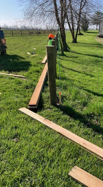

OK, I'll add one other tip I learned the hard way on fences. To make this fast and efficient, make a spacer out of a scrap 1X6" to separate and align your boards (I still have one in my "kit" for fencing). Get a strong clamp - like a 3/4" or 1" Pony clamp with a worm gear. Why? Well 14-16' planks are not perfect for "bows" - you can take them out easily by "pinning" the end of one board with one screw at the top to the desired height and then the next post with one screw as well. The last 8' section can then be manhandled into position with the screw clamp. Clamp in place with the Pony clamp. Put in the remaining screws - in my case, I use three vertical in the ends, three in the center of the plank on a diagonal, and three at the other end. Weather and time will take out the bow quite well.
/ Board fence ideas? #25
Great post!
That's what I do, too. (It took me longer than I really care to admit to work that out. I grew up doing barbed wire fencing.) Works like a champ. And x2 on the use of screw clamps over the wimpy little squeeze clamps. I use two spacers, one at each end, because I am the only person building the fence.

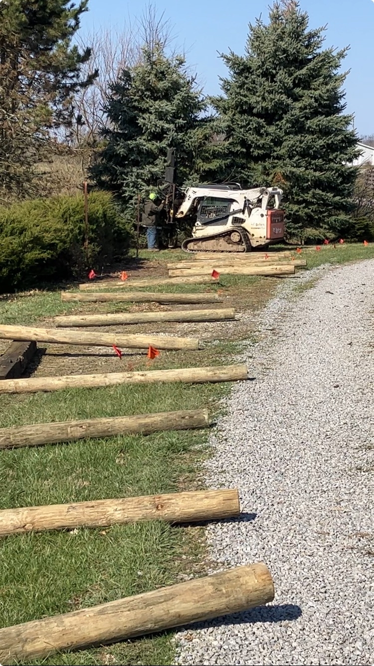

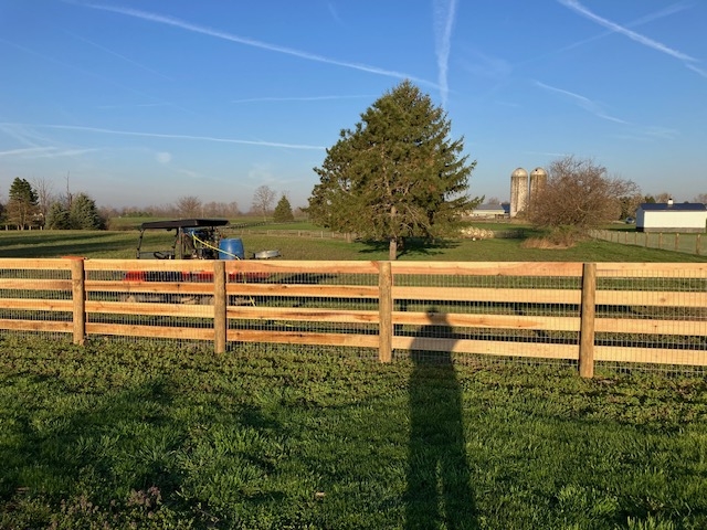

I just finished adding on another pasture fence almost exactly as you described. The original fencing was done in 2003 and is 4x4 pressure treated post that are about 3' in the ground. I use 5/4 16' long decking for the rails. I had to remove one post from the original fence to put in a new gate. That post looked almost new below the ground. No concrete used except for where I put a gate. For the gates, I used a 6X6 with concrete. I recommend the 16' boards because they add a lot of stability to the post as long as you stagger them.
The guy that cleared the area for the new fence used a 9" auger until he snapped it with the rocks and roots I have here. He then had to go to a 6". I'd recommend the 9" as it will give you a little more leeway. We worked much smarter this time around and didn't measure with a tape measure and post level. We just used a post level, height jig for the rails, and the length of the rails themselves to judge we were putting the post in a good spot.

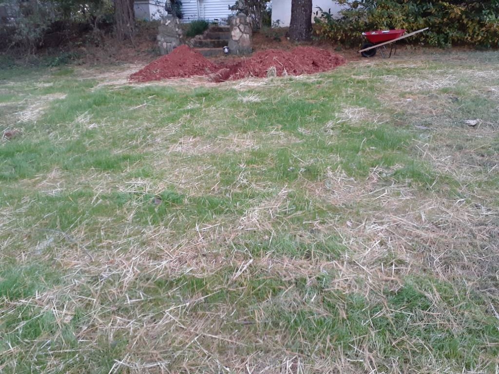

In 42 years here, limbs fallen there were 2" at most diameter. I'll use 6x6 posts and 2x6 boards...should be strong.

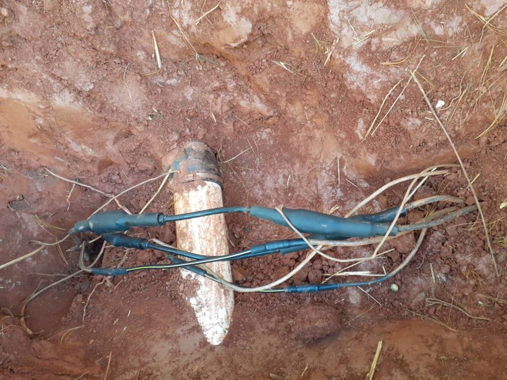

I'll need area marked carefully for electric, drain line and water! I'll use it as a starting point to avoid it. It's at bottom of steps I made years ago. These pictures a year ago when I had drain replaced.
Times like this I wished I had ground penetrating radar!
Miss Utility will mark if I slip them some cash.
Miss Utility will mark if I slip them some cash.View attachment 940269View attachment 940270
I think that getting the pipes wires traced and marked is likely to be worth whatever it costs...an ounce of prevention and all that. I found a used wire tracer for cheap and it was worth every penny to me, as the buried feeds to my outbuildings didn't go where I thought they would go, they zig-zag around. (And the internal property wires aren't on the 811 list, of course.)
All the best,
Peter
/ Board fence ideas? #40
Around here before you dig, even putting in flowers, you are required to call 811 and all utilities are required to come mark their lines, for free. My experience they are usually marked within 2 days.
