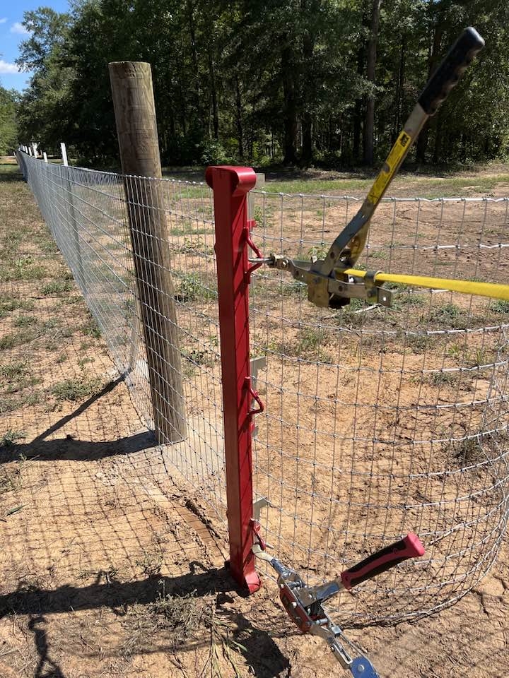

Just finished up my main gates and laid out the fence perimeter. I'll need 4 rolls of wire. Planning to get all the gates in first. I have 6 of them.

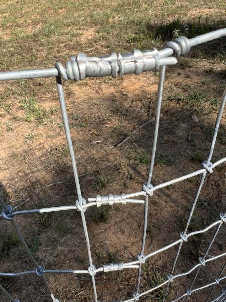

You also need to find a good crimper to connect each roll of fencing. To me, this is the thing I hate the most. My crimper does the job, but I hate using it. I put two sleeves on the top and bottom wire, and a single sleeve on the other wires.
What type of crimp and crimper do you use?
All the best,
Peter

I started out with Red Brand 2x4 horse fence in 200 foot rolls. I was getting them from Lowes for $240 a roll, plus 10% off for my military discount. It's good fencing. Then when everything became hard to find in 2020, I bought whatever I could find, wherever it was sold. Tractor Supply and Atwood's would get a roll or two, and I would buy it as fast as I could. Prices shot up to $330 a roll for OK Brand, which I paid. In the last year, supply has gotten better, but it's still hit or miss if it's in stock at my local stores, or if I have to drive half an hour to an hour to get what I want. Lowes hasn't had much for fencing until recently, and their prices went up to $360 a roll for 200 feet of Red Brand, but OK Brand is down to $299 at Atwood's and Tractor Supply. I just looked online and Tractor Supply is on sale for $269 a roll. I'm buying OK Brand, and except for the red paint, it's the same thing as Red Brand.
I stretch 4 point high tensile barbed wire from corner post to corner post to lay out my wood posts every 100 feet, and my T posts every ten feet. I set all my wood posts in concrete. I've pulled enough wood posts out of the ground with and without concrete to know there is a significant difference with concrete.
I'm not a fan of H bracing. Every H brace is only as strong as it's diagonal bracing. I'm using 2 inch galvanized pipe set in concrete for my diagonal bracing. On long runs, I'll put diagonal braces on my wood posts every 200 feet.
I'm using a Man Saver T post pounder to get all my T posts in the ground. It's really impressed me, and at the end of the day, I'm not dead tired or sore.
If you don't have one, be sure to buy a Clip Bender. I wore my first one out and bought another right away. When I wear this one out, I'll buy another. Nothing works like it does, and once you've used it, you wont' use anything else.
i just put the two vertical end wires together, then double back the horizontal wires to loop the two together and then wrap the horizontal wire back on itself for each horizontal wire. No crimp sleeves needed.

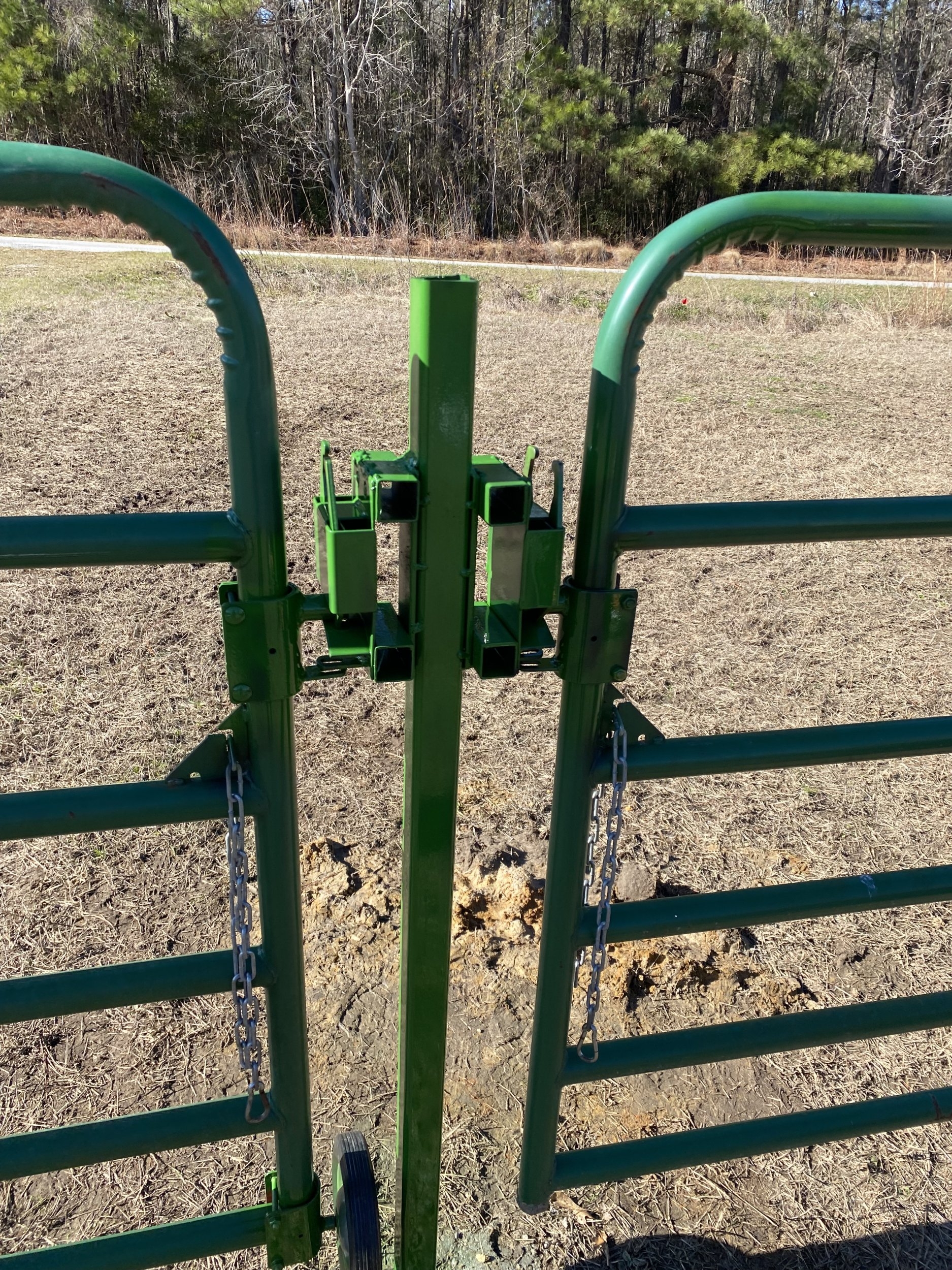

Only my main gate will be pipe panel. The others are just old school posts hinged with wire on one end and latched with wire on the other. Not sure what the official name is for it, but most ranches back home use them. Much cheaper than buying many gates.
All the best,
Peter
I bought this 4 slot crimper from Kencove because it was cheap, and I didn't realize how awkward it was to work with. The handles are kind of stiff, and to me, it's just a pain to get it into position to squeeze the crimp sleeves.
Eventually I will probably spend the money and buy one of the more expensive 2 sleeve crimpers I really hate the one I have, but it gets the job done.
I put two of the C34 sleeves on the top and bottom wires, and double crimp each one.
Then I put one of the C2L sleeves on all of the other wires, and double crimp each of them.
I watched some YouTube videos on tying fence wire, but it seemed like a lot more work then installing the crimp sleeves. I also worried that I might be creating a weakness if the fence by bending the wire too much when tying it.
I suspect that you are right about splicing vs. crimping, but I have no data.
I only rarely crimp barbed wire because of the hassle, but I have used a cheap hydraulic crimper, with one anvil flipped to be flat to crimp that style of crimp, but I have no idea if it would hold high tensile wire.
