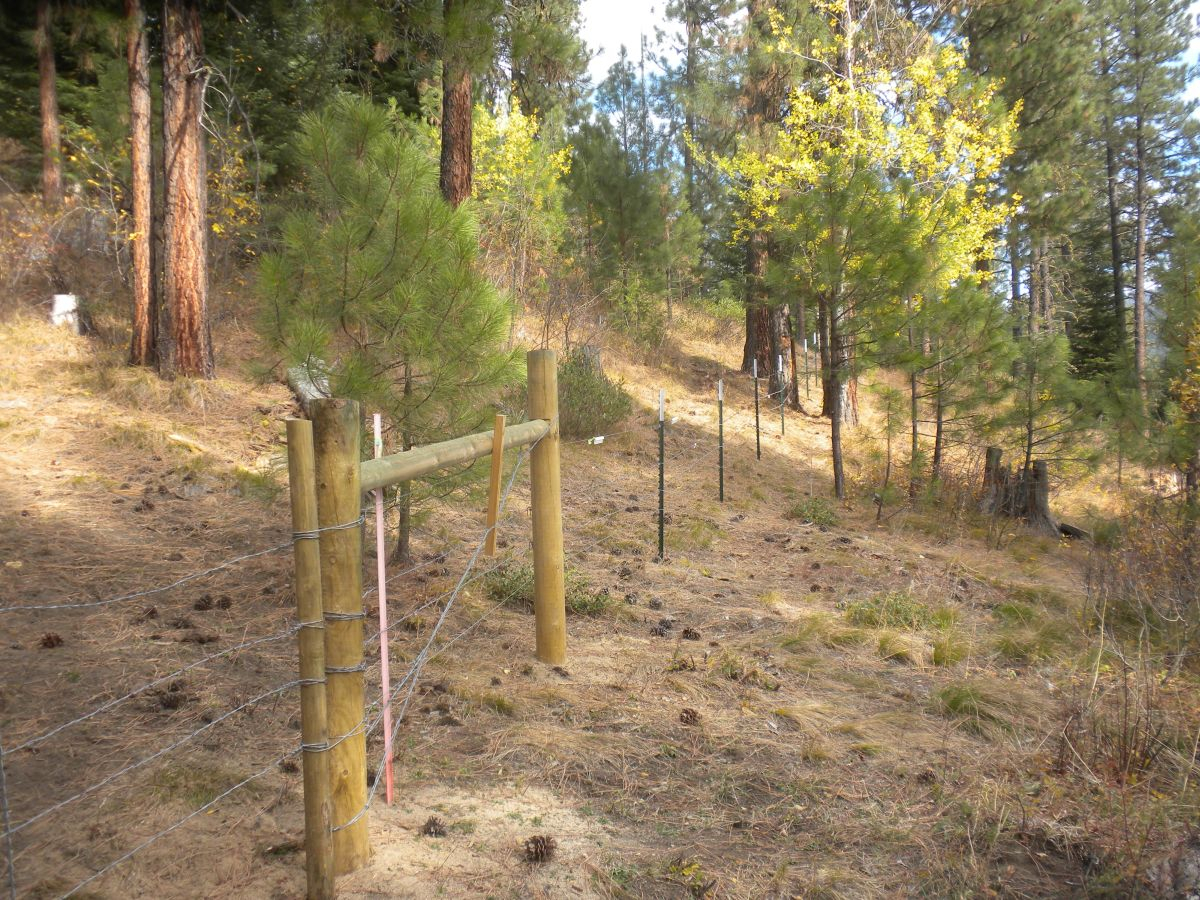

I've run across deer and elk that were caught in wire fences and obviously died a horrible death when I worked for the Forest Service. It happens regularly enough that all the western state wildlife agencies have produced a publication on how to build a wildlife-friendly fence.
http://www.emwh.org/pdf/conservation/bridges/How to build fence with wildlife in mind.pdf
The key elements are height - especially for animals that have to jump a fence when they are headed uphill on a steep slope and wire spacing. The major trap is the spacing between the top two wires. An animal bumps the top wire while jumping, slides down a bit and gets their leg in front of the next wire - after the fall the leg is trapped in the twisted wires and there's no getting out. A wider spacing between those two wires helps avoid that.
Whether the fence is barbed wire or not is less of an issue. When I built our fence I put smooth wire on the top and bottom and barbed for the middle two strands. The smooth wire is the high tensile stuff and it is way more durable and easier to work with than barbed. If I had it to do over, it would be all high tensile smooth wire, and as the barbed wire breaks, I'm replacing it with high tensile. In 5 years a grand total of 1 calf has managed to get through it - probably in a depression where the 16 inch bottom wire height left an even larger gap.
