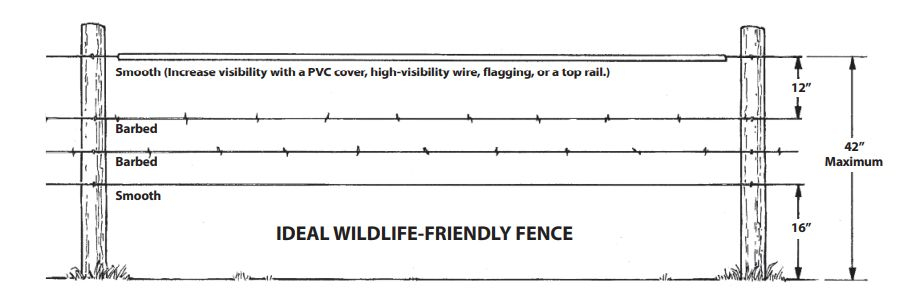

After reviewing the "wildlife friendly" pdf referred to earlier, I decided to install a wildlife friendly fence. A smooth wire top and bottom, with a two barbed wires in between.
In this area of my property there has been a mating bobcat pair. And a doe had a fawn nearby this year. My fence runs near a creek so there is a lot of wildlife traffic.
I'm glad I switched from woven wire to the wildlife friendly design. I saw bobcat tracks in the snow a day or two before work on the fence started.
This type of fence will not be good at keeping humans out if they are determined to cross it. But ... in a rural area a determined human can defeat just about any type of fence.
The only thing I haven't decided upon is whether to leave the top wire bare, or flag or encase it as shown in the diagram. At only 42" height I'm not sure that's really needed.

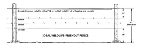

I think if you did a cost prospective of 4000 ft of plain wire fence as opposed to 2000' of barbed plus 2000 ft of wire fence, you would get a better direction. (If indeed you're attempting to fence in 1000 ft of linear fence)..Also figure in the ease of installation of plain wire over barbed. Over 2500 ft of galvanized shock fence wire costs about 65 bucks. 2000' of barbed will cost over $1000.
You could shock the entire 4000 ft with a continuous loop type installation.
