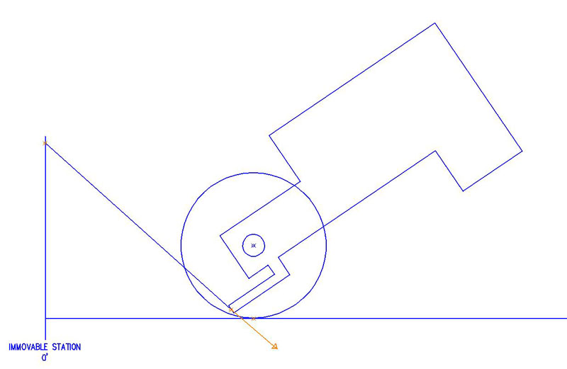

Here is a picture of what I'm talking about. If your drawbar is long enough and your chain connected high enough on the immovable load, you may eventually reach THIS condition, which DOES in fact pull the nose down as you attempt to drive forward. It can be any combination of chain angle and drawbar length or height that results in the vector of the restraining load pointing below the contact patch of the tires. Only THIS condition results in the nose being pulled down as you attempt to drive forward.
So for those looking for any configuration that would guarantee no back flip, here you go.
Any solution to the question I posed?

Something must bend or brake.
The geometry REQUIRES that the tires roll backwards as the nose comes up. If they are not allowed to roll backwards, the nose cannot come up. If the nose cannot come up, something in the drive train between the unlimited source of power and the frozen contact patch, or something in the linkages controlling the geometry (chain, drawbar, case, axle housing, wheel rim, etc.) must fail.
