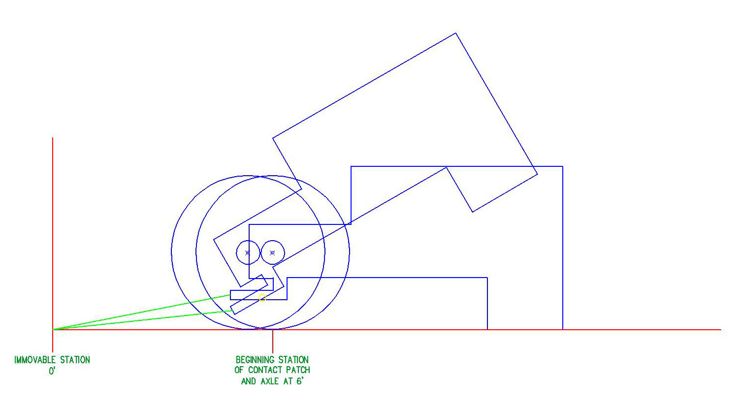

Here is an overlay of the two conditions. Please note that the physical pivot point of the whole tractor as a unit has remained within the space of the yellow circle throughout the movement so far. It is NOT at the axle.

IF the tractor has enough power to go past the equillibrium point I illustrated, AND the tires move backwards as you suggest, How exactally do they move backwards????
Are they slidding? (loss of traction) which whould result in the front comming down.
Or are they rolling backwards? IF so, How? with the clutch engaged, arent you trying to drive them forward? How do they go backwards? Lack of power?Clutch slippage?
Once you pass the equillibrium point, the forces trying to set the front down are een greater. Just the shear weight of the front in the air, plus the chain pulling on the drawbar.
The tractor DOES rotate around the axle, up to the equillibrium point. Because up to that point, the tractor is NOT moving backwards. If you care, do your little drawing again, with the chain and drawbar in a straight line (what I am calling equillibrium) and WITHOUT the rear tire moving backwards, and see where the point of rotation is???
Using the rear axle as a pivot, the whole tractor becomes like a lever. with the front wheels in the air, a rearward pulling force on the drawbar is going to try to set them back down.

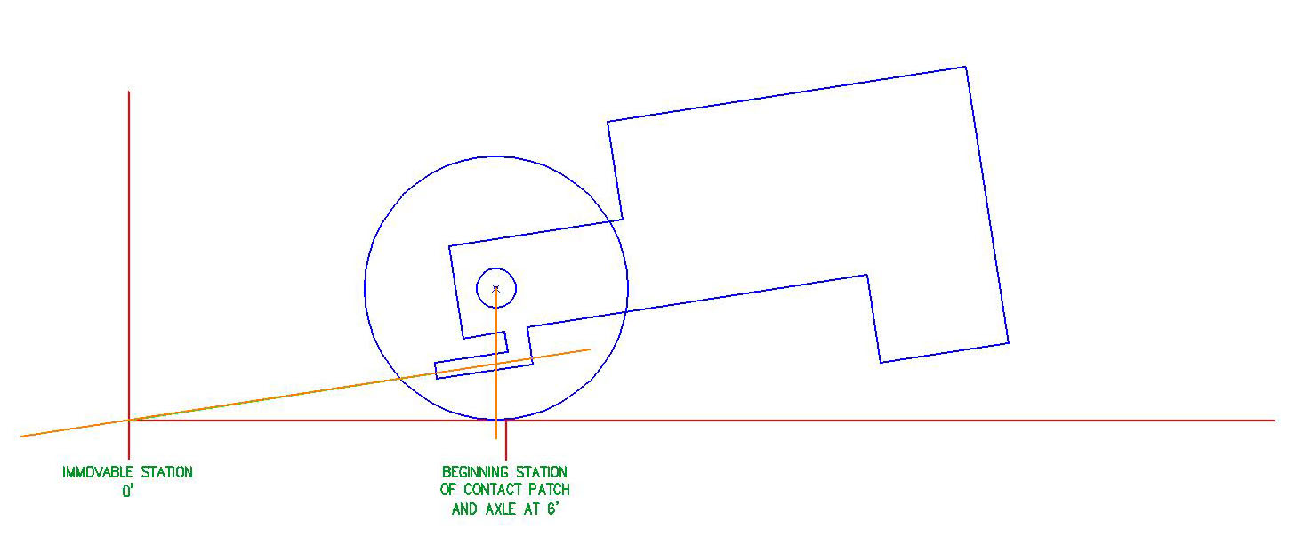

Not sure I can explain how/why it goes backwards. But it does. Think of it like this: If there is enough power/traction to move the system at all when it's absolutely restrained - which since we've seen tractors pull wheelies from pulling loads we know at least some of them do - then the torque available from the engine is enough to make the pinion gear start climbing the stationary ring gear. This brings the front of the tractor up, takes the drawbar end down, and by necessity starts wrapping the tractor backwards. So now the ring gear itself is slowly turning backwards, but no matter, there is plenty of torque for the pinion to keep climbing it.
Your right that the further it wraps itself, because of the design/location of the drawbar end, it becomes harder and harder to do it. Perhaps most tractors are designed such that their power/weight/geometry create a limit such that the engine will stall before it gets far enough back to flip. But assuming enough power and traction, which is what I've said all along, it will continue to wrap itself over. The only geometric condition that can prevent it is having the load vector pointing below the contact patch of the tires. Which is consistent with what I've been saying all along: The only things that prevent the flip are lack of power, lack of traction, or the resisting load vector pointing below the contact patch of the tires.
Here is my drawing angled such that the chain and drawbar create a straight line - ie. the longest possible scenario - please note that the tractor itself has backed up even to get to this point. I did not change the length of the chain at all. It can't be denied that the tractor must move backwards assuming any typically manufactured geometry.

Your mistake is suggesting that this component will somehow outweigh all the other component forces in action during the pull and prevent the front of the tractor lifting. It just won't, unless the overall load vector points below the contact patch of the tires as I've described already. This fact is true no matter the exact length or height of the drawbar or the connection details of how and where it mounts to the frame of the tractor.
xtn
Although I think we'll have to agree to disagree...what other components are you discussing? Traction? Weight? Pulling speed? Others?
Although I don't think any of these would overcome the forces I described in my previous post, my assumptions were (for sake of discussion) a straight pull on level ground. I can't make any assumptions about traction since soil conditions vary too much and I don't know enough about tractor tire traction on any given soil type. But I do believe the tires would slip first.
(EDIT: Reading your response to LD1, you assume the tires don't slip. That would likely be an erroneous assumption. And, your comment about "The only things that prevent the flip are lack of power, lack of traction, or the resisting load vector pointing below the contact patch of the tires" describes a theoretical situation more so then real world scenarios.]
As I wrote early on, I've never heard or read of any rear roll overs when pulling a load using the draw bar on level ground...never even read of a tractor rearing up...not on level ground. Closest one I'm familar with was a guy skidding a tree trunk upslope. It was a local guy (didn't know him personally) operating an old Ford or something like that.
Other then that one...no others that I'm aware of...do you have any examples you can share or link to?

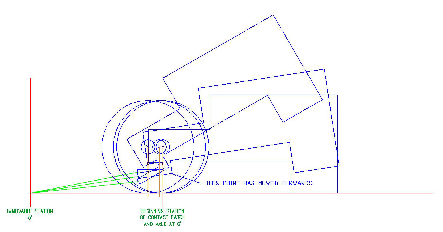

Okay here is an overlay of all three conditions. Note that the drawbar itself HAS moved forwards at your "equilibrium" point, because like you said the straight line allows the longest distance. But also note that since the axle is above the drawbar, it and the wheels attached to it have moved backwards. Of course how much it does so depends on the geometry of the bar in relation to the axle. I just eyeballed my etchasketch tractor here, but I think it's fair to say it represents typical geometries reasonably enough.
So we know that the tractor can begin to wind itself backwards. And we know that passing your "equilibrium" point will definitely increase the effort required. But if there is enough power to overcome that increased effort, the tractor can keep winding itself up.
xtn
Well, I still fail to see the logic of your "pivot point" and the whole "tractor moving backwards" theory.
I guess I could take it and use that to my advantage as to how the tractor CANNOT flip backwards.
For starters, the tractor, when unstable in the front to rear direction, can only pivot around two points. The front and rear axles. Just because in your "theory" the tractor moves rearward, does NOT change the pivot point of the tractor. Kinda like a wheelbarrow. Everyone knows the pivot is around the front wheel. Just because you simultaneously lift and start moving at the same time doesnt magically change the pivot point.
And second, since you illustrated so well, that the tractor MUST move backwards in order to keep rotating upward, kinda proves that you cannot flip from the drawbar. Because engine is running forward, coupled to transmission rinning forward, coupled to rear-end tryint to turn the tires forward. The ONLY ways for it to actually move backwards would be:
1. for it to break traction, and you will not flip without traction...or
2. Engine spins backwards...unlikely unless you had a ton of momentum (20mph runnign start)...or
3. Clutch to slip, which would result in not enough power to transfer for a flip to occure.
So to sum it up, your drawings are spot on, but just like the chain being hooked to an immovable object, the tires are coupled to unlimited HP engaged in FORWARD, thus it is impossible (in theory) for the tires to spin backwards while being under power in the forward direction.
And I hate this whole pinion climbing the ring gear termoniology as well. I heard it a lot in my college days as well in the HP chassis building classes. (which actually made a little more since in that field, because a susension allows the rear end a little independent movement from the rest of the vehichle), but we are dealing with a tractor here. People act like the pinion is a seperate part of the tractor and can do what it wants. It cant. It is coupled to the tractor. If the pinion goes up, the front goes up, If the front CANT go up, the pinion CANT climb PERIOD. Sure, I guess you could say it is trying to climb, but I guess you could also say that the back tires are trying to run over the rest of the tractor too.:confused2:
