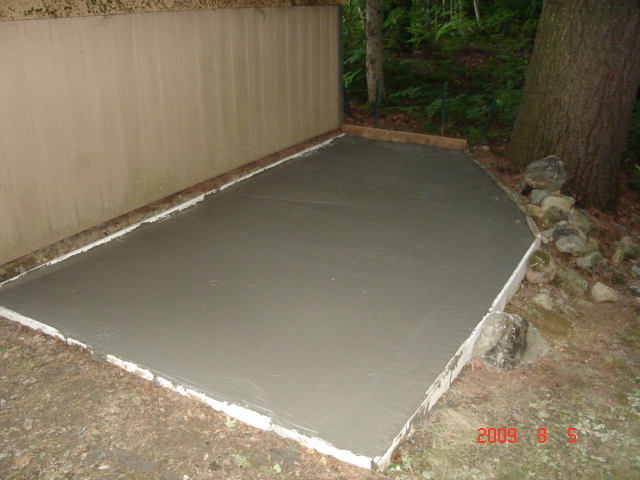

I started the thread "Dumbest thing you have ever done with your tractor" after screwing up the first time I tried to take my loader off. Turns out the whole problem was trying to do it on an uneven dirt floor.
Guess I would say that my best practice advice would be to make sure you have a level area. Made all the difference for me.:licking:

I tried once to remove my loader (Great Bend M20 on a Kubota L2250) but I couldn't get the pins out of the arms. There must be some trick I didn't know about (bought used so no manual) so I just left it on for the last 20 years...gotten used to having it on there, use it more than anything else on the tractor.
Unfortunately at our place the only level flat spot is on the driveway or in the garage. neither one will work for storing a loader so I'm not sure where/how I would do it without pouring a small slab like the guy from Down Under suggested.
Might be trading up in a few days so I won't worry about this one now. but on the next tractor would be nice if I COULD actually remove the FEL easily.
/ Practice Removing Your FEL #99
Johnbro-- sounds like maybe you just didn't hit the right combination of control moves to relieve the weight on the pins....?
A small slab is a wonderful thing!
  • slab-6:25:09-2.JPG
