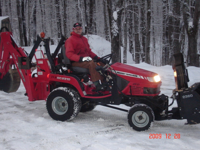

Summer, winter, in-between (like when large trees fall down across driveway & road, like YESTERDAY at 5AM!:laughing:)....
Yes, I get lots of practice taking off & putting on "things"!:D

On my 2310 (M-F), disconnecting the loader is simply unplugging the lines... BUT, the valve does stay on the tractor.
On the backhoe, however, the valve stays with the BH, and a return line has to be re-connected "to avoid serious damage to the hydraulic system...."
Sounds like maybe it is whether the valve stays with the tractor or not is the key, as wvpolekat suggested.
