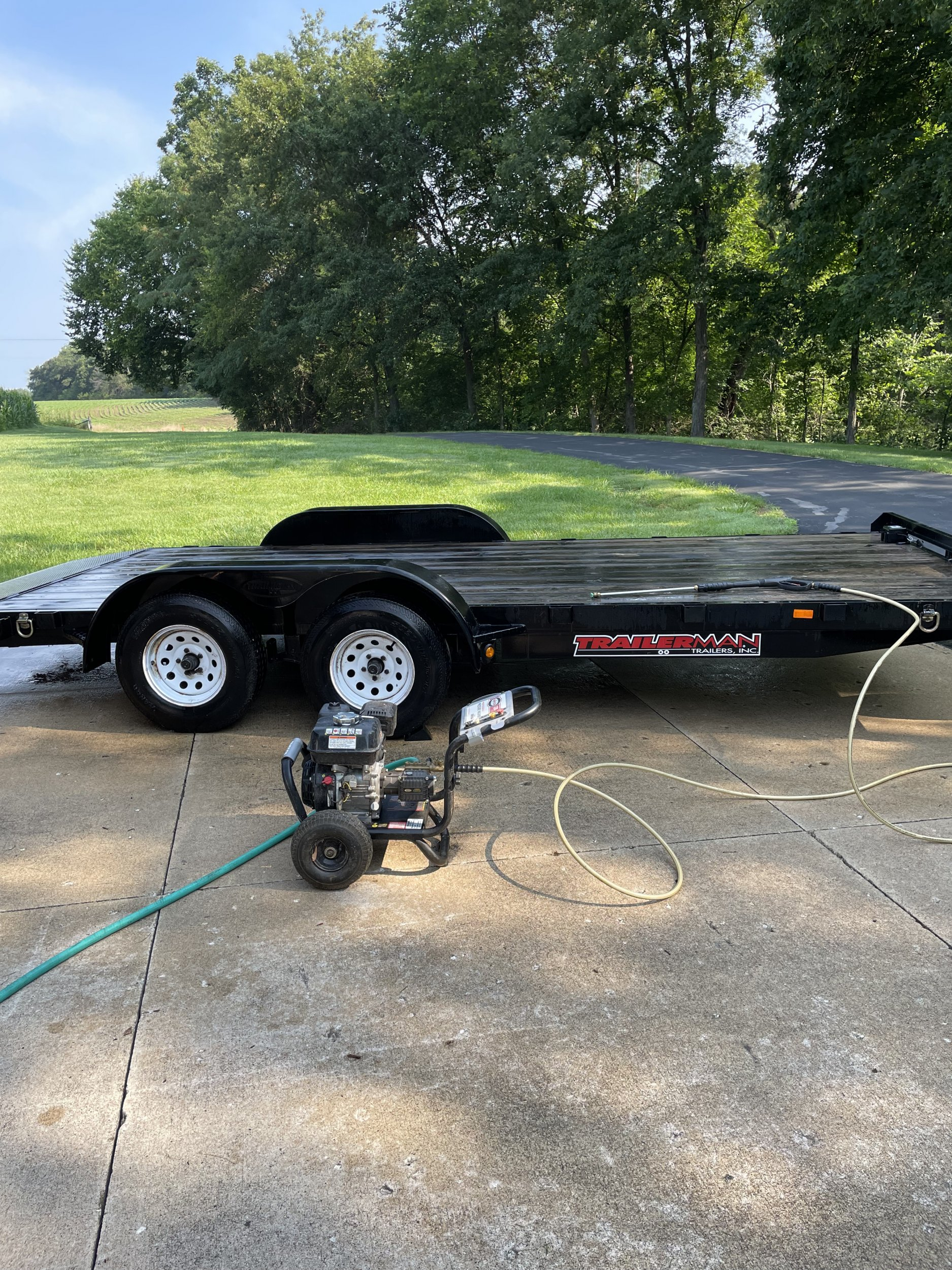

I have an earlier version of this one from Northern Tool: https://www.northerntool.com/shop/tools/product_200788686_200788686. I've had it for over 12 years with zero problems. Whatever you choose, I'd recommend you look for one with a Honda motor and CAT pump. Change out any zinc-coated hose pressure fittings with brass or even better, and not too much more expensive, stainless fittings. Check your engine oil and pump oil (use CAT-branded pump oil in a CAT pump) regularly and shut the fuel flow off and run the motor until it stalls out before winter storage. Fill the pump with RV antifreeze before winter (put intake tube in bottle of antifreeze with ignition off....pull motor start cord repeatedly to initiate pumping function.....keep pulling until antifreeze emerges from pump outlet. I'm not the sharpest knife in the drawer, but this has been a great machine for me and that maintenance routine has worked for me for 12 years. Every Spring, she starts right up.

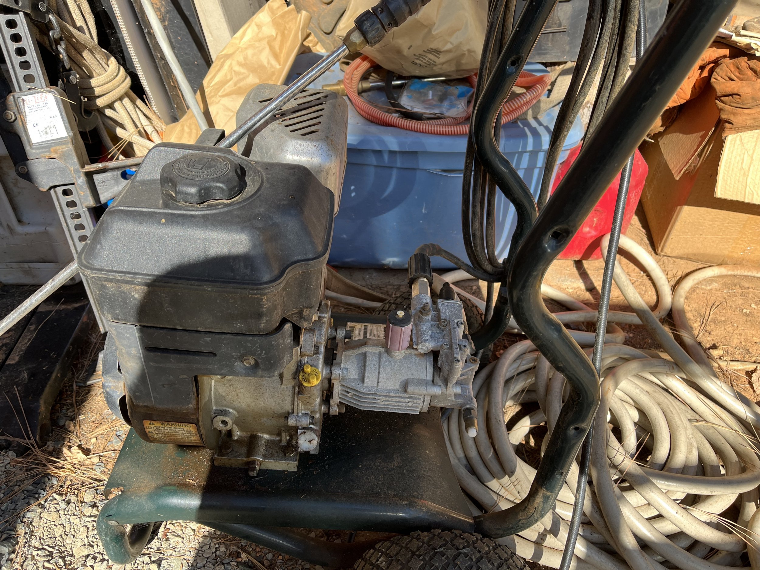

I know that you are looking for a new unit, but I just wanted to say that this old Sears Craftsman pressure washer with a Briggs and Stratton, given to me 10 years ago and at least 10 years old then. Needed the pump head rebuilt when I got it, but parts were easy to find. That alone made it a good thing.

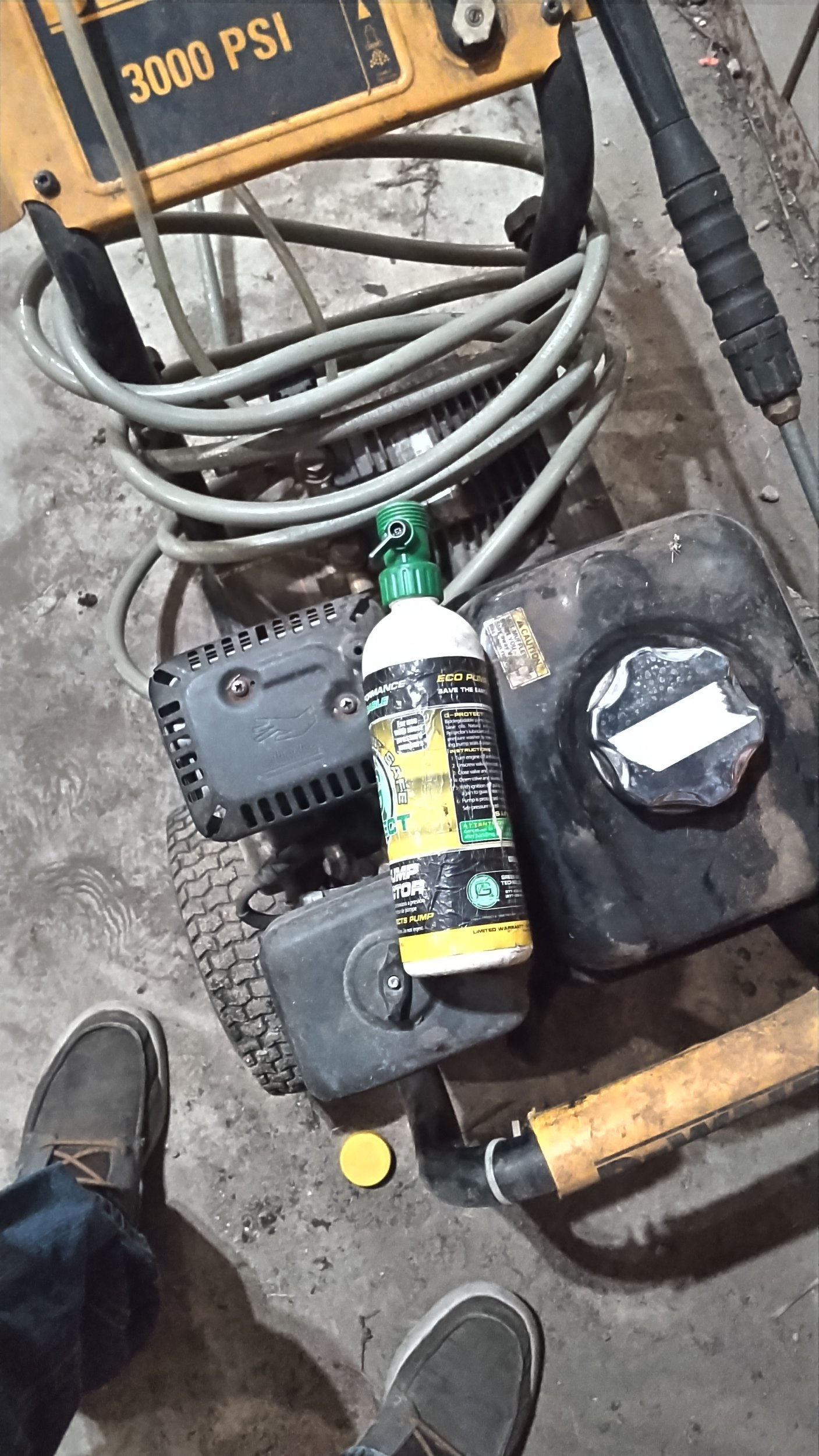

I have a tractor supply cheapie that works fine. I believe the key is non ethanol gas and using one of the generic pump lubes when you're done. I pull the plug, screw the bottle on, and put a spring clamp on it to squeeze it in (because my ripcord is on the other side). Pull it over till the magic juice comes out and put it away. I do this even if I think i'm using it soon because soon has a way of getting far away!
