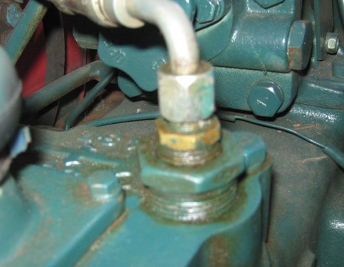

I just got a reply from Hoye - that Dipstick Hole Return Fitting isn't available aside from the entire PS kit. :(
It looks like the only way to run Tank Return into the dipstick hole is to stack some standard hydraulic and plumbing fittings. (Plus a plug with a new longer dipstick). It's not under pressure so this isn't a critical component like the pressurized lines. Back to the drawing board.
I wouldn't be able to make one, but a machine shop could turn you out one to the dimensions using your dip stick and Id of what you plan on doing???

If i were doing this professionally for someone else I would probably do that. But for my own use - if I do this at all, it will likely be just common fittings stacked. Something like Adapter(s)/Nipple/Tee/Plug drilled for longer dipstick. Not elegant, merely functional.

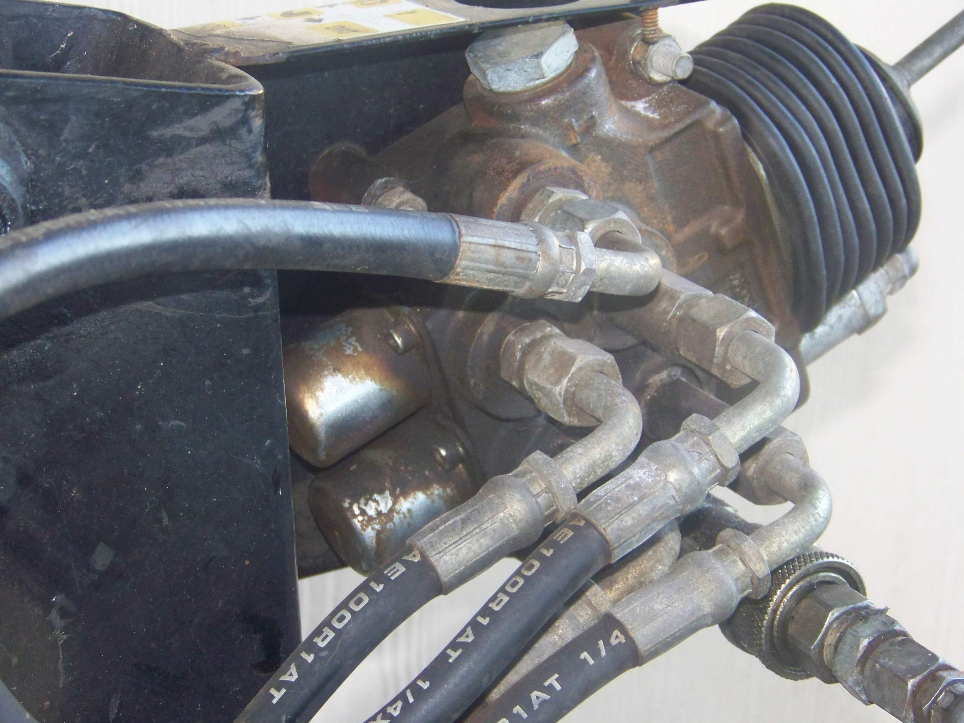

for what it's worth here is a photo of the bib 2 spool control I'm using, there is one port been plug off, not sure what it would be for:cool:
also a pix of the way I currently have the dump line installed into the dipstick hole, after Looking at it again, the bottom part of thread adapter was nothing more than a steel plumbing bushing, it thread right in place with no problems, why could we not use a longer pipe say 2" this same size in diameter have it threaded on both ends, tap into the side of it to install the dump line, Leaving the top to adapt for the use of the dipstick,....

The small pic that JJ posted is like the sleeve in my prince valve I used for my grapple. The larger pic is like the 1 in my loader valve.Looking at Winstons valve, you can't tell which lines he's using for what. Just a guess ,but it looks like he has 2 ports he could use for tank 1 on top & 1 on the side. The plug on the bottom maybe for PB or just another location he could have supplied pressure to the valve

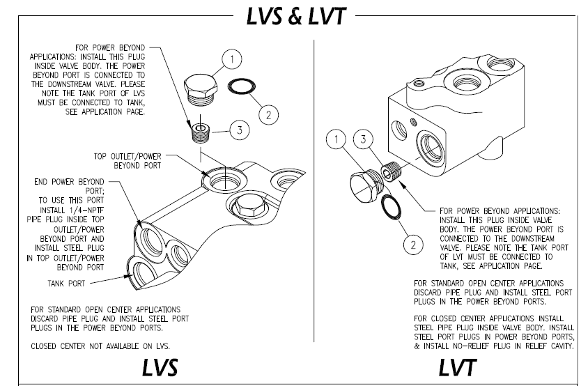

My new LVT valve came with the PB outlet capped and a PB adapter like this packed separately. If this internal plug is installed, it appears to isolate the PB outlet circuit from the Tank outlet circuit inside the valve, routing each to its own opening.
(stock photo)
Added - oops I see JJ already said that. :)
From the LV Valve Manual

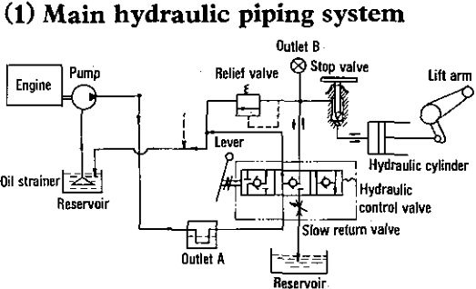

Can anyone make sense of the relief circuit in this OEM shop poster? (copied from an ebay listing. Now I wish I had bought it.)

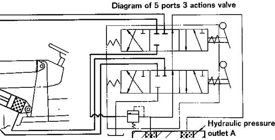

Yanmar Service Manual (Hydraulic Device) Model YM240 has additional information that doesn't appear in the Operation Manual.
"The control valve attached to Port A [Divider Block] should be a 'five ports and three actions' type. When this valve is used, make sure that the Tank port is connected directly to the reservoir."
And the following diagram.
Ok, great. I've never found anything explaining where to 'directly enter the reservoir'.
And a more direct answer to oldnslo's question whether there is a relief ahead of the 3-point control - I still don't know. Maybe somebody can interpret this system diagram. It just gives me a headache.
(Note we are talking about Outlet A, while B is unrelated).
('Outlet A' in both diagrams is the Divider Block shown in the Operation Manual and my photo).

I like that! It didn't occur to me that the threads would be US Pipe size. That simplifies everything.
Checking the fluid level with a separate dipstick a few times a year would be no big deal.
Incidentally this picture and mine above also showing the shifter, illustrate that there is no place to drill a return into the top of the transmission on these models.

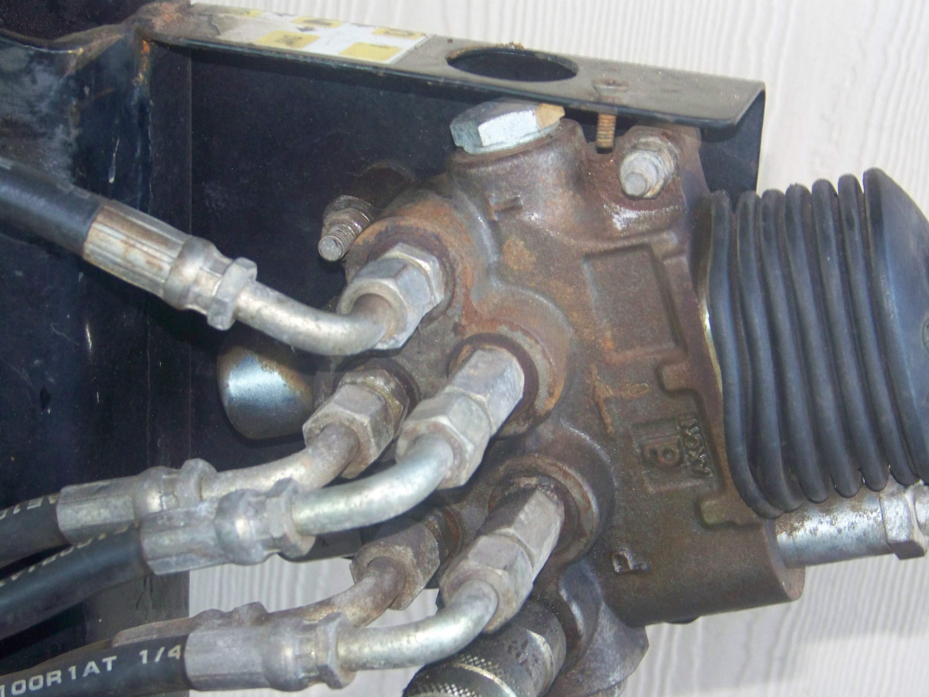

I am attaching some pictures of my "Akon" loader valve on my vn Bulldog loader.:
That is exactly the same one as mine. it has been great to date, without going out to check isnt the top one the tank return, 4 in the middle the cylinders, the lower single one the inlet AND mine has one on the very top which i can see is a plug on yours is the hose that goes to my 3 point which i imagine is my series connection or is it power beyond?

.Just a guess from my end of this computer screen.....The 1 that is in series with your 3 pt is probably like mine was. it's an outlet to tank port.Probably don't have a PB. it probably has 4 hoses that feed the loader 2 outlet to tank ports giving an to use top or side. The plug on the bottom is probably going to be another option for pressure .
