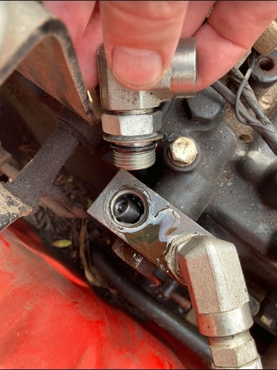

Case closed.
Thanks for all the input guys!

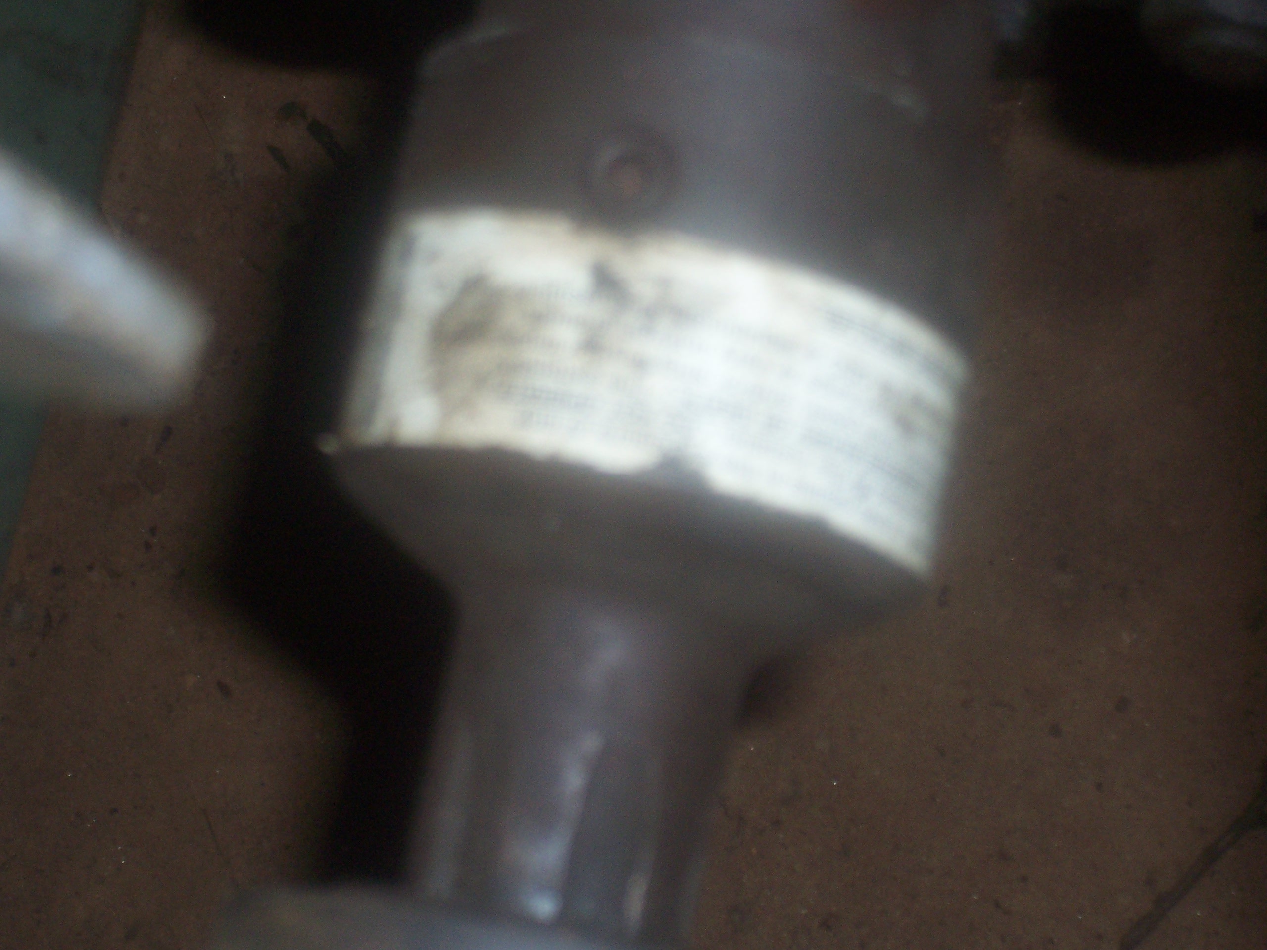

Takes an Allen wrench. Still wondering were that came from. Work it's way through the fittings from the Hyd. Pressure. Here is were I use one to replace a Grease Zerk. Just had this old pic. out of a old overrun clutch.
/ Hydraulic problem.. I'm stumped #26
Plug goes under #23 shown here. Didn't really move much, just came out of threads.
#27
Like Winston said, it just worked its way loose over the years. Never would have thought that would happen when i installed that plug years ago. Well, I torqued it down good this time.

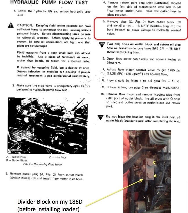

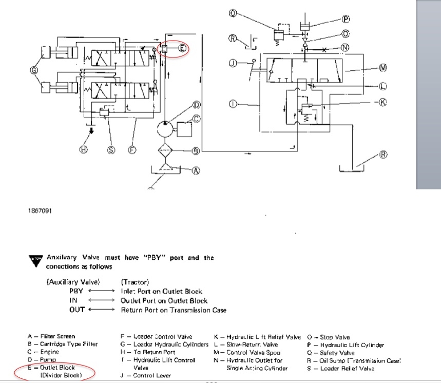

For benefit of others who may read this thread later, here's info on what this plug does:
/ Hydraulic problem.. I'm stumped #28
How did it get inside the line?
/ Hydraulic problem.. I'm stumped #29
The plug is mentioned in the flow test procedure up in post Hydraulic problem.. I'm stumped
The plug is mentioned in the flow test picture (red box). Perhaps what is left unsaid is that the plug needs to be screwed in there for loader functions to work. It would appear that the plug is under pressure in that location, so although it worked loose, it was held in place there by the flow. (Luckily!)
All the best,
Peter
/ Hydraulic problem.. I'm stumped #30
It is not inside the line. It was installed in the divider block, worked it's way loose, but still inside the divider block and allowing flow to go straight to the 3 point.
#31
Epilogue:
I had also been having another annoying issue for months; my attachments on the 3pt hitch were tending to sink down while in use. I'd presumed that it must have been a bad o-ring on the 3pt cylinder (which to my knowledge hadn't ever been replaced since new). So I had bought an o-ring and seals needed to replace that, wasn't looking forward to that job.
But since I re-tightened that allen plug, the sinking problem no longer happens! Makes sense, I guess the fluid must have been leaking past that plug while it was loose but still partly in place, a leak that would cause the 3pt cylinder to sink over course of a few minutes.
So for anybody who has one of these plugs installed: if your 3pt is sinking, check the plug tightness!

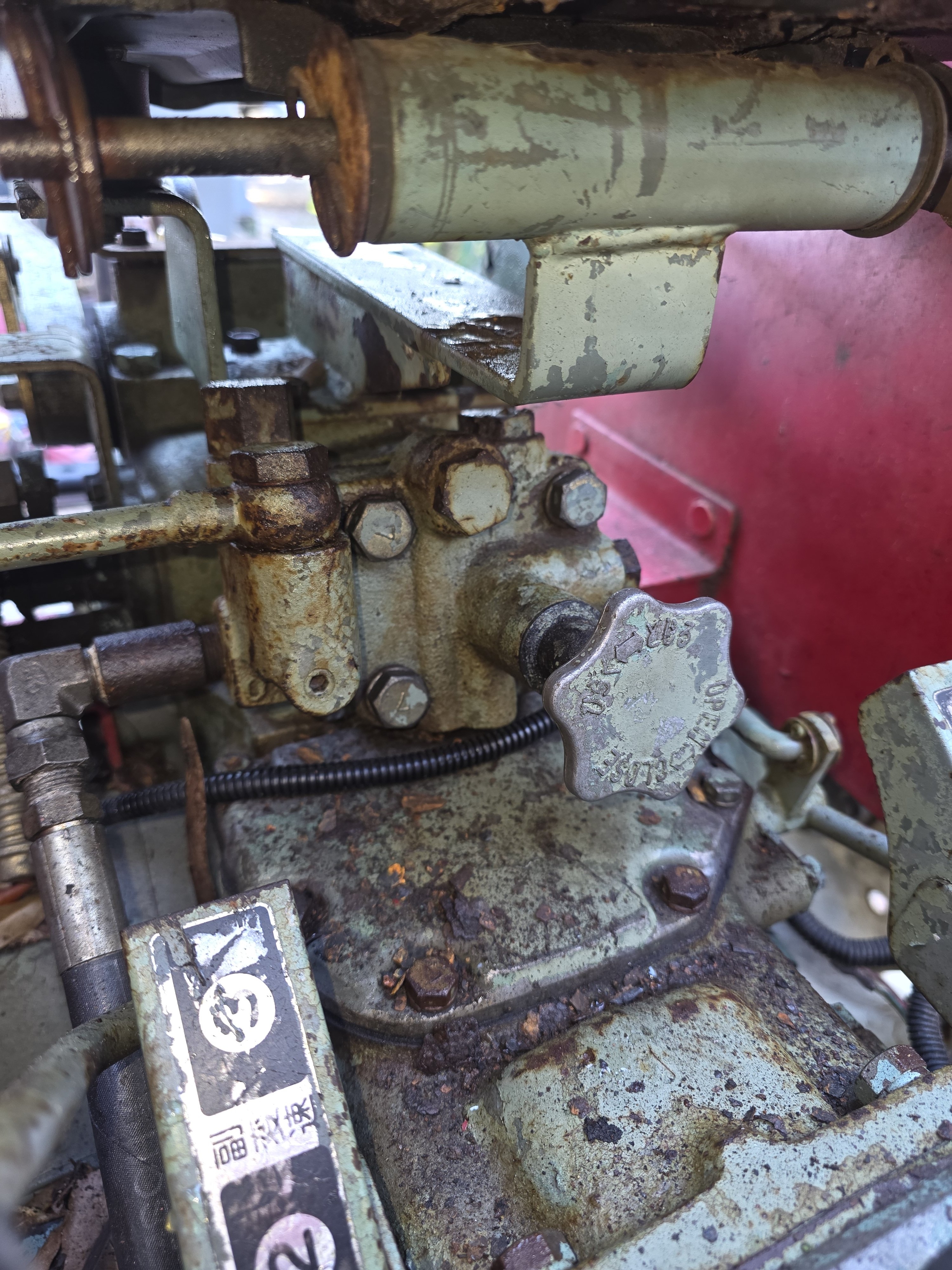

i hate to necro a post, but does anyone have knowledge of if a plug should be used in a 1602 with the loader attachment installed? i have just acquired a 1602, the hydraulics for the loader only work with the valve under the seat fully closed, and the arms lever all the way up. the only way the lift arms work for the back of the tractor work is if you open the valve under the seat and close the supply valve to the loader.
the valve under the seat seems to lock the arms in place so i can set them to a spot where i need them, then open the supply valve to the loader attachment, close the valve under the seat, and then use the loader. i have read that closing the supply to the loader and the valve under the seat at the same time is bad on the pump, so i havent tried that. i want to be able to let my 16 year old learn to use the tractor and implements but with the valves being critical like i suspect they are, i am leery of it. i would love for the rear lift arms and the loader to both work at the same time independently of each other.
any help would be greatly appreciated.
i am trying to translate the parts catalog into english but dont see any reference to that plug. honestly the 1602 has proved difficult to find documentation on. any links to info would be greatly appreciated as well.
thanks, Grum

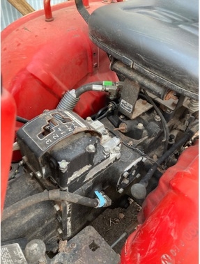

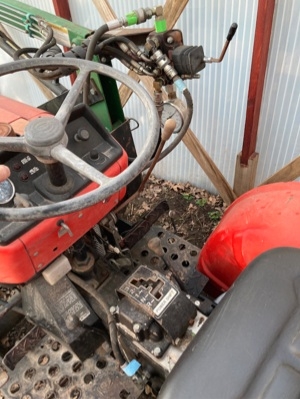

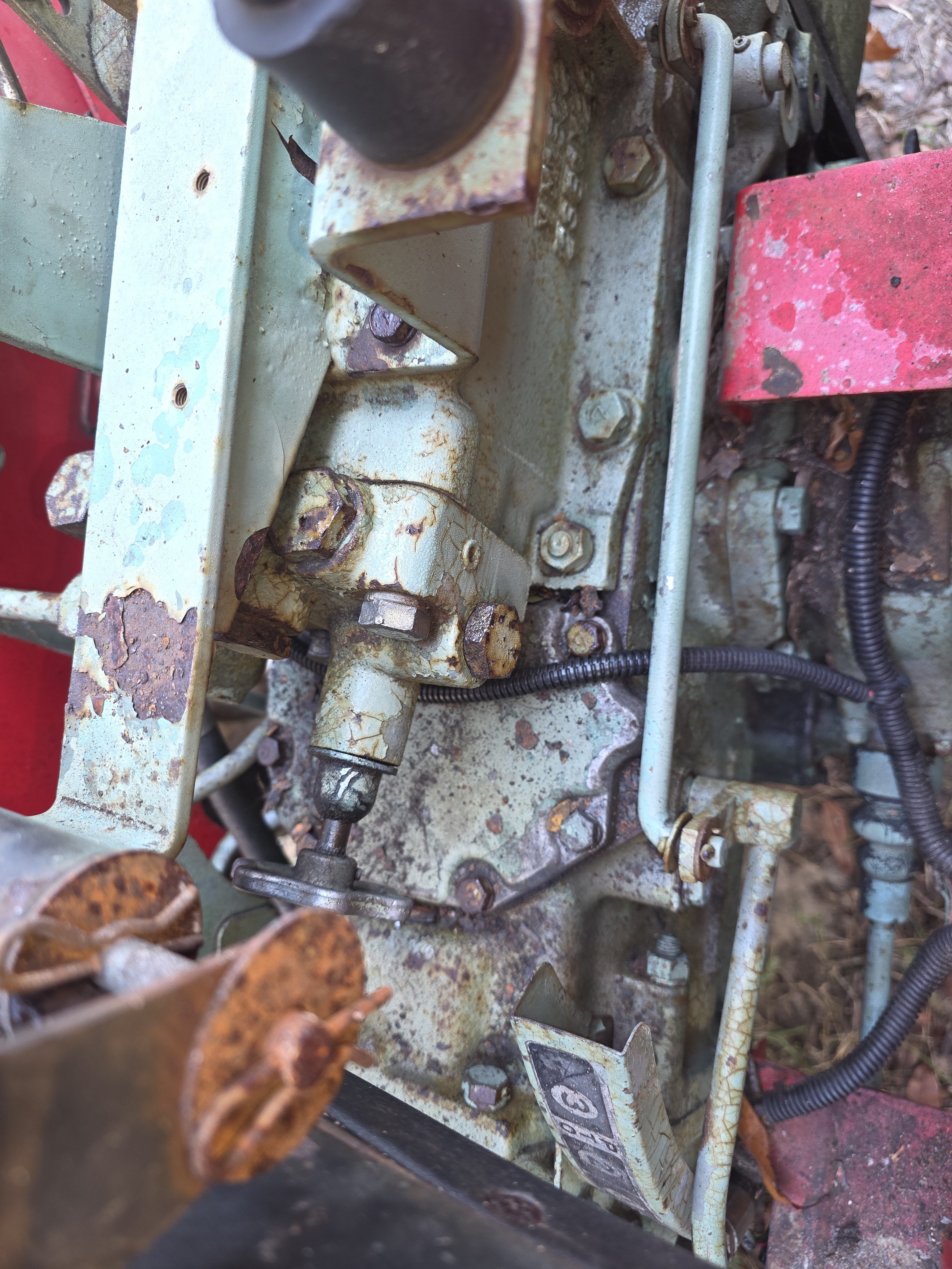

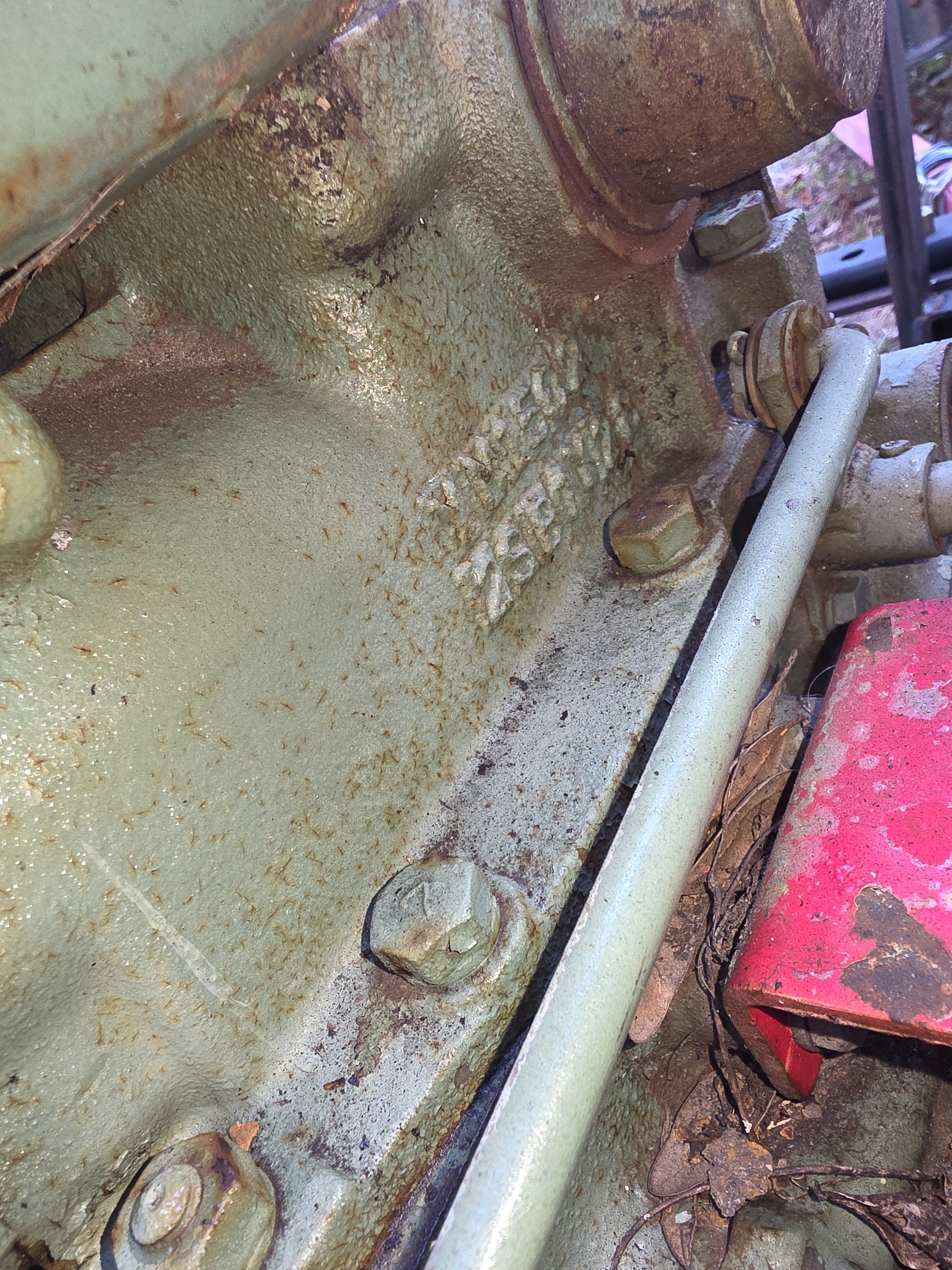

i went and took some pics, and it looks like part of my tractor is a 1502..
/ Hydraulic problem.. I'm stumped #36
it also looks like the loader attachment only has 2 ports.. a pressure and return.
/ Hydraulic problem.. I'm stumped #37
i went and took some pics, and it looks like part of my tractor is a 1502.. View attachment 4439536View attachment 4439537View attachment 4439685
Yours is not quite the same as the1802. I am not aware of a diagram that matches your pictures. I would suggest you do away with your present setup and do it this way.
/ Hydraulic problem.. I'm stumped #38
