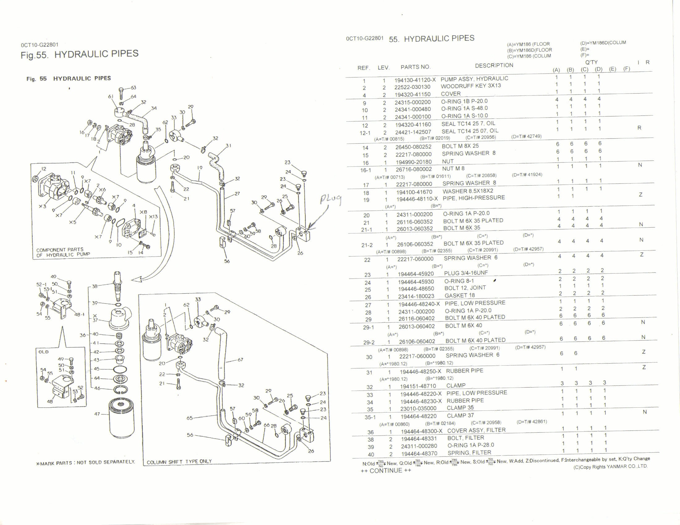

i found this kit for the pump line, Yanmar Tractor Hydraulic Pipe Replacement Kit
i have the banjo fittings, and am probably gonna make the adapter at work and save a few dollars lol...
it is a pretty simple piece, 2 o-ring lands, a center tapped hole, and 2 through holes lol.. i will probably make mine with recessed socket head allen bolts so that positioning the #8 swivel fitting is easier.

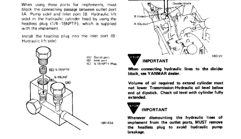

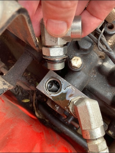

the loader is definitely powered from the "b" port currently which means the stop valve has to be fully closed or the arms fully up for the loader to function, and the loader is utilizing the existing relief valve located in the stop valve assembly.
the photos show current setup. that little screw on the left of the valve closest to the outside is just a stop to control how far the lever can be pushed forward therefore controlling the speed of the dump function of the bucket.
the orange handled ball valve is the one that has to be closed for the rear arms to operate.

looking around, i found the adapter very inexpensive.. Hydraulic Pump Adapter - Pump to Flex House i cant build this cheaper if i factor in my time..
this part along with the hose, and the jic fittings and a 18mm banjo to an6 jic adapter will do what the expensive kit will do, at a fraction of the price..
