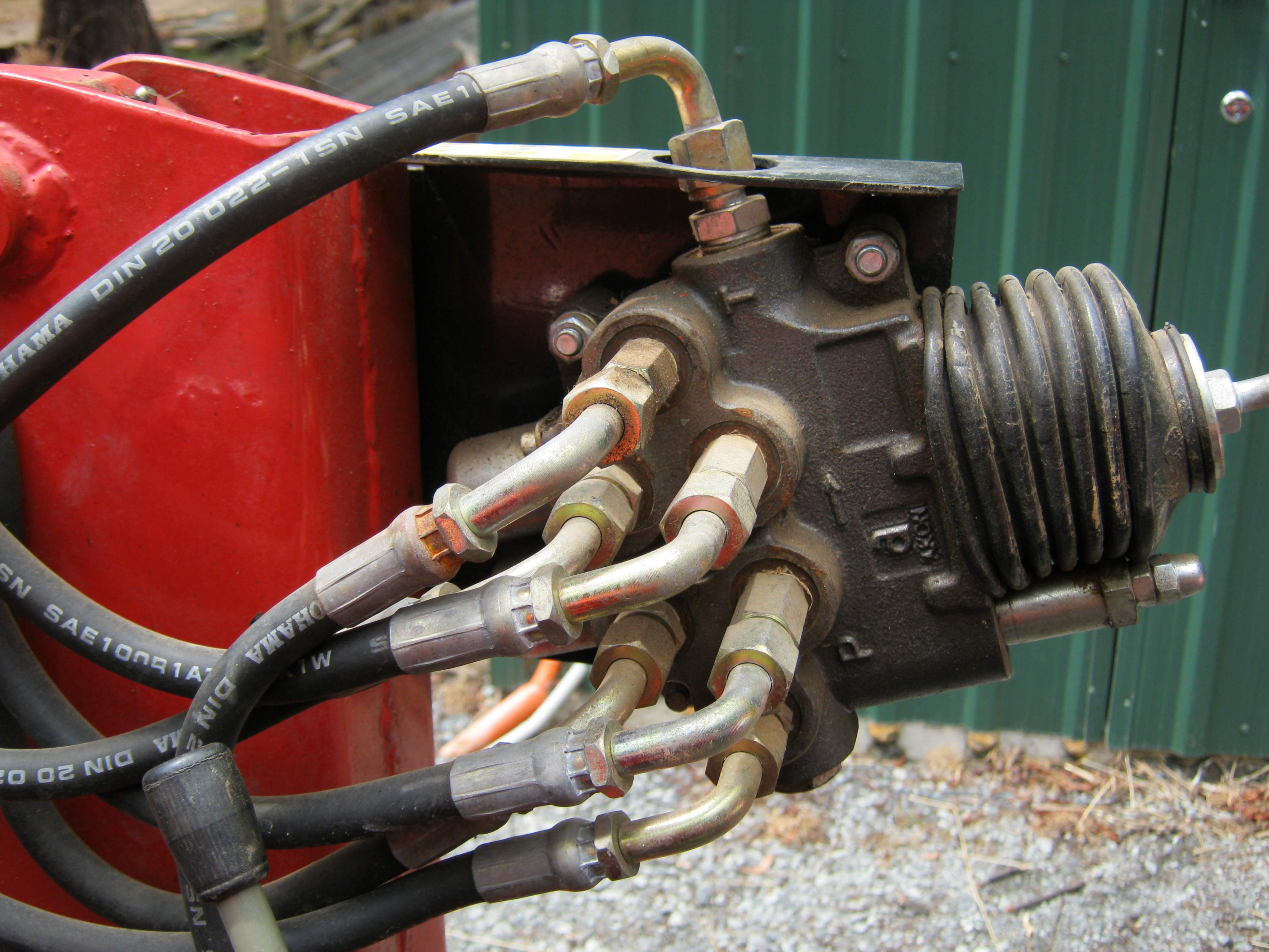

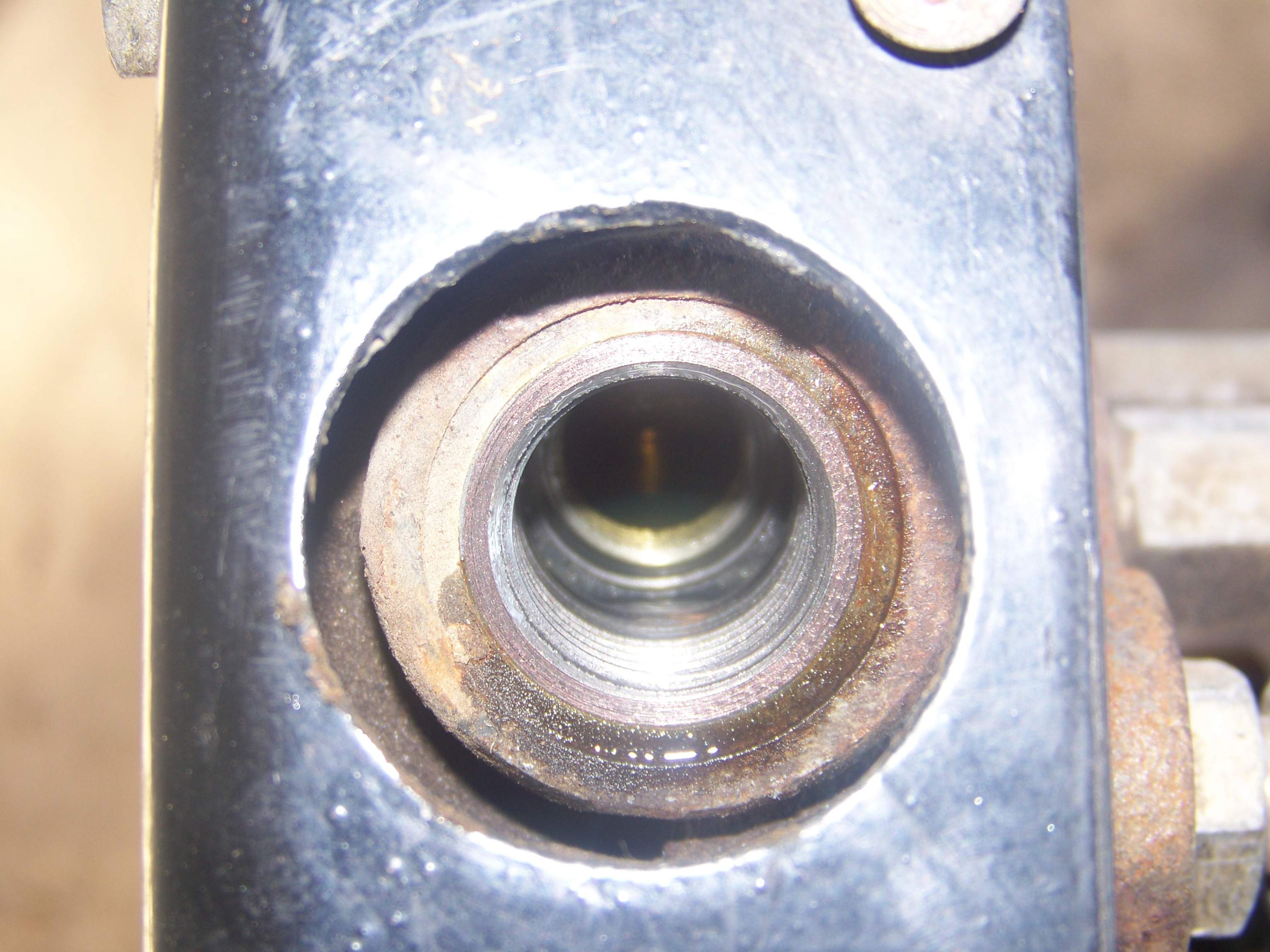

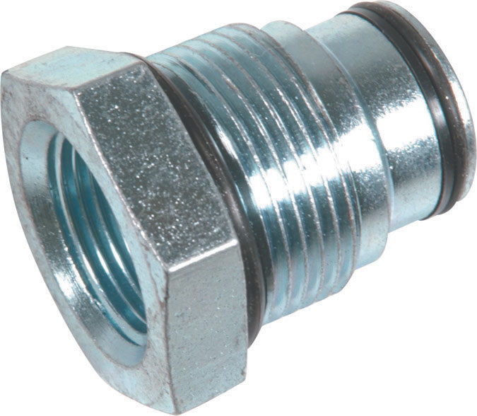

Now on to the power beyond. Two more pictures. The first is looking straight down into the very top unused opening on the valve. It may not be clear enough but there is another set of threads about an inch down in the valve. Guessing that is where the sleeve or plug might go? :confused3: There is an opening in the valve body between those threads and the top gasketed plug.
The second picture is looking straight up into the bottom unused opening. Best I can tell it just shares the same cavity with the bottom inlet line. No idea what it would be used for?

Why not screw a pipe plug with loctit into the top hole, blow air into P port and air well only come out the PB hole only. If that works then use a oring fitting and hook that hose to the 3pt. and the other one to tank. I would say that is why that hole in the bracket is there in the 1st place. Also I would move the valve so it would stay with the tractor when loader was taken off and put QC on the work ports, then you could take off that QC in the pressure line.
   / Power Beyond vs Series for loader valve? #68
Had great hopes with your suggestion and went to try it but my problem is I can't identify the threads down in that hole. They are larger than 1/4" npt and smaller than 3/8" npt. I'm supposing they are a metric thread made for Akon's sleeve. I have sent them an email on their websight but no idea whether they will respond to me.
Got to go for awhile but I may try to identify those threads a little closer after a while. I know they are in the 16mm range.
Back with an update for what it is worth. I believe those inside threads are m16-1.5. Just thinking it is a special fitting that should be there.
Possible these threads are Japanese JIS Tapered pipe? They would be 3/8-19 and approx 16.7 mm OD on the female thread. JIS tapered and BSTP (British Standard Tapered Pipe) are interchangable.
   / Power Beyond vs Series for loader valve? #71
The metric 1.5 thread gauge seems to fit the threads right on. 19tpi would equate to about 1.3 metric. Sure not positive but another thing that makes me think it is a straight thread is because it is a short thread, I would guess about 3/8" long. I'm still holding my breath "Akon" will respond this next week. Maybe Neat 1500 will shed more light for me. :D
   / Power Beyond vs Series for loader valve? #72
M16 x 1.5 is standard size of metric fitting so it could also be that. Normally these types of fittings would have a flat spotface and or a chamfer on them like an american SAE O-ring port.
best of luck on getting the proper fitting and getting your tractor back in operation.

Thanks again for your willingness to shed light. The surface does have a little chamfer or bevel on it. I am in operation but have been convinced I'm just not plumbed correctly. I have had absolutly no problems without the power beyond port but still want to do it correctly if possible without buying a new valve or something.

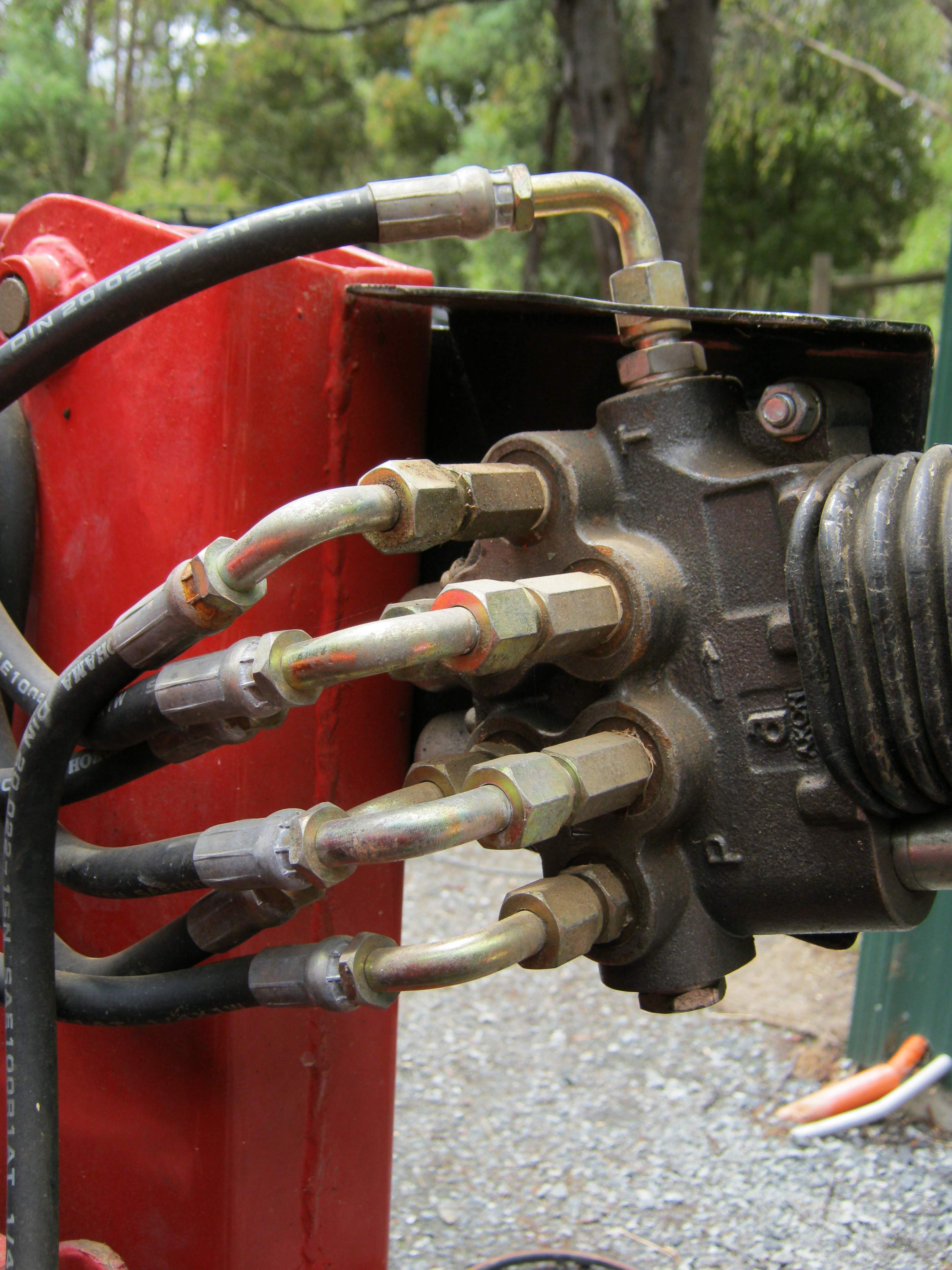

Here are the photos of my tank return and my loader valve.025.jpg026.jpg027.jpg028.jpg029.jpg

Thank you neat 1500 for the pictures. I know what I need to do now. Only thing holding me back is identifying and procuring whatever fitting is in that top plug hole. Hoping "Akon" will respond but dubious.
