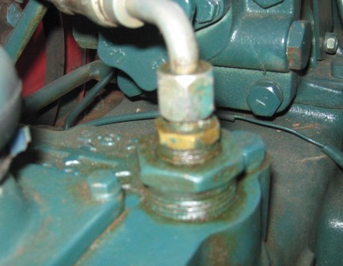

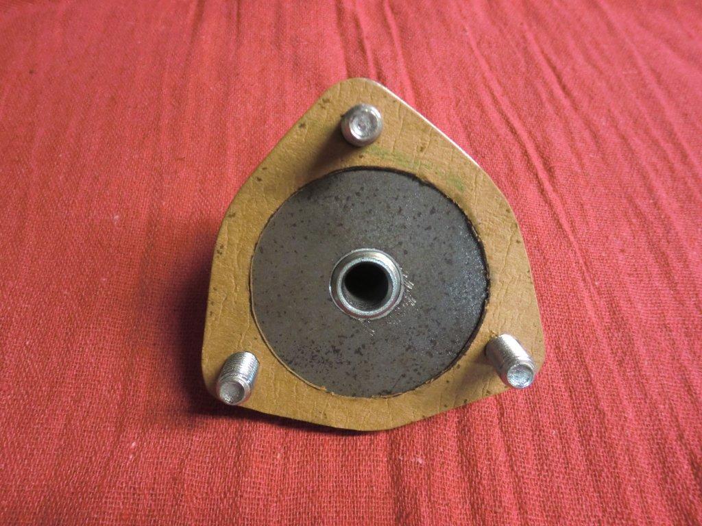

California, here are my plans for the dedicated tank return from the loader control valve (I believe that I may have the same loader valve as you (without running out to the shed to verify) with a very similar mount).
As described in the previous post, I fabricated a new triangular plate to replace an existing cover plate on the right side of the transmission (above the axle/brake housing). This was cut from a piece of scrap 3/8" steel plate using a cutting wheel on a 4 1/2" angle grinder. The center of the plate was drilled and tapped to 3/8" NPT as I plan to install the 3/8" NPT 90-degree elbow as shown in the pictures. My intentions are for the tank return hose to run from the control valve, under the right step and banded to the original hydraulic tubing, to the return fitting in the transmission.
Pictures 1 & 2 - location on the transmission/cover plate to be replaced (there is also another one of these on the left side of the transmision if needed for an alternate return)
Picture 3 - new plate fitted
Picture 4 - new plate next to original cover plate
Pictures 5 through 8 - completed adapter plate
I had thought about drilling and tapping the original cover plate (off of the tractor), but decided not to as it was thin aluminum.
I hope that this may spark some other ideas as it was my intention to have a clean install while also keeping the operating area as clear and neat as possible.

Nice job with nice pictures. Just curious, what is behind that plate? Bound to be there for a reason.

That is a great addition to the thread, showing the proper way to do a tank return. Somebody will find this description useful in the future.
What is behind the plate? Is that simply an opening for some optional component that was not used on this model?
   / Power Beyond vs Series for loader valve? #86
There is nothing behind the cover. I assume that it was for optional equipment or an alternate arrangement. There is a 'shoulder' or round opening that has a diameter about the size of the extended round part of the original cover plate (shown in picture 4 above) and the thickness of the transmission housing. After that, it is open to the upper part of the transmission housing. These two plates on opposite sides of the transmission remind me of those near the bottom that hold the hydraulic screen.

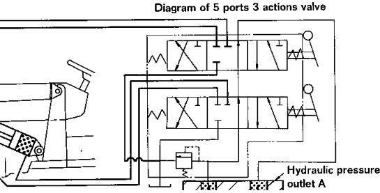

Folks, I have enjoyed reading this thread a lot. I don't know much about hydraulics, but I enjoy listening to those who do. If I can go back to this comment on page 1:
Brian the stacking, doubling, of pressure makes sense. But I think it also means that the doubling can be avoided by never having the 3-point under pressure in its Lift position while using the loader valve.
It seems to me that if one had, for example, a ballast box, or a box blade that rode on the three-point even when it was not being used, then one would regularly be using the loader while the 3-point was under pressure in its lift position. But folks on the thread are talking as if that's an unusual situation. In the interest of my own education, am I missing something, and if so, what? Perhaps it's this: that "under pressure" refers only to actually moving the 3-point up, not just resting it in the up position?

Yes, exactly. The lift handle routes fluid to the hydraulic lift cylinder in Lift position, but after that you move the lever forward slightly to Hold position This seals the passage so fluid can't escape back out of the hydraulic cylinder, and the lift stays up.
At the same time, when the handle is in Hold or Drop position, the full output of the pump goes right through that 3-point control (no back pressure) and drains back to the transmission sump.

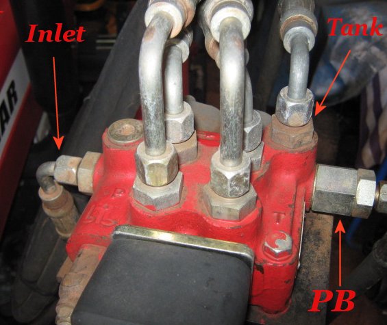

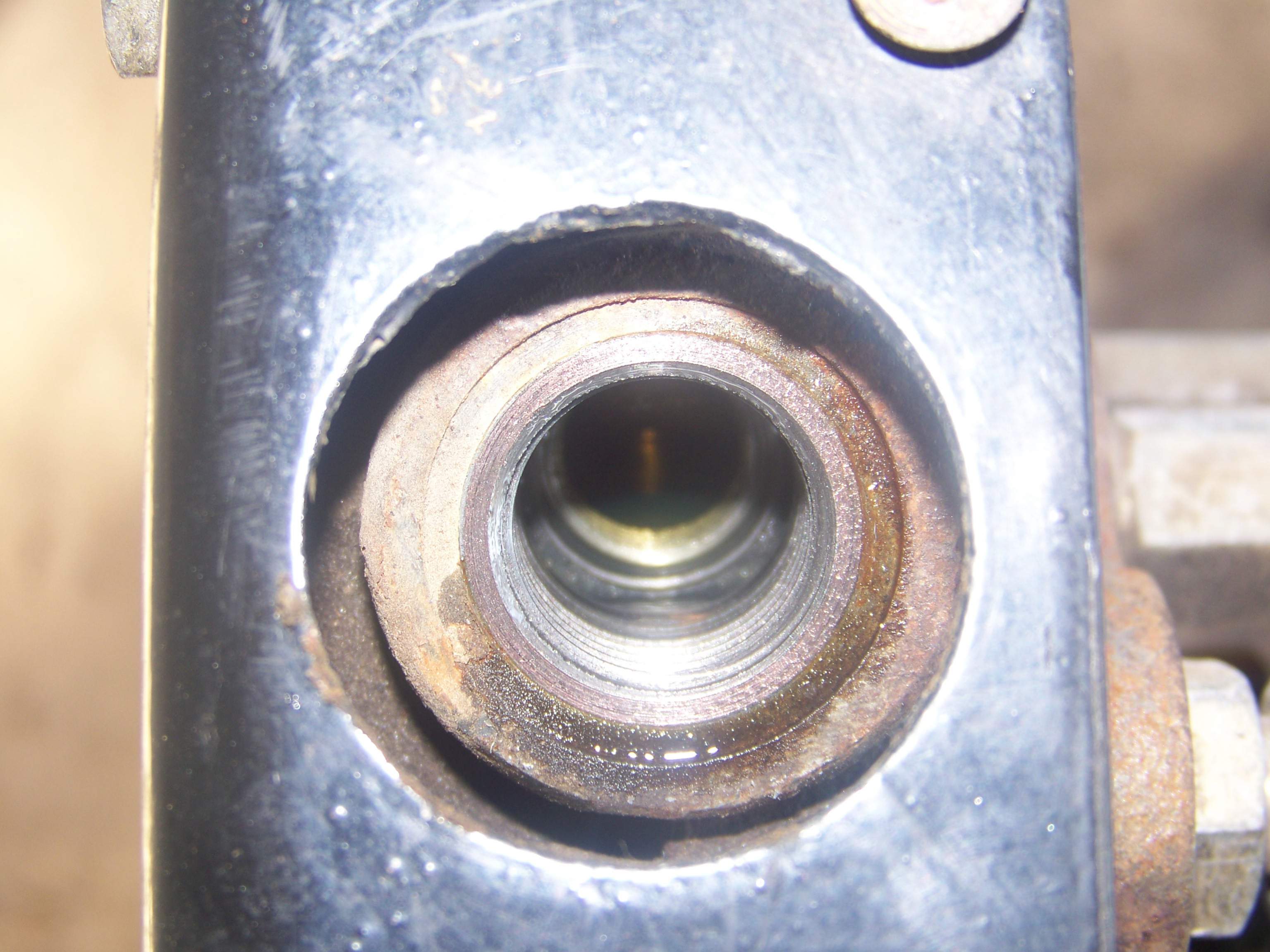

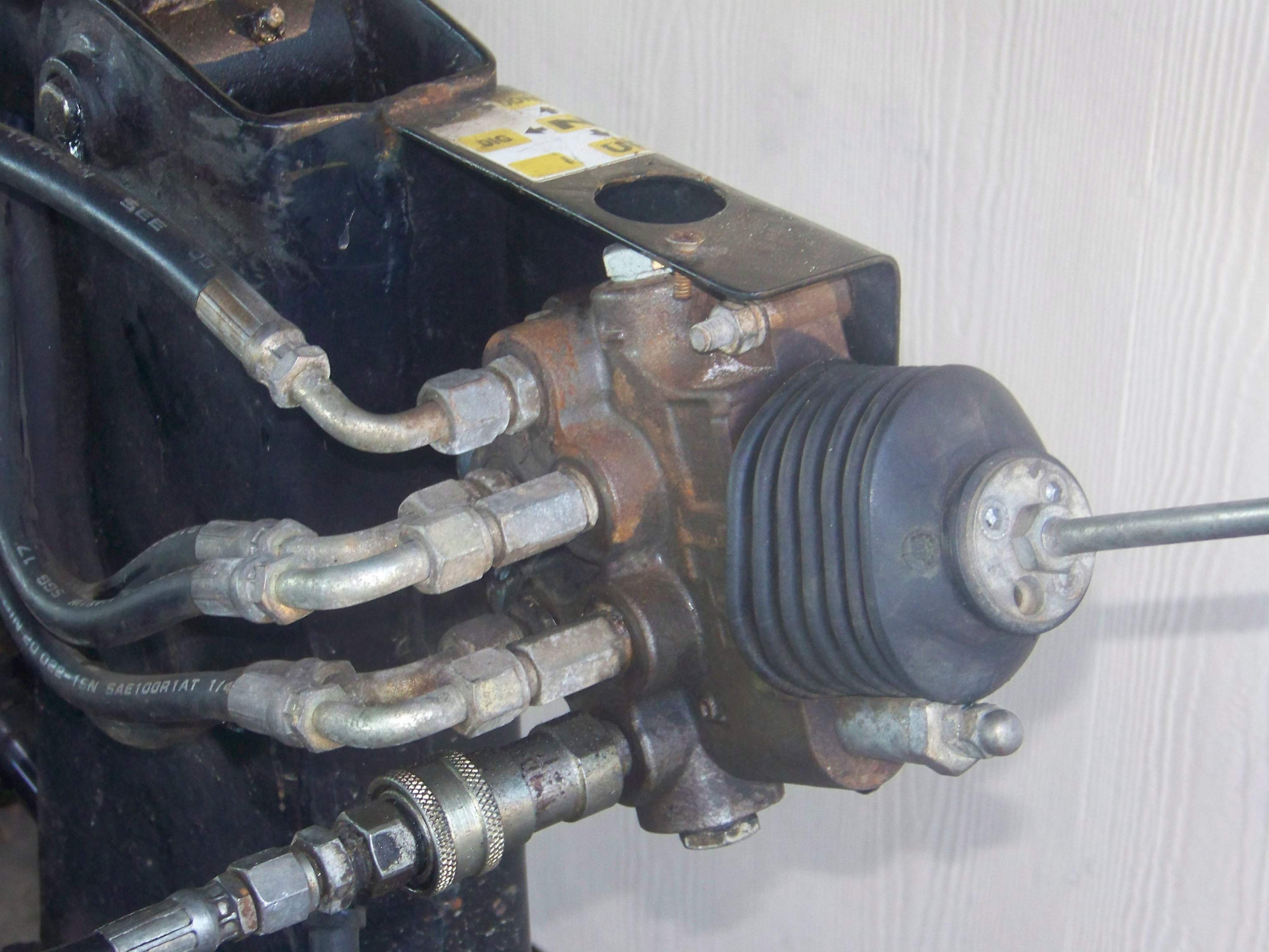

No response to my email to Akon. OK, guru's, based on my pictures and description of my valve, is there any way for you to know if a plug in that top inner opening could convert me to power beyond. I think I am crafty enough to come up with a plug if that could be the answer. Or is there some testing or something I could do to give a better handle on how my valve works?
Possibly something like this. I could cut a slot in the hex part for a screwdriver? http://www.ebay.com/itm/2-M16-1-5-x...408&pid=100011&prg=1005&rk=1&sd=400169542285&
Also plugs available with alan heads but I really think I need a gasket surface.

Companies Like Parker Hannifan, Zero-Leak, Eaton-Aeroquip, etc all make metric plugs. Do you have a Parker store or another hydraulic shop that carries fittings in your area?

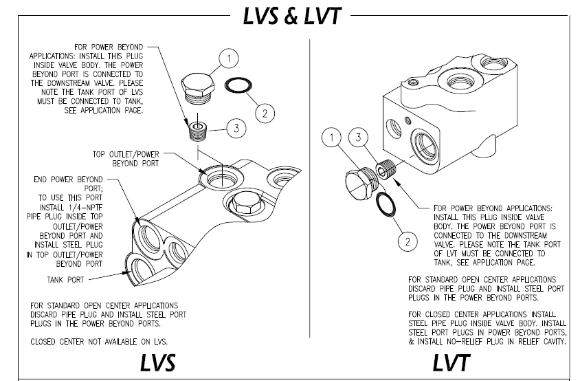

Take a look back at posts # 39 and 40. I posted a picture of the plug that came with my new valve but I think it's more likely you need one like JJ's second picture where the plug has an upper and lower shoulder, each with an o-ring.
The theory of operation here is that the return, drain, from the descending cylinders is normally combined inside the valve with the PB fluid that went straight across the valve. Then this new plug separates the two flows so pump pressure goes out the PB and minor pressure from the cylinders dropping goes out the Tank exit.
If you can see some way to isolate the two flows you've solved the problem. (Plus plumbing from Tank outlet to transmission return hole.)

Since it threaded I would say yes. It would be kind of difficult to have a fitting with two different thread sizes line up perfectly so that they would screw together. Without having the valve in my hand I can not gaurantee this 100% though.
Can you tell where the tank port and PB port connect in the valve body compared to where this internal plug would go. It should isolate those two flow paths while allowing the pressure port to flow to the PB port. That is how the Prince LVT valves are made.
