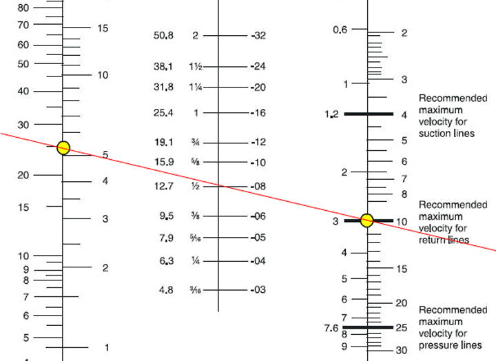

3/8 in ID hose will handle 5 GPM.
Interactive Nomogram for Sizing Hydraulic Hoses
Grab the yellow dot and pull it to the 5 GPM mark, and you will see that the 3/8 in hose would be sufficient .
The 5 GPM mark is Imperial gallons. Multiply by 1.2 to convert to U.S. Gallons = 6 gallons
A 3/8" line is still adequate for the pressure lines. (Although personally, I would use a 1/2" line for the inlet to the valve.)
At the recommended maximum velocity for return lines the nomogram indicates about a 9/16ths ID hose.
However, since the pump on California's tractor puts out about 4.5 GPM, a 1/2 inch line for the return would probably be adequate.
Remember this is calculated from the maximum velocity for return lines.
Note: Yanmar had an optional pump available that put out about 5.8 GPM.
/ Power Beyond vs Series for loader valve? #33
A 3/8" line is still adequate for the pressure lines. (Although personally, I would use a 1/2" line for the inlet to the pump.)
Incidentally, Yanmar employs a 22mm (19mm ID) steel hydraulic tubing return line on tractors (with John Deere tin) that put out 4.5 GPM.
19mm ID equates to .7467 inch, pretty darn close to 3/4".
So Kenmac's problem being solved when increasing his return line to 3/4" would seem to be consistent with Yanmar engineering.
