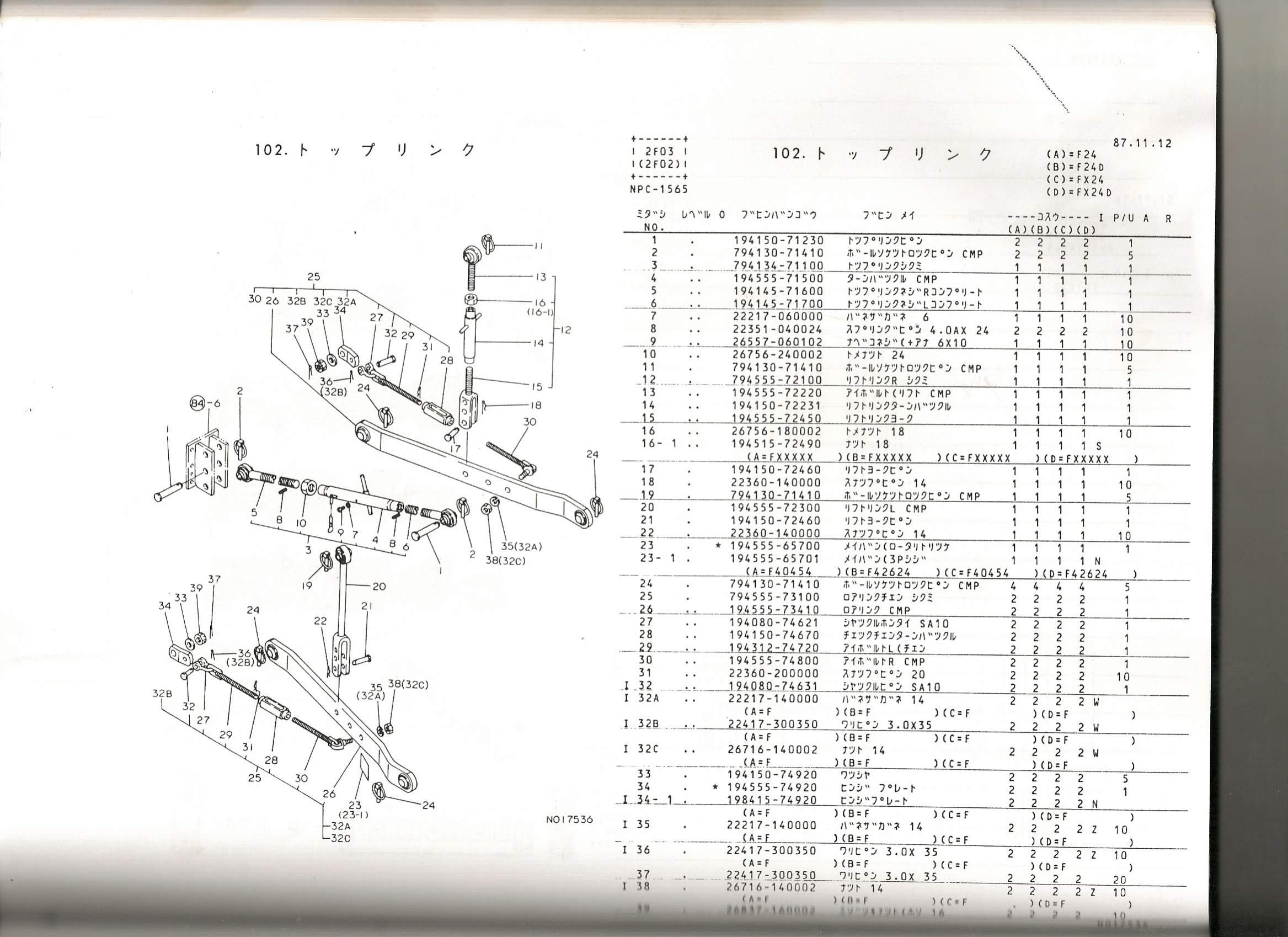

check this picture: Yanmar Tractor Parts: THREE POINT AND PTO
You will see the chains you need to pull the arms towards the tires. When you don't have any attachments on the arms just use a bungy cord to keep them pulled in.
/ Possible 3ph problem #3
Here is a scan out of an F24/FX24 manual showing the 3 point set up. Not knowing whether the F14/FX14 would be the same or not.
Hoye also shows this listed under the F14/FX14 (D) tractor? Yanmar Tractor Parts: LOWER LINK ASSEMBLY

Dang, was just going to post that. someone has jury-rigged the 3ph system.
Thanks for your help. When you say it's jury-rigged, what exactly is wrong? Is it the lower link assembly?
Mine looks different to the one picture above, in that the rod that the link arms mount onto seems to allow a lot of lateral movement of the arms. What I mean is that they can slide a long way left and right. I take it that the arms should be constrained closer to the centre line that the outside? If thats the case I could drill the rod and put pins in.
I'm still not at all sure where the stabiliser chains would affix at the tractor end though. Can anyone help with that?

Sorta what you need. However, I can't tell enough about the home made lower link assembly to know whether it is solidly anchored and strong enough. Also, you will need a place to fasten the linkage stabilisers. Your pins stick way out to far for my liking.
That stabiliser I linked to, I think, is designed to fit onto the ends of the very long lower pins. I don't think the lower link is home made, there are a few small tractors for sale on Ebay UK that have a similar lower link. See what you think of this one... Compact Tractor Yanmar | eBay
Mine isn't identical to that, so I'll take a clearer photo and post it shortly.

Bluest, I see you are in UK so the Hoye kit might be expensive. But I think you need that kit or whatever you can find locally designed equally strong. My first YM186D (similar hp to your F14D) has been repaired at that point. There are welds re-attaching the lowest part which holds the cross-rod, to a vertical plate that covers most of lower back of the transmission.This vertical plate is also anchored to the towbar receptacle below the axle to share some of the stresses. This assembly that ripped apart from the vertical plate would have been far stronger than those two ears holding your cross-rod - and it got torn off regardless.
[edit - later - see post #14 below].
I suggest study what Yanmar intended at that location and locate the real Yanmar parts, or at least the equivalent of the Hoye kit. I don't think the tractor is complete and ready for hard work as it exists presently.
And Welcome!
/ Possible 3ph problem #14
Here's a photo of the 3-point attachment on my first YM186D.
There is a tube that the horizontal rod goes through. Repair welds re-attached this tube to a bracket on the back of the transmission.
The stress of pulling an implement is applied to 'ears' near the ends of the horizontal rod. These 'ears' go forward and are bolted to the sides of the transmission. I surmise these bolts fell out at one time causing the damage repaired by the welds.
I think you need to buy the Hoye component that Winston referenced in Post #3. (or similar that fits your model).
I'll repeat the Hoye photo below my photo. On this version the horizontal tube appears to be part of the drawbar socket assembly under the transmission. Like my version, it has 'ears' near the end of the rod which transfer implement-pull stress to the sides of the transmission.
