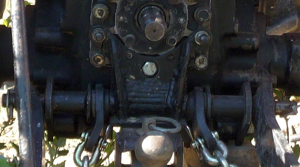

Ok, a bit of progress with amateur-made lower link assembly...
I had a very brief welding lesson on Wednesday night, my Dad then promptly left me with his old arc welder and said "it's all down to practise, I'll leave it with you"!
Now, this is absolutely the first time I've been near a welder, with the exception of my one hour lesson from Dad and watching videos on YouTube. The welds are lumpy, and unsightly but they appear strong enough. The ones on the right I did first and are the worst. Ill grind those back and have another go. I ran outof time tonight. I did managed to incorporate some lugs to bolt up to the back of the gearbox as suggested by you good folks.

I do think the bar or lugs will fail before the bolts holding it on the tractor so you ought to be good to go. :thumbsup:
/ Possible 3ph problem #25
On the welds that are lumped up, Try a little more heat . That should flatten out your weld bead
#26
Looks good. I think the tabs greatly reduce stress on those bolts you had to repair underneath.
Thanks, the lugs were a good idea, I appreciate the suggestion.
I've ordered my stabiliser chains today, so they should arrive early next week. I can then take it out for test on Wednesday if the weather is good..

A quick update, the finished item with a coat of paint.
Just waiting for my stabiliser chains to come in the post, then I can go for a test mow.

Bit of progress today. Got the whole of the linkage back together with the new stabilisers. I couldn't get the stabilisers to tension on the outside of the arms, so I'm going to try them on the inside. Not sure if it'll work but it's worth trying. Hopefully, no mower mower/tyre interference...
Won't be able to test for a few days as I'm waiting for a fan belt for the engine.

Thanks for the positive comments. It all still in one piece and straight so I'm happy. The only thing I'm not 100% with are the stabiliser links. They are awkward and time consuming to alter which makes changing the attachment a chore. Moving them to the outside of the arms would make life easier but then they wont adjust short enough to take up the slack. Need to have a think.
Where you used bolts at the forward end of the stabilizers, I have pins secured by hairpin clips. Here's the photo I included in post#14 above. It's not too much nuisance to loosen the stabilizers a couple of turns then pull one of the pins temporarily to hook up.

Thanks again California. A fresh pair of eyes can usually spot an simple solution. I've a bag of those clips in the drawer so I'll make the change over the weekend.

Done as you suggested California. Much easier to get the mower on and off now. Bit of a quick fix asI just drilled the bolts to take clips rather than replacing with pins. Well worth 30mins in the garage this morning though.
You might see from the second photo that I spaced the lower arms out a little as the seemed to get into some weird angles sometimes.
