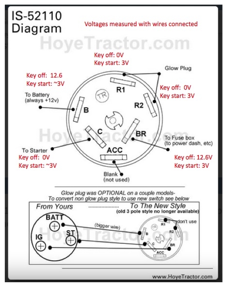

My 186D has for some years had this thing where when I turn the key sometimes I'll just hear the solenoid click but the starter doesn't engage, but if I try the key again 1-3 times it would always eventually engage the starter and the engine would start. Kind of an annoyance but it would always start after a few tries so I didn't track down the problem. A couple years ago I had the feeling it might've been dirty contacts or something in the ignition switch so I took that off and cleaned it all up, no change.
But since yesterday, it has gone to a new level of problem; basically the solenoid doesn't even click, just nothing. I cleaned the battery terminals thoroughly and greased them, and tightened well, but no improvement. Battery voltage is 12.7.
So first I tested voltage at the "trigger wire" on the solenoid. I expected ~12V when key is turned to "start", but it only showed around 3.6V. If I held the key in the start position, voltage would climb gradually over 10 seconds or so, but would only reach about 5.1 volts. So if i'm assuming correctly that the solenoid wire should be supplying 12V looks like this might be the issue (insufficient voltage to trigger the solenoid).
But from this point I'm not clear on why there would be this low voltage. I have some info from a service manual on testing the solenoid, but looks to me like the problem might be upstream of the solenoid.

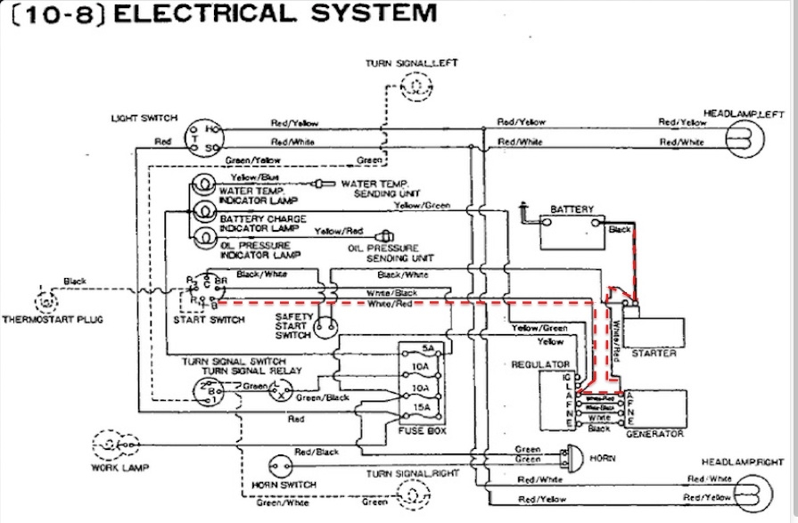

Found an electrical diagram here: yanmar ym186D \\ circuit diagram
and from what I can see it looks like there should be nothing between (12V) power from the ignition switch and the solenoid except the "safety switch" (which has long been defeated/bridged on my tractor).
So I'm left thinking that it must be a dirty connection somewhere between the ignition switch and the solenoid, though it seems odd that there would be a much reduced voltage (3.6-5V) but consistent.
Am I missing something? Any suggestions?

Dirty internal contacts seems very plausible.
I just cleaned all the external terminals and each wire ring connector with steel wool till they're bright metal. Put wires back on, and here's what I got (photo--
voltages shown in red)
3-4V makes no sense, unless something inside is not making good contact or something to that effect..
I'll hunt up some contact cleaner/deox-it and give it a try.
Thanks

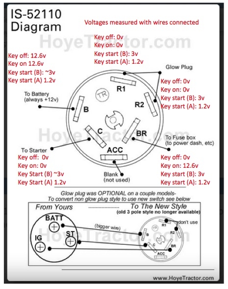

Well I got a can of CRC and did the spraying into ignition switch, working the key back and forth, blowing out the CRC. Repeated this process 4-5 times. At first, the solvent coming out on my glove was pretty dirty.
However after this cleaning, problem persists. In fact (strangely), the only change that happened was that the voltages at several of the terminals actually went DOWN from what it was before the cleaning. Before (B), they read ~3v, but After cleaning (A), they only read about 1.2v now. This is only when the key is held in the start (momentary) position. This picture summarizes:
So it appears that while terminal B always has 12.6v (as it should) and terminal BR has 12.6v when key is turned to "on", both of these terminals drop to 1.2v when the key is on start. Then they return to 12.6v when i release it.

Yeah, this drop in voltage from 12v-->1.2 when I turn the key to start (i.e. create a kind of load) *even measured at terminal B ("battery") makes me think possibly the problem is not in the switch at all, but maybe something upstream.
According to this diagram (if I understand it correctly), the power to "B" on the ignition switch comes not directly from the battery (as you would think), but appears like it comes through the voltage regulator first. (See the dashed red line):
If so, perhaps the voltage regulator is faulty, not allowing enough voltage/current to flow?
Note: I did have to replace the voltage regulator some years ago.. maybe the replacement has also gone bad?

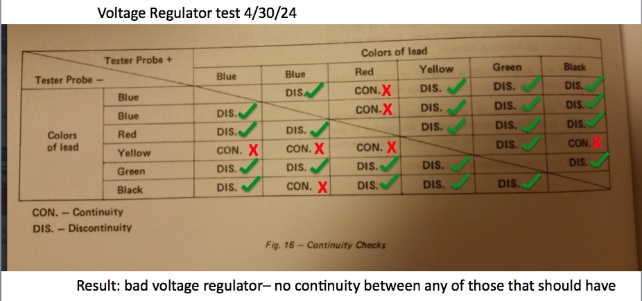

So I tested the VR. Result: VR fails.
So looks like I'll have to order another one.

Received the new voltage regulator.
Before installing, I did the above continuity tests on it.
Result: The brand new regulator also had no continuity between any of the wire combinations that were supposed to have continuity according to the above chart. Plugged it in on the tractor and tried the starter.. same problem as before.
So what to conclude?
-The new one is faulty?
-The continuity chart is perhaps not applicable to "modern" voltage regulators (if they have a different design or something)?
-The starting problem was never the voltage regulator but is something else?
On the VR testing though, the new (and older) VRs i bought are stated in the sales listing to be for my YM186, and the plug and wire colors match the old one (and also match the wire colors in the test chart above) exactly.
Running out of ideas, I checked the battery ground wire again, looked OK, re-greased and tightened both ends. Still no joy.
Running out of ideas, I noticed the 6-wire multi-pin connector plug for the voltage regulator looked a bit dirty, so cleaned it out with the CRC spray. BINGO. Started right up. And that was with my old VR installed (so it wasn't bad after all).
Still don't understand the VR continuity test results, but perhaps modern replacement VRs have a different kind of circuitry than the originals that the troubleshooting continuity test was designed for.
