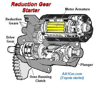

The OSGR is a Denso design. Denso = Toyoda
