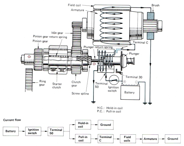

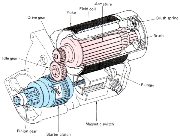

  • Tech_Electrical_Starter Motor_Reduction Type - Rollaclub.pdf

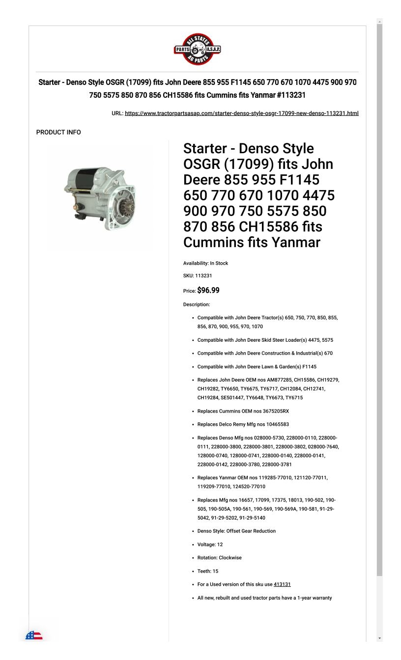

Check your YM2310 p/n to the ones listed in this snip. Price at the time was really good.
