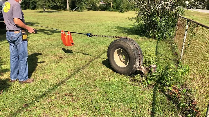

You can also use the Wheel Method. I have a semi truck wheel with no tire on it I use. Wrap the chain around the tree and route it over the wheel to the tractor and drive away. Converts all your linear pull into lift.
Suggestion: Go slow. It doesn't take much to pull a plant vertically. Slow is safe.

Some good ideas in here. Like I said, there are a dozen or more of these to do and one afternoon to do them in, so I don't need to go fast, but I can't go slow either. Most of them are probably 3x3 feet in size due to persistent trimming and they've been in the ground for many years so I'm sure the roots are firm. The tire idea I've seen in action but I think that would take a few minutes to set up correctly per bush. I may look into those grubbers and pipe cincher ideas. Interesting...
