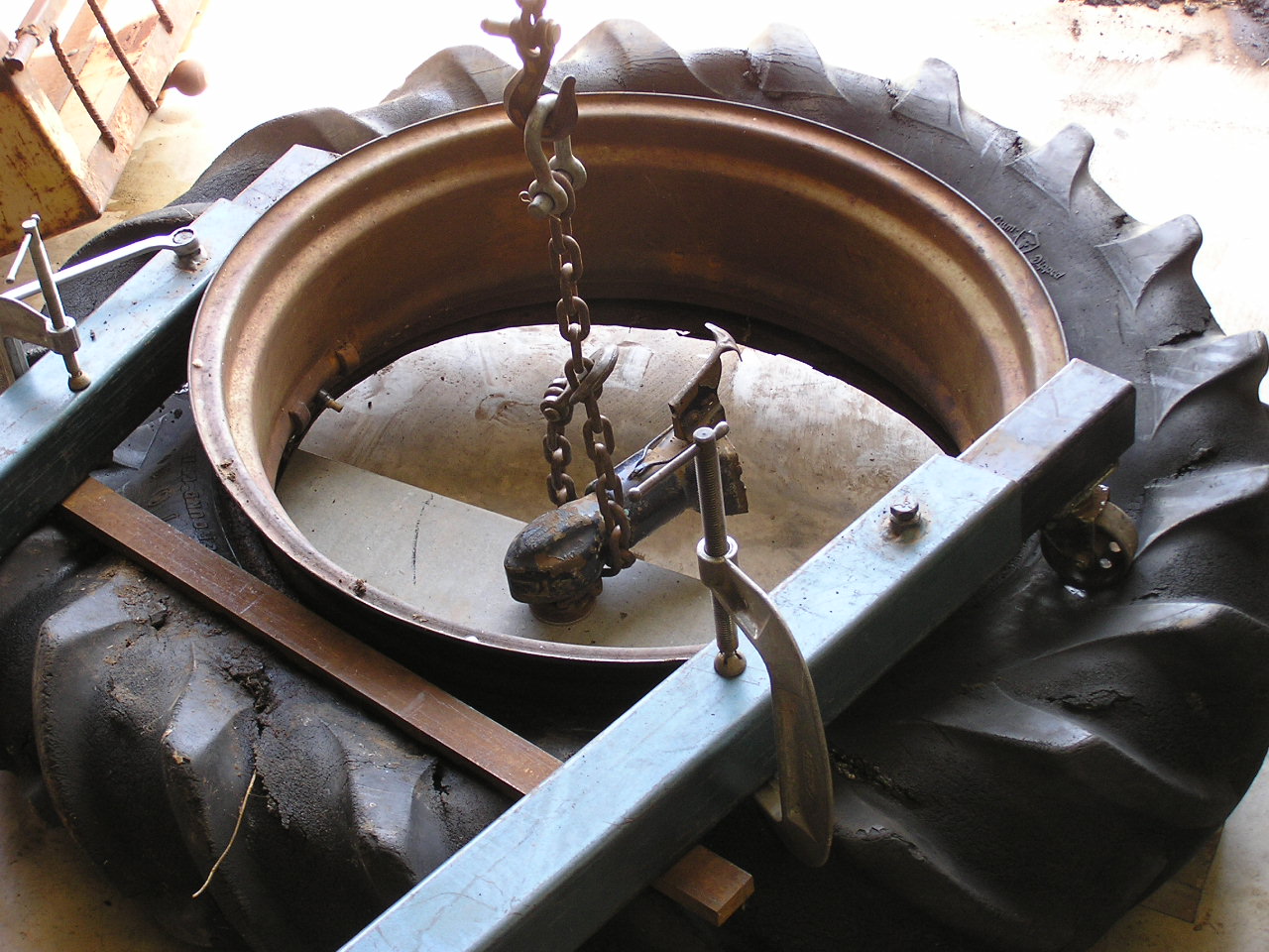

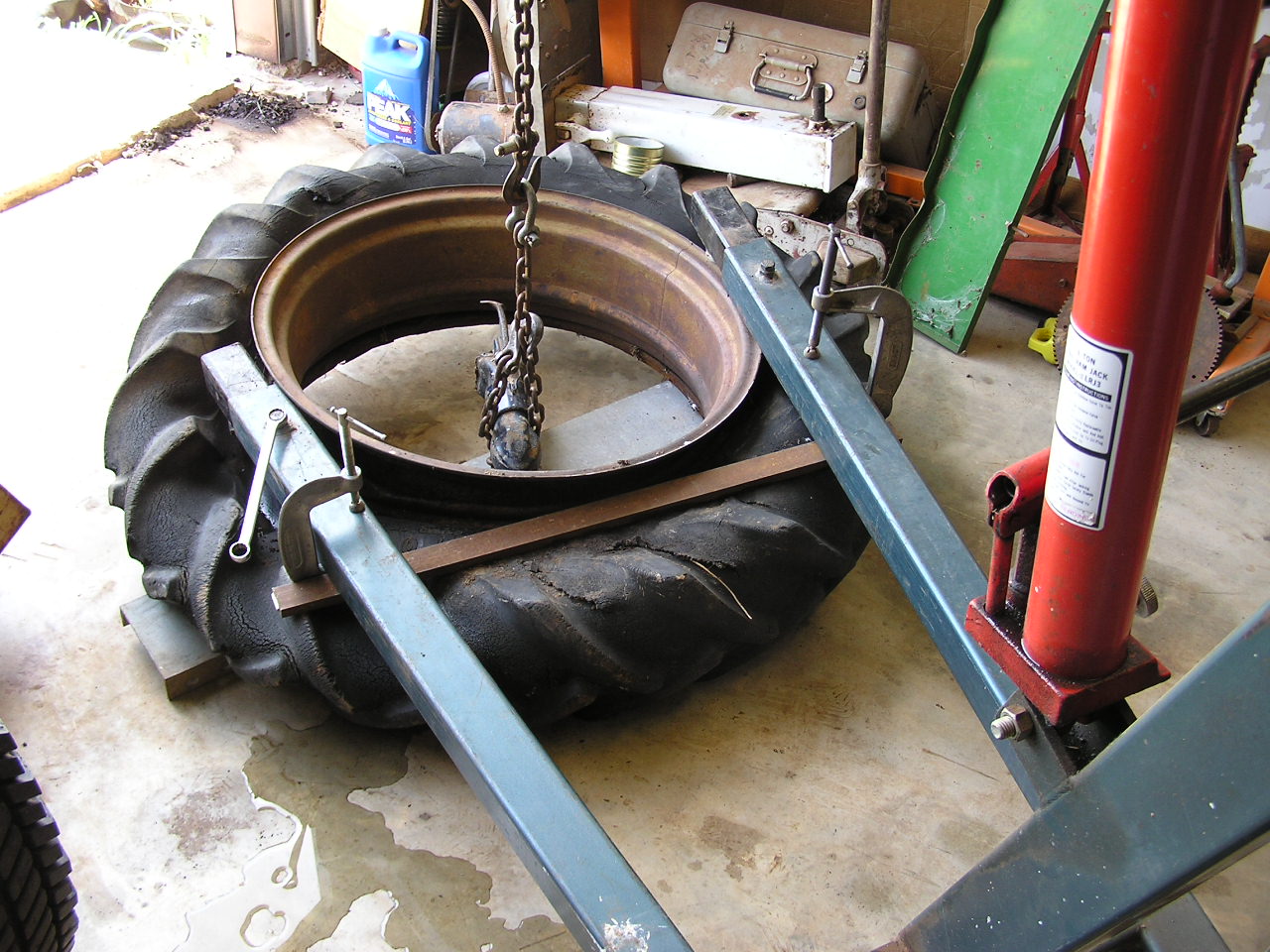

I'm surprised nobody knows about this option. The best way to break the bead is with a wood splitting wedge. You lay the tire down, insert the wedge towards the bead, step on the wedge to hold it place and then drive it in with a hammer. Work your way around until the bead pops loose. Simple as can be and works like a champ!
/ Popping a Tire Bead #31
Thanks. I'll have to try that. I have always used a tire hammer but this sounds like less it would be less risk of damaging the rim.

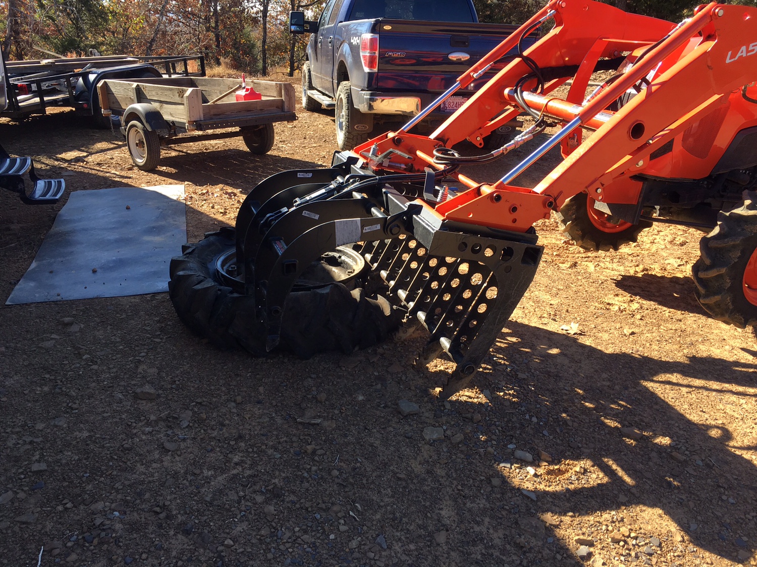

I have used the side of my bucket many times to break a tire bead, small mower tires up to large truck tires, I have found that rotating the tire between several presses using the bucket, basically loosening the the bead rather than just ripping it off (don't use a cutting edge or tooth bar), you can also press the tire with the loader bucket and hold it, then hit the tire with a large hammer.
As for inserting the tube, it would be alot easier if both beads were broken and you pry off one side only, so you can lift the tire up, place blocks of wood or bricks to hold it up, while the rim is flat on the ground, position the tube evenly around the tire, then pry the tire back on the rim and inflate.
