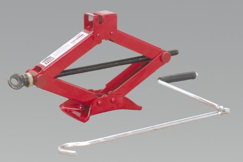

I need to tube the front tires of my BX2670. Always losing air.
What's the best way to pop the bead on one side of the rim to put in a tube? I'm not thinking beating it with a 5# hammer and a block of wood is really going to work.

I saw a video on youtube (can't find it now) that was so slick.
The guy put the tire under the hitch of his truck and used a scissors car jack between the tire and the truck hitch. He just used his electric drill to turn the jack (could of used manual handle) and busted the bead in about 2 seconds. Many of those scissors jack's bases have a nice curve built right into it that fits to the curvature of the rim.
I suppose any type of jack, even a hydraulic bottle jack, would work too.
