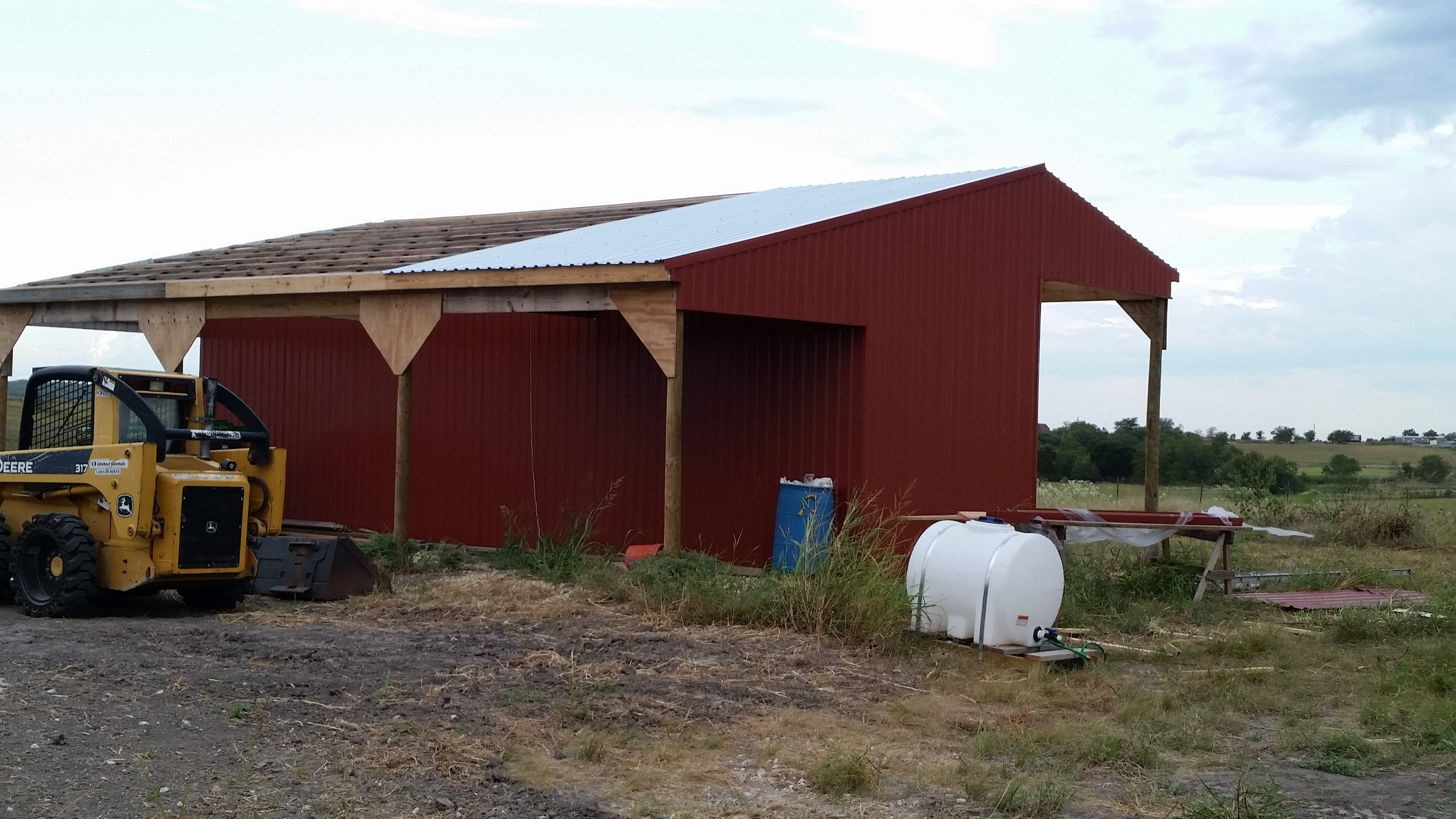

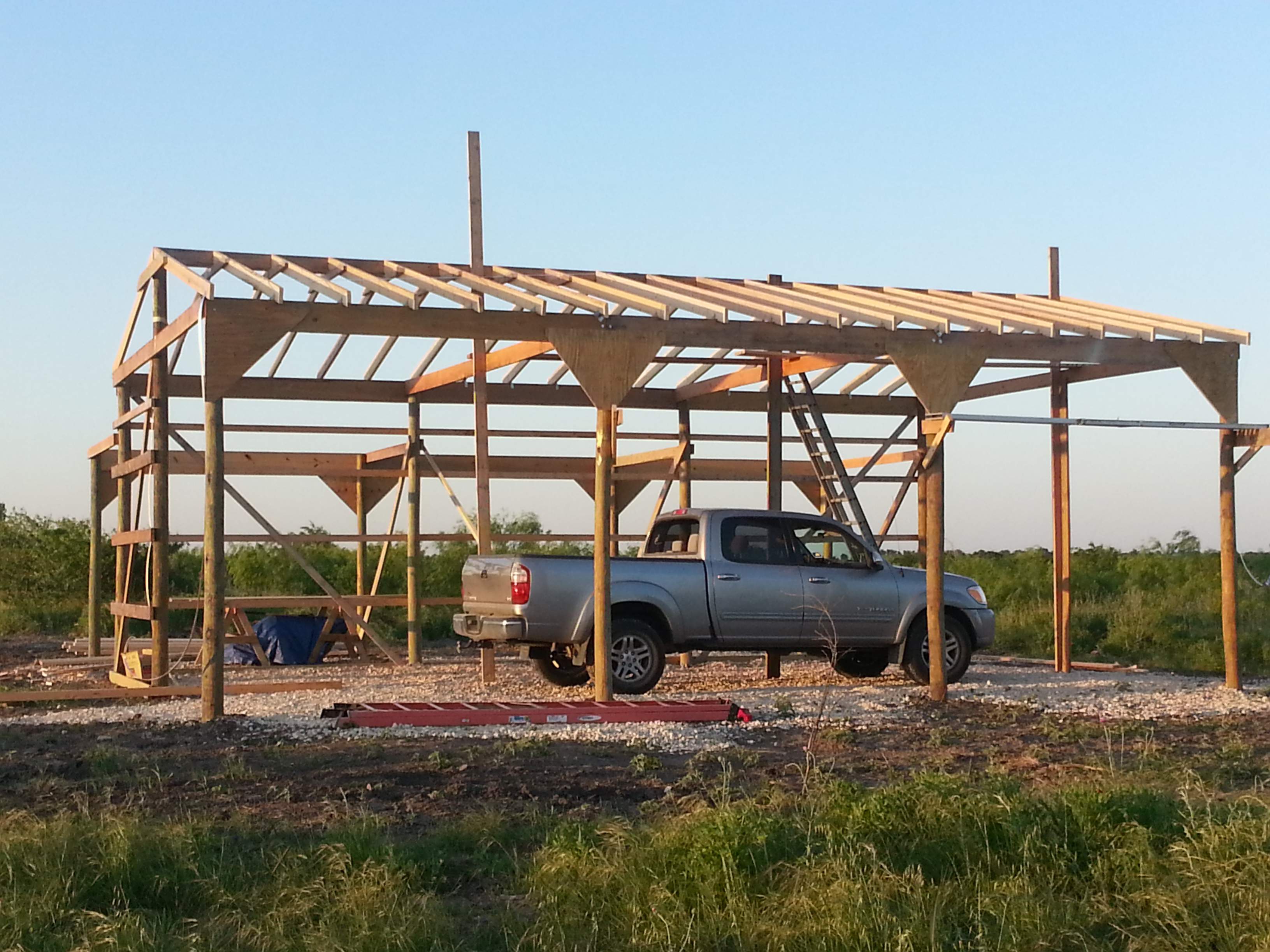

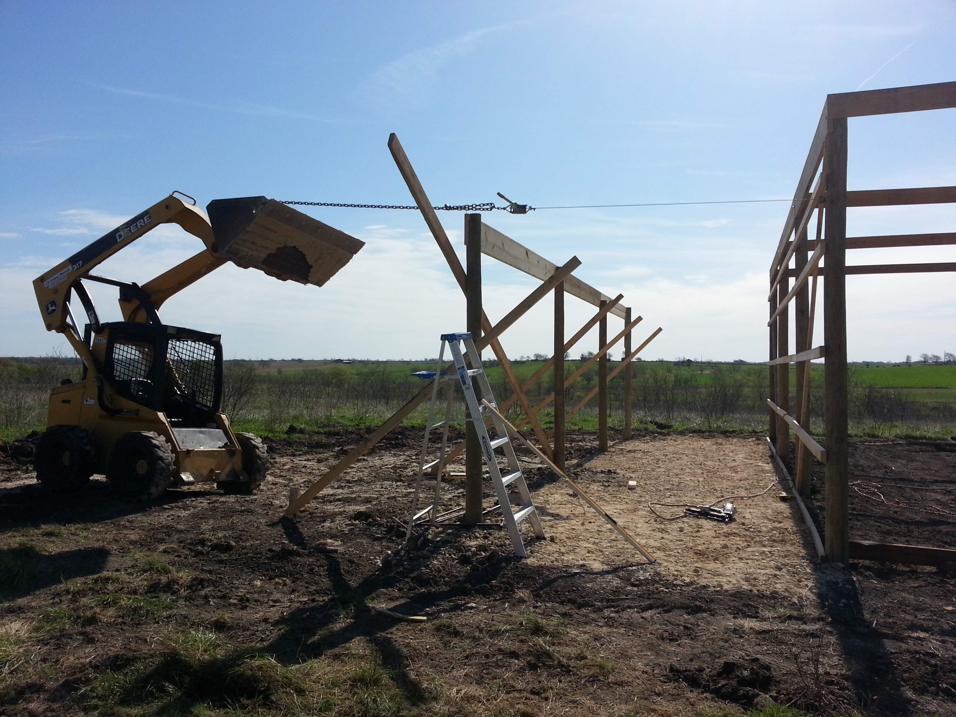

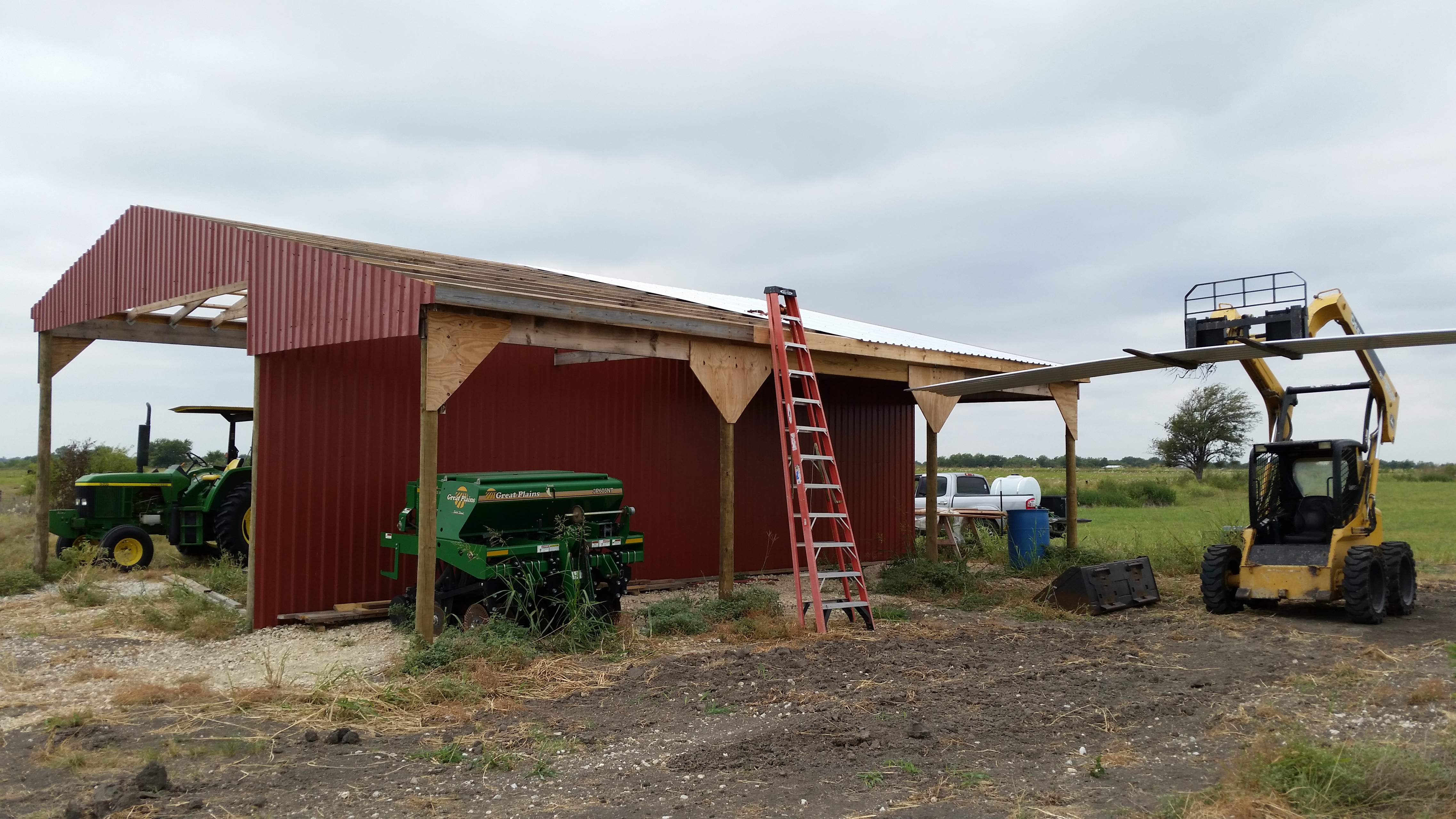

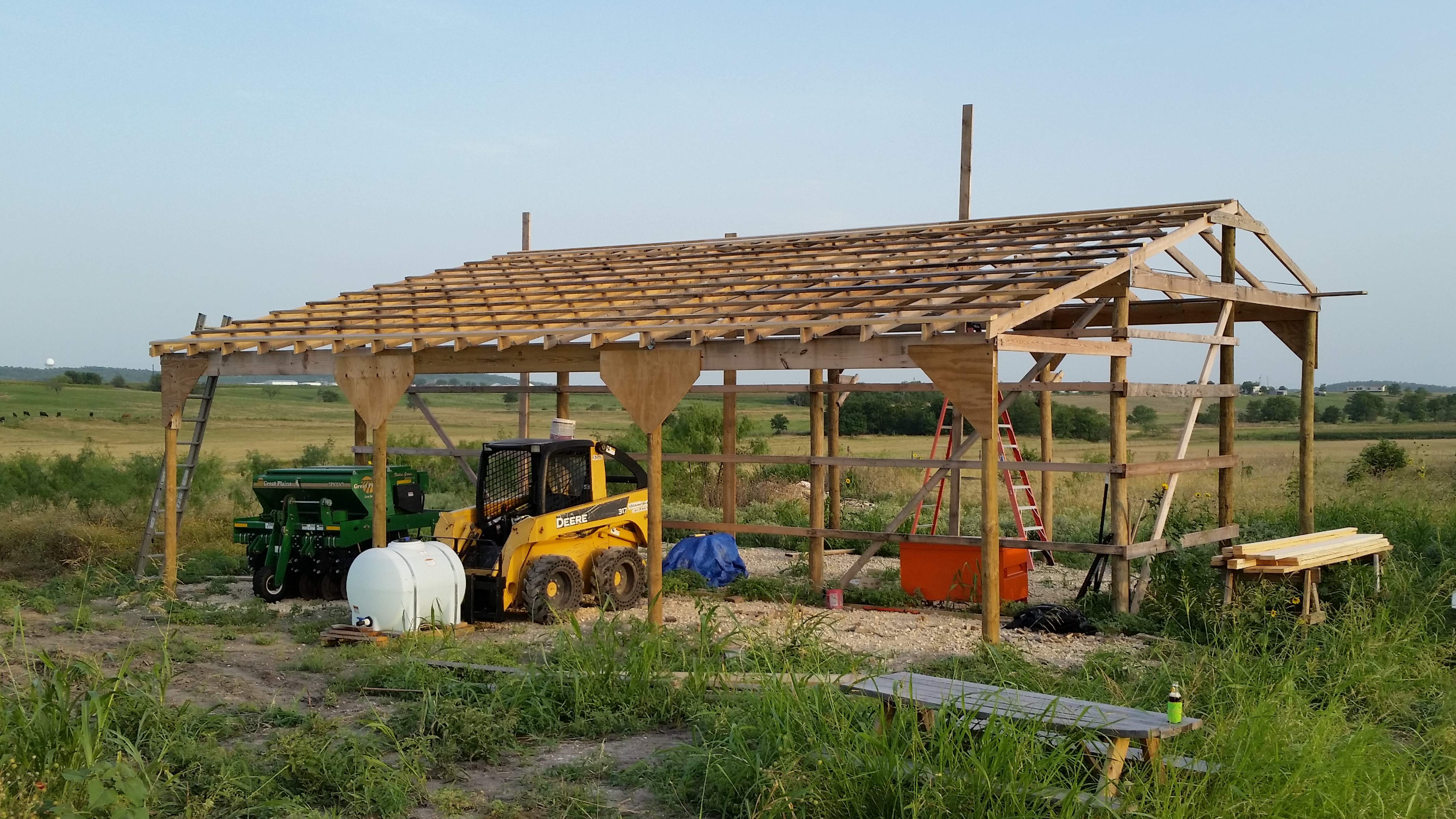

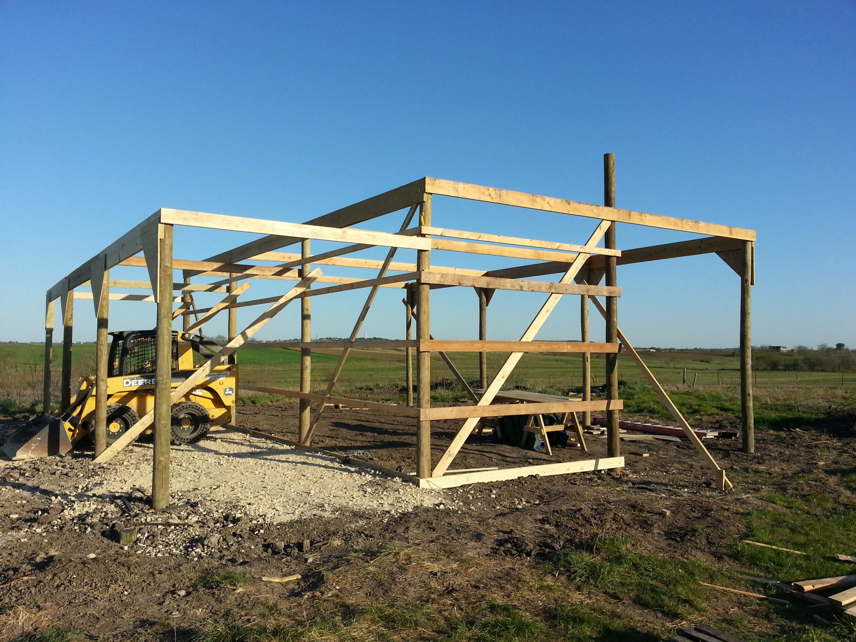

Barn is close enough that I'm calling it done. I've got some misc trim pieces to install and potentially a door later. Its been a fun project. Cost was about $2000 for lumber and $2600 for metal. My lessons learned: 1) posts are very expensive, like 25% of the lumber cost 2) I should have spent more time leveling out the ground before I started, would have made things easier along the way 3) a falling 2 x 8 hurts when it hits your head
