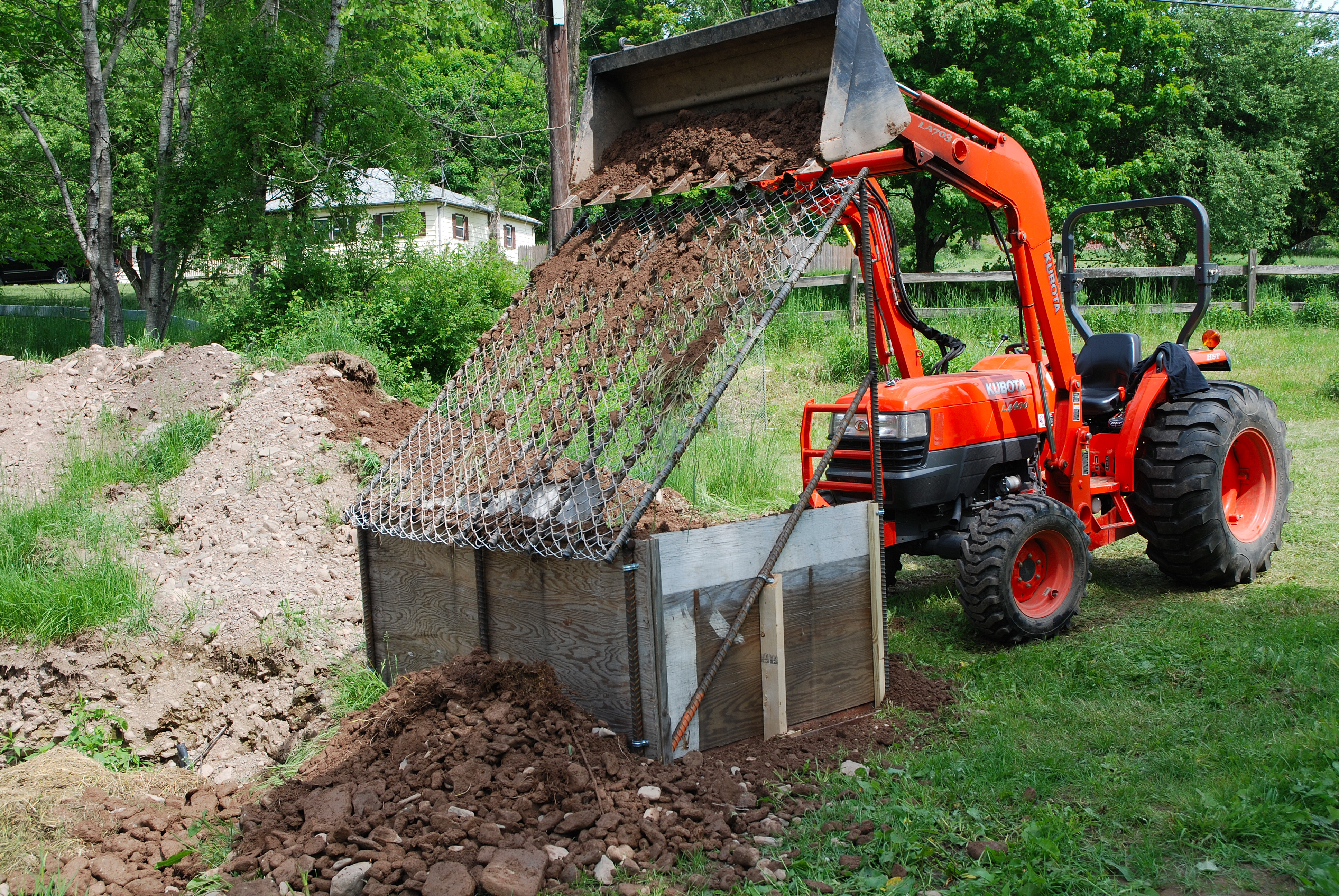

A few years back I built a 50'x75' garden by scratching the area with my backhoe 18" deep piling it then screening it all. The screener I built was on the cheep but worked better than expected. Total cost $50 for the piece of 9 ga. chain link fence and metal strapping,had the pressure treated lumber from a deck I removed. You have to go to a fencing co. for the fence, the big box stores only have 11 ga. crap. I didn't stretch the fence fully since the holes would be to big, so I tightened up the openings and secured it with the strong back straps in three places. Basically used a 9' length of fence in a 6' run.
Since the pictures I have added a couple more boards to the sides to better contain the soil.
The only downfall I have found is that some odd shaped rocks, roots, and branches will sometimes clog the screen, so I keep a metal leaf rake handy. Other than that I am very happy with the results, dig a hole with backhoe, place screener in front of hole, screen out soil, rocks roll into hole.

Weeks of planing and about a day and a half to build. I actually built it in the shop in my basement ( like a boat), only I was able to partially disassemble and send it out the basement door for transport and reassemble.
I tried to pull the larger rocks out by hand, 8-10" a and over so as to not damage the fencing.

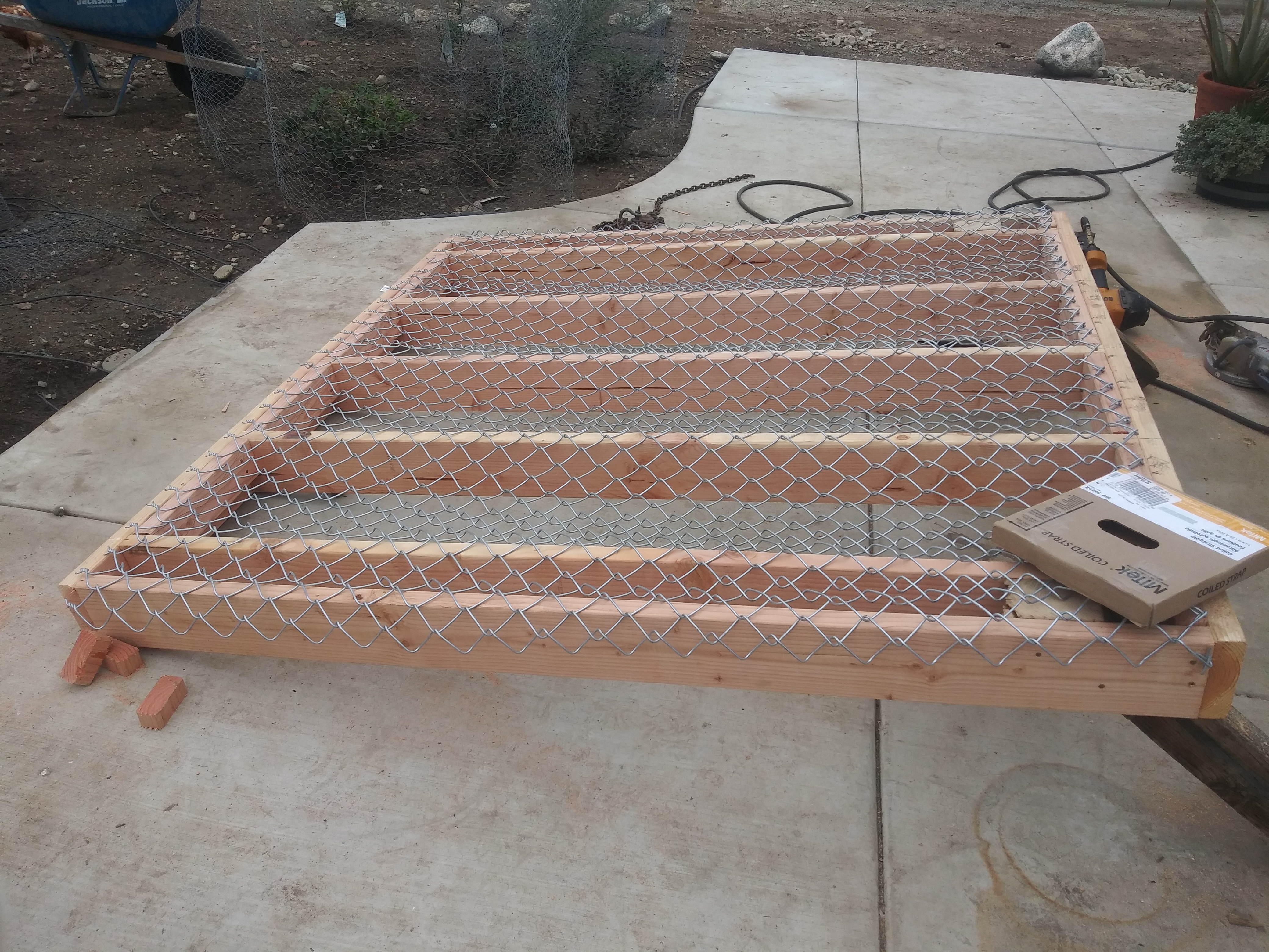

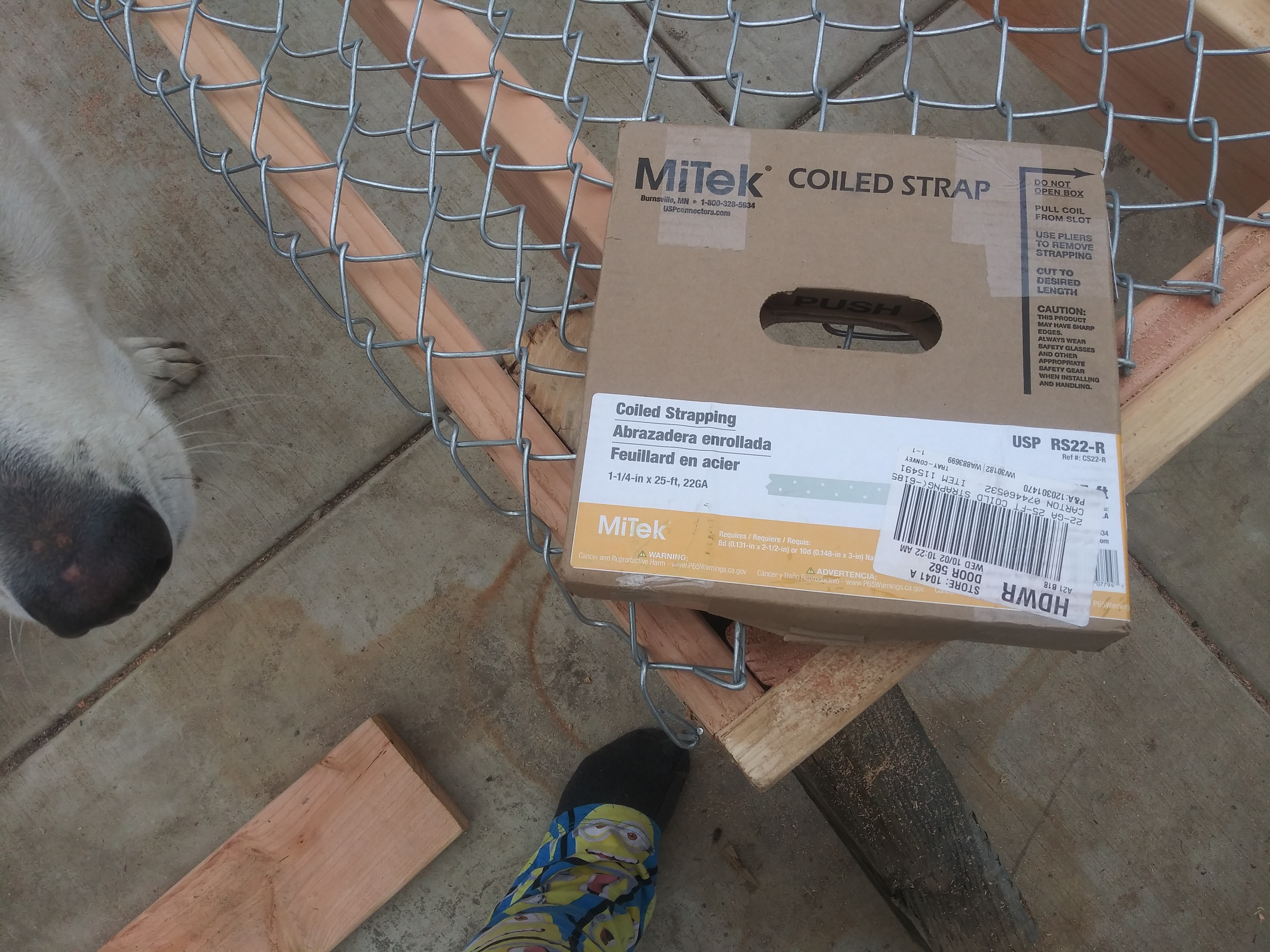

I'm in the process of building a rock sifter patterned after yours. In looking at the pictures you posted I cant really see how you attached your 9ga. fencing material to your framing .Can you go into a little more detail into how you went about it? I purchased a box of 1 1/4x22ga. metal strapping,(the type they use in residential framing to tie structural members together) I posted a couple of pictures of how far I've progressed but I'm trying to figure out the best or strongest way to attach the fencing material.
/ plans for soil screener #12
Hello AVMCANE
JUst wanted to add that in the pictures I posted,I only have the two shorter front legs attached to the framing .They are cut at a 45 degree angle, I've yet to install the hind legs which would position the main frame at 45 degrees

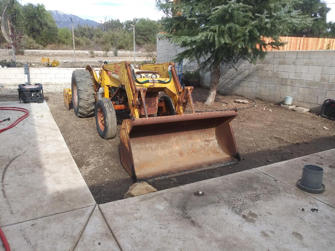

This is the tractor I'll be using to load and screen approx. 10 yards of rock and dirt20191202_123256 (1).jpg
