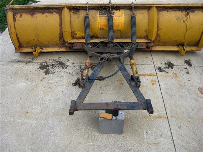

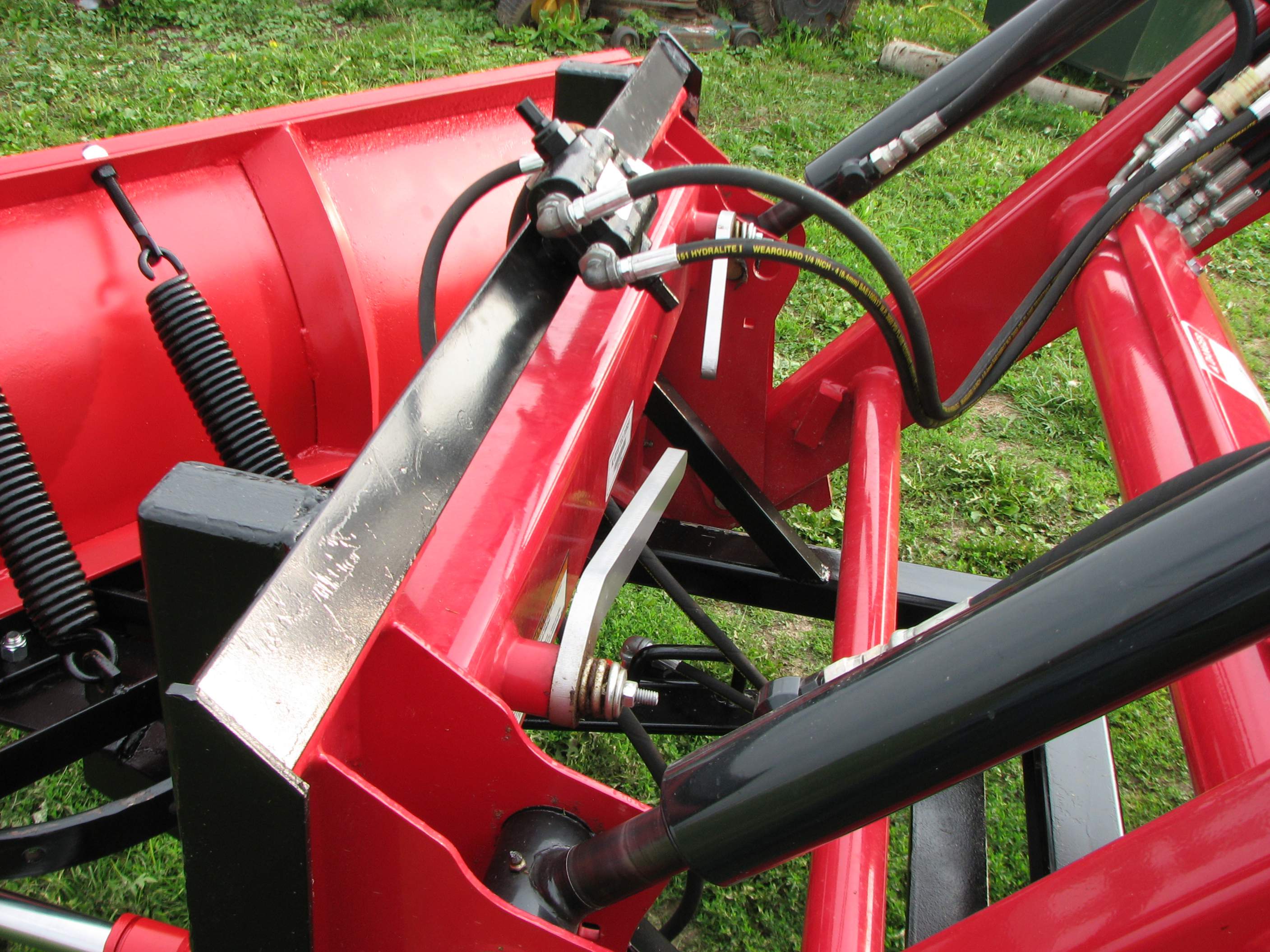

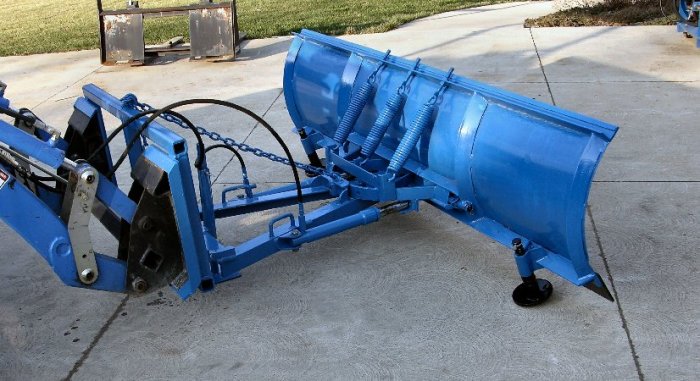

Great set up I like how you "tucked" the plow tight and under the arms. This will be my first year with mine mounted under also. I had it connected with about 4 inches under the frame last year. It worked well, but I still didnt like the legnth and also that amount of weight overhanging the front. Made it feel like to much weight swinging around out there.
Here's a pic of what I install to plow snow.

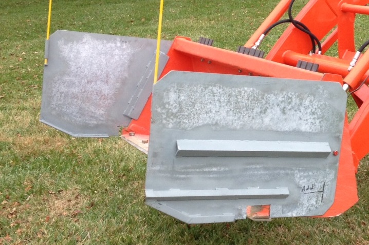

Tell me more about these wings on the bucket. Did you build them or buy them?
Skyhook is correct - homebrew. There were a few pieces of 10 Ga galvanized that were cut to fit. They lap over most of the outside. On the inside each wing has two pieces of 1/4" x 1-1/2" flat bar. The first piece fits tight against the bucket and the second is staggered so it fits inside the bucket. Like a long narrow belt clip on a tape measure. Scrap pieces of angle are welded on the outside to stiffen them and another for a mini skid on the bottom. Due to the way things lock together, a single bolt holds each one securely. Now we need some snow for a test drive.

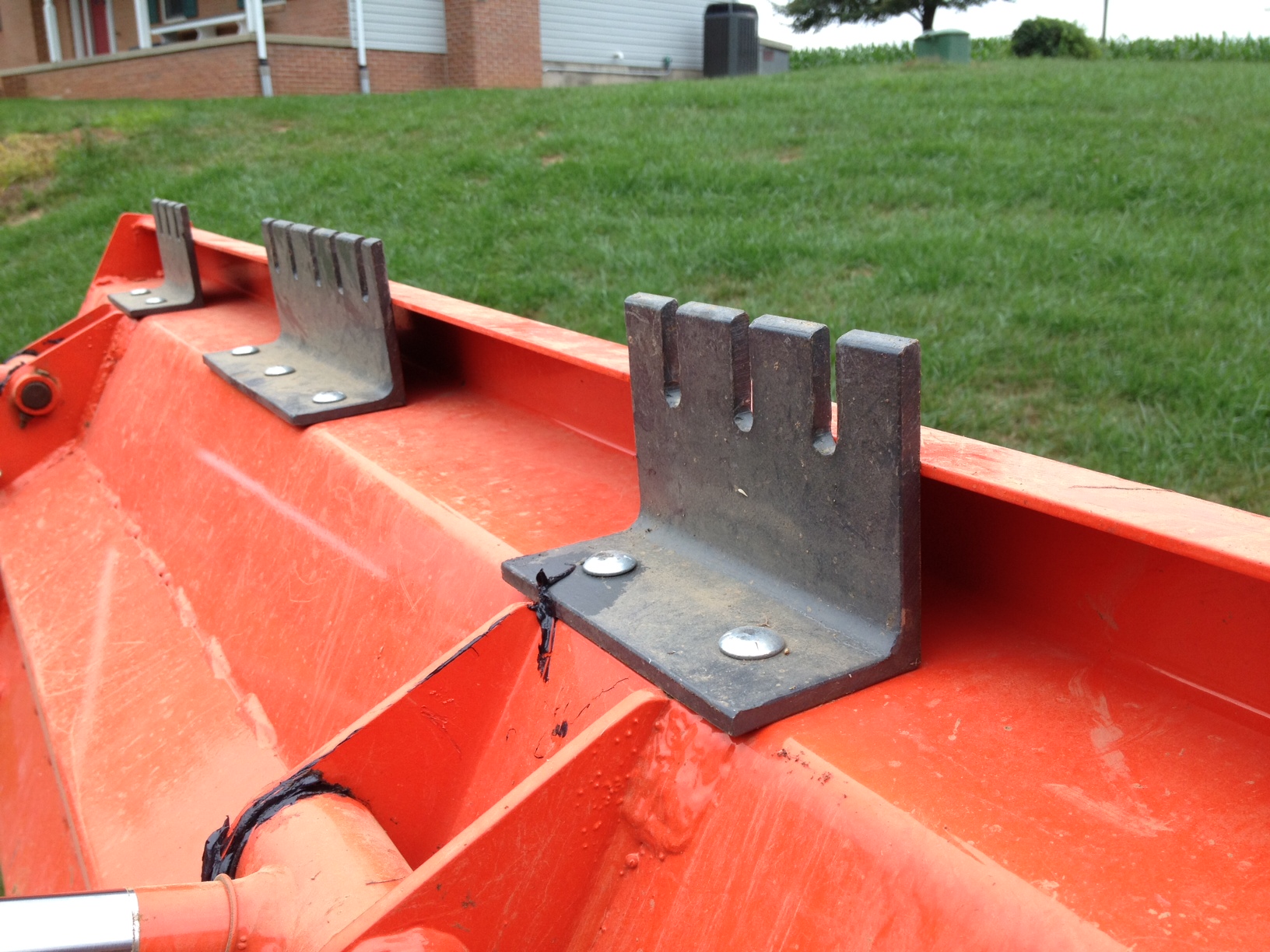

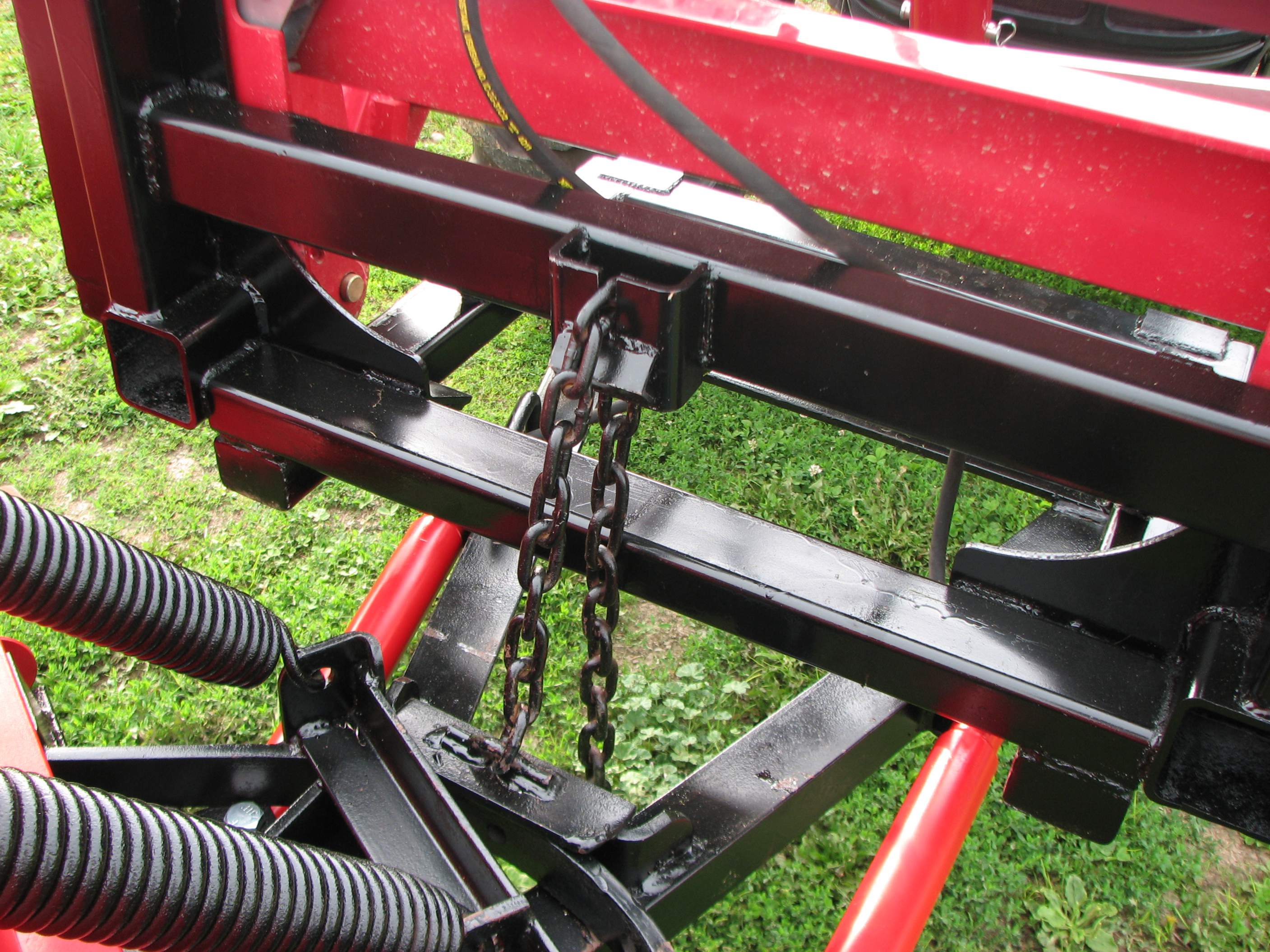

Chim, what did you use to make those "slits" for the chains on top of your bucket....
torches, plasma?

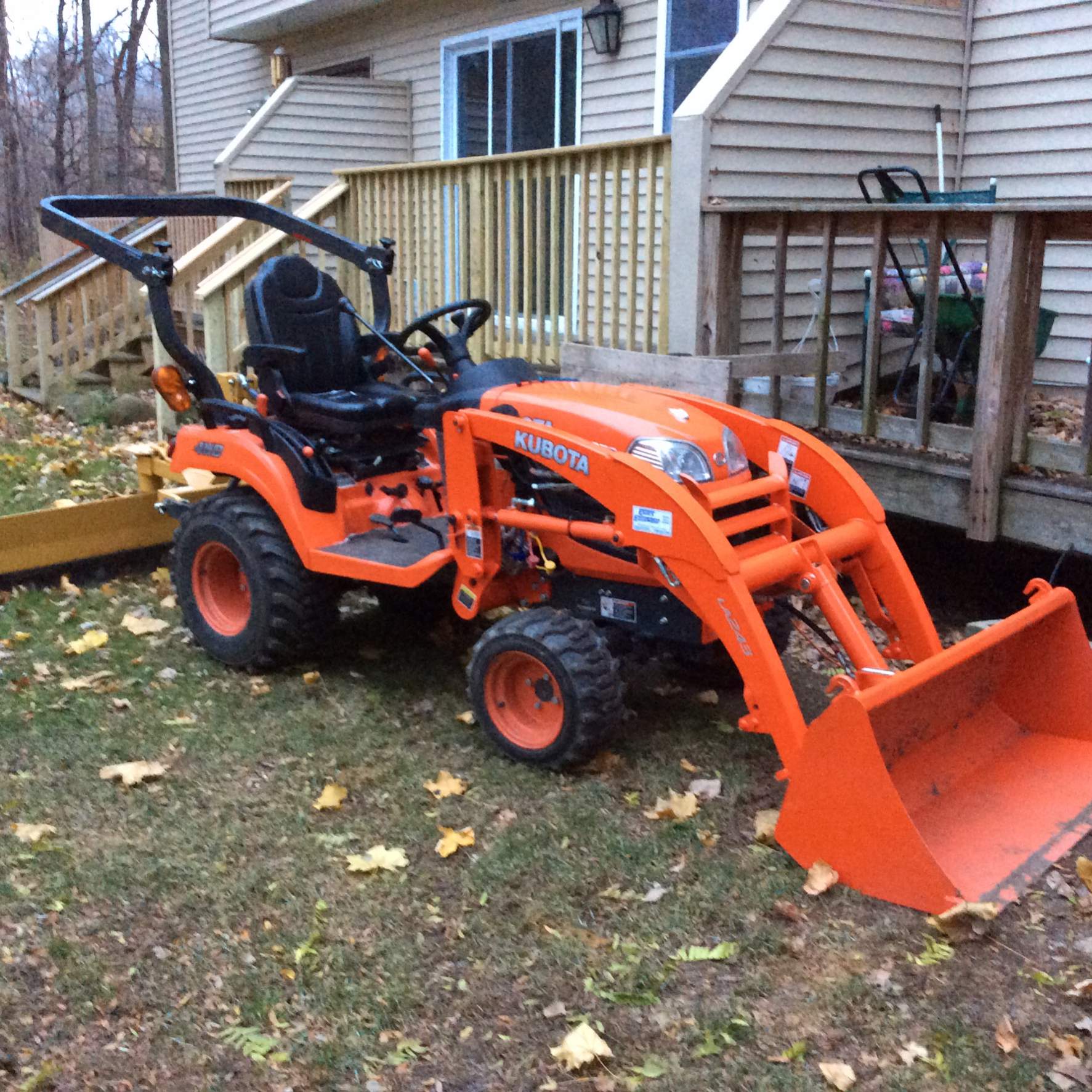

This is my snow weapon!!! I just got the FEL on it last week! Works like a charm!

Nothing fancy, just a drill press and band saw. Drill a hole where the bottom of the slot wants to be and then saw in from the edge. Instant radiused end.

:thumbsup:

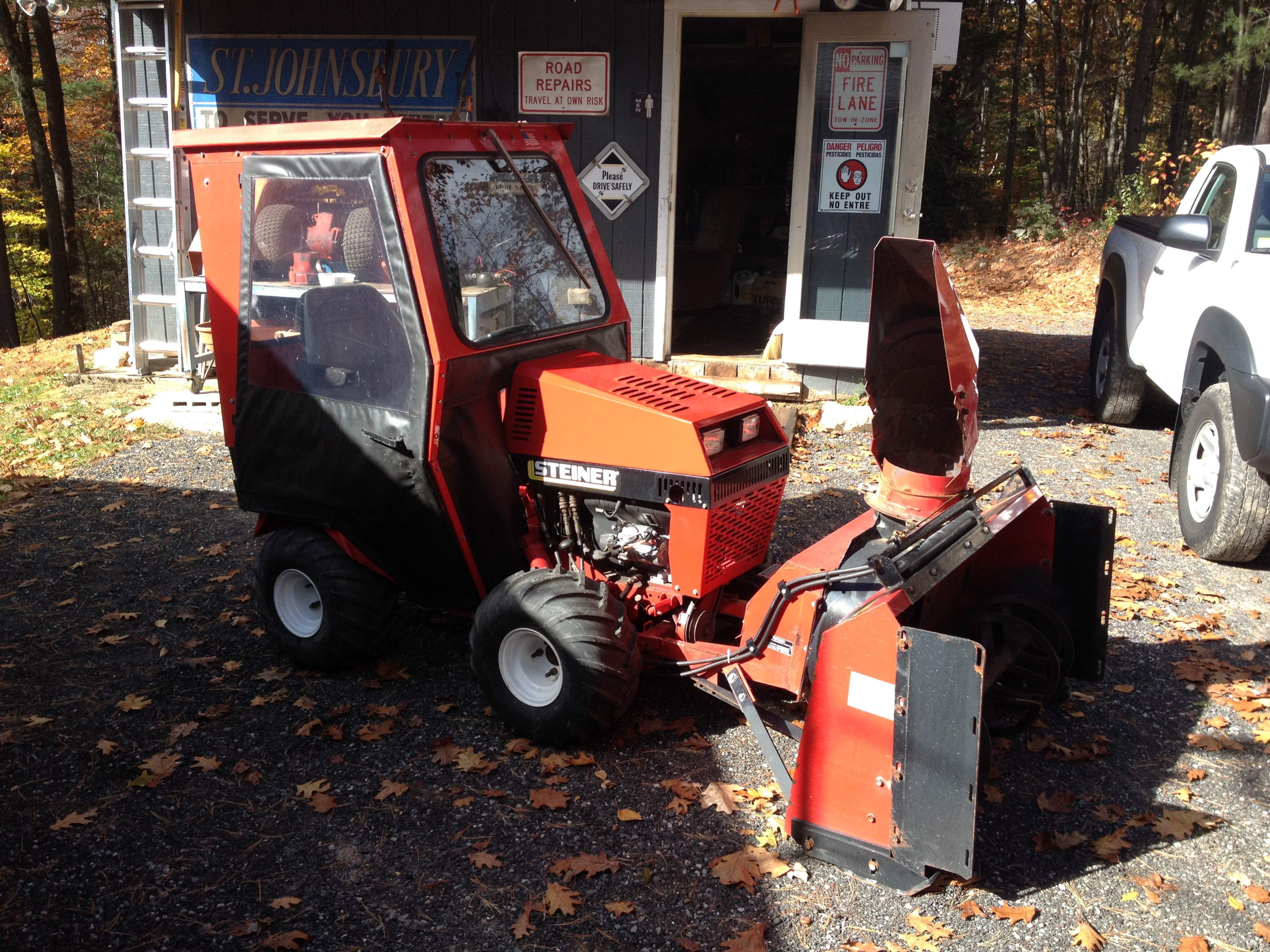

Finally. After many, many years exposed to the elements I have a machine with a cab. Finally....... 022.jpg023.jpg027.jpg

Nice looking little snow machine, great wife. Best of luck and stay warm.

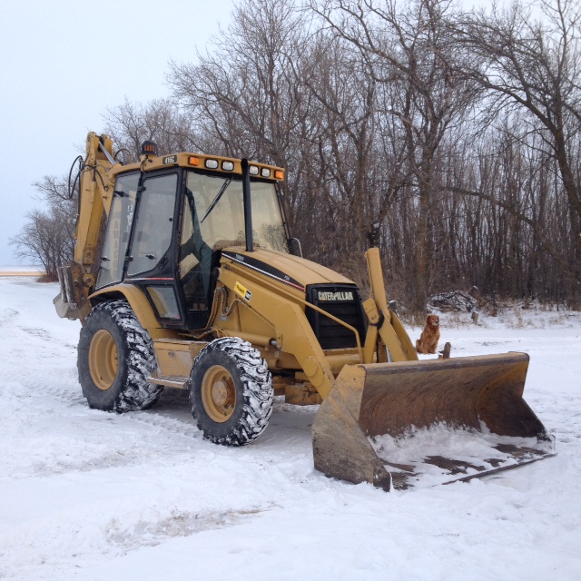

latest edition brought home today....1998 cat 416c turbo

Nice and clean,:thumbsup: do you plan on a plow for it or are you leaving it just as is.

D7E nice cat, looks well cared for. That should care for a light dusting😀
