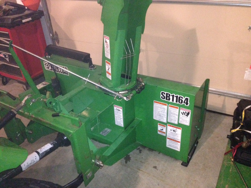

Here's my snow weapon. I also recently made a 3 point hitch SSQA adaptor so I will likely also outfit my Deere with my 5 ft landscape rake. All I think I need are some tire chains.

this will be my first winter with my new tractor. I really don't need any more snow weapons but I am wondering if I will need any rear ballast on my bx2660 with a front mount blower??? If so I was considering either a box (I hear they are easier to manuver with) or a 5' rear blade. I could either with the FEL which I use for summer projects.

The ballast box, being more compact, is definitely easier to manuver with. With a blade or almost any other implement, you really need to watch the rear when working around cars, buildings and such.
As far as "will you need ballast", that's really hard to determine, but I expect you'll find out soon enough.
There is a major advantage of the rear blade (over a ballast box). You can pull snow away from a building...something you don't want to approach too closely with your blower.

A blade for a BX will add on around 200lbs-250lbs but it does hang back farther than a Ballast box so it would be more effective than a Ballast Box with 200lbs in it. You could also rear blade to move snow and you would have a another implement for projects. You could also make one of these for a ballast.
