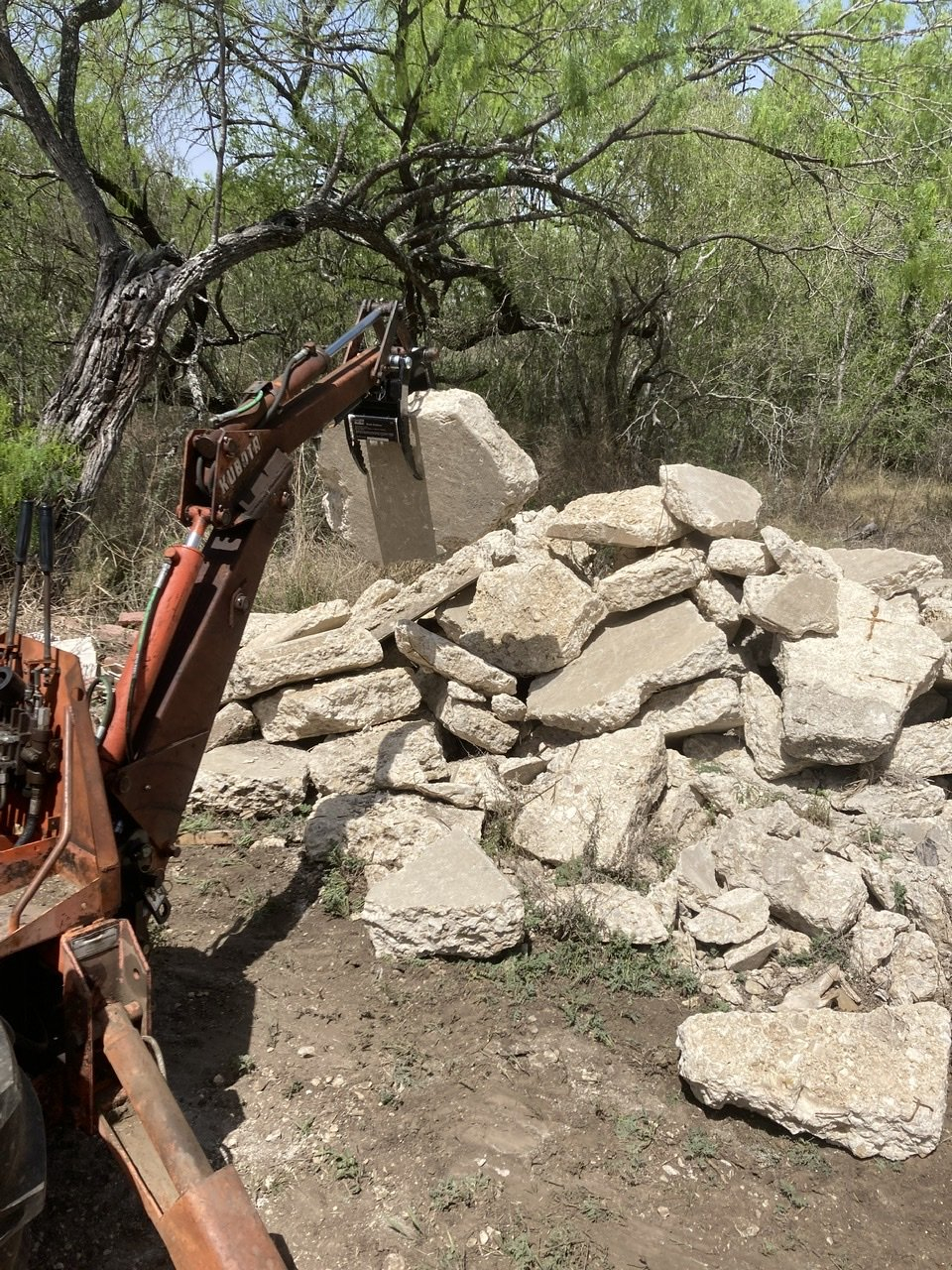

I had a mechanical thumb on my BH92 hoe and converted it to hydraulic. I found it only slightly more useful for moving rock and regretted spending the money.
bdhsfz6,
I am going to politely disagree that a hydraulic thumb is "only slightly more useful for moving rock" unless your talking about moving rock from one location to another some distance away. A hydraulic thumb allows me to keep the pressure on whatever I have grabbed ( rocks, logs, upright tree ) regardless of the angle of the bucket. I can roll the bucket all the way out or full curl in and not drop whatever I have grabbed. Great for placing rocks/ slabs into almost any position and place I can reach with backhoe.
I use the M59's hydraulic thumb for adding rock slabs, shingle style, to the creek bank to prevent erosion. The road is too narrow to face to creek with tractor, so tractor is ninety degrees to creek and hoe reaches over bank edge to place rock slabs upright against the bank. Precise work that requires the control/grip of the rock, that only hydraulic thumb can provide.
Rebuilt a road and ditch due to bad water erosion. Used backhoe to place row of upright, shingle style, slabs of rock. Pics attached.
The M59's thumb's hydraulic circuit has a lower relief valve pressure than the bucket cylinder so curling the bucket causes the thumb to move while still maintaining full pressure on gripped item.
I use the grapple to move a bunch of needed rock to the location, then use the backhoe to choose and place the rocks into final position.

I have many many medium to large rocks, ranging from "I can pick this up possibly without getting a hernia" to "I can't possibly budge this", as in 100-500# (I did say "rocks" not "boulders", though some of these may be boulders depending on the definition), that I need to move, and then later place nicely.
Basically, I'm excavating a small pond near our garden, and after I'm done excavating and setting up the pond just right (shaping, then placing a liner) I'd like to arrange these rocks which I've already dug up nicely around the rim of the pond.
Current tools: tractor with backhoe. has mechanical thumb.
I've used the mechanical thumb some, but honestly so far I've found it difficult to use. More often than not, the rocks I'm trying to grab just slip out of the jaws, and it seems like every rock needs the opening set to a different point, and if I choose a different grab angle on the rock, once again I need to change the opening.
Two things I'm considering:
1) cheaper - log/rock tongs. I'm guessing that these most likely will require a helper to use both in picking up the rocks and for precise placement. Log tongs appear to be as cheap as $130 (tsc), but I'm not sure if the 4-pointed version is going to be that useful on irregular rocks or if the points will grab ok on rocks (vs trees where they obviously bite into the bark).
2) more complex - convert my thumb to hydraulic
There's a couple nice threads here about the actual conversion (
I think in the long run I'd really like having the hydraulic thumb, but it may be more work than I'm able to do before I want to get the rocks moved.
So for my actual questions:
- any have any hints for using the mechanical thumb more effectively?
- anyone have experience using tongs for picking up big rocks?
- to be really specific, has anyone with a branson BH76 backhoe w/ thumb converted it to hydraulic?
