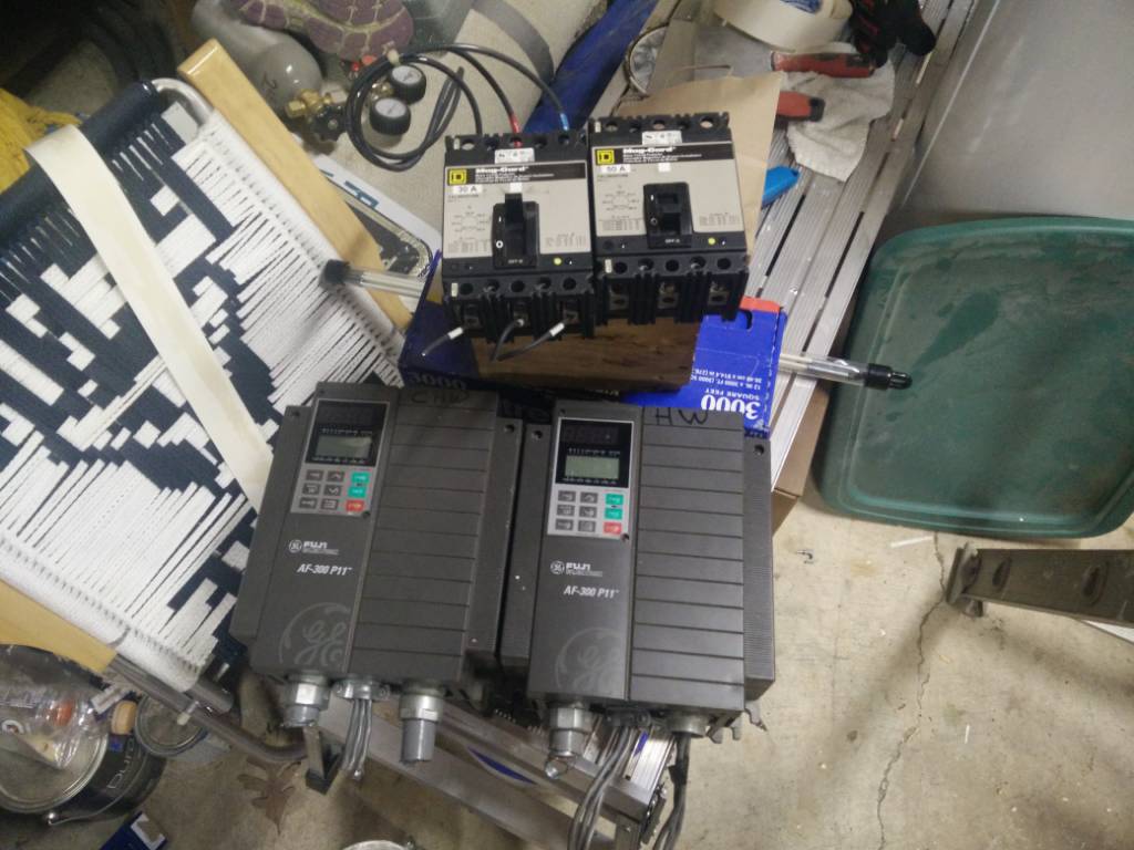

I bought VFDs used on Craigslist. Paid around $300 for a pair of them with breakers. Be careful buying old ones though, the capacitors can go bad if they sit unused for a long time. I ran them unloaded for a few days after wiring them up. IMG_20160204_234712.jpg
