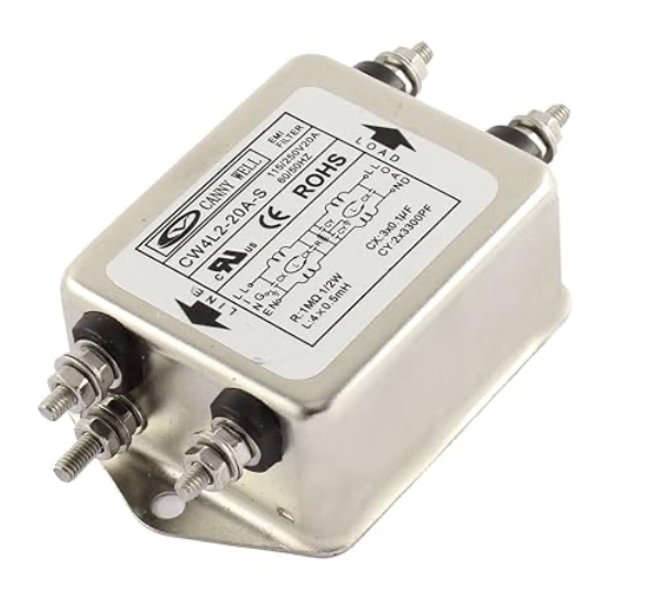

I would be inclined though not to suspect the motor. Rather, I would suspect the VFD for not producing a clean (enough) sine wave. I think it is good practice to put input and output snubbers on VFDs as a general precaution, but especially if you are not using an inverter rated motor or 120V power. A couple of appropriately sized ferrite toroids and you are in business, or you can buy a reactor. I saw someone once used some black pipe elbows and unions to make a square that he wrapped his incoming power line around. He'd measured the inductance and figured out how many wraps he needed to get it to 60Hz resonance. Pretty slick, I thought. More generally you can buy EMI suppressors to put on the input side. E.g.
