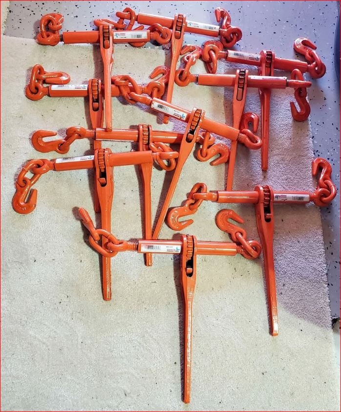

There was someone on this site that was making a cool tool to grab on the pin on the top link bar and give you more leverage without bending the pin. It wouldn't do the ratcheting the OP wanted, but a little extra leverage does a lot to make things easier.
I ordered one of these tools when I saw the topic last year. Great little tool for the money, and it works very well.
