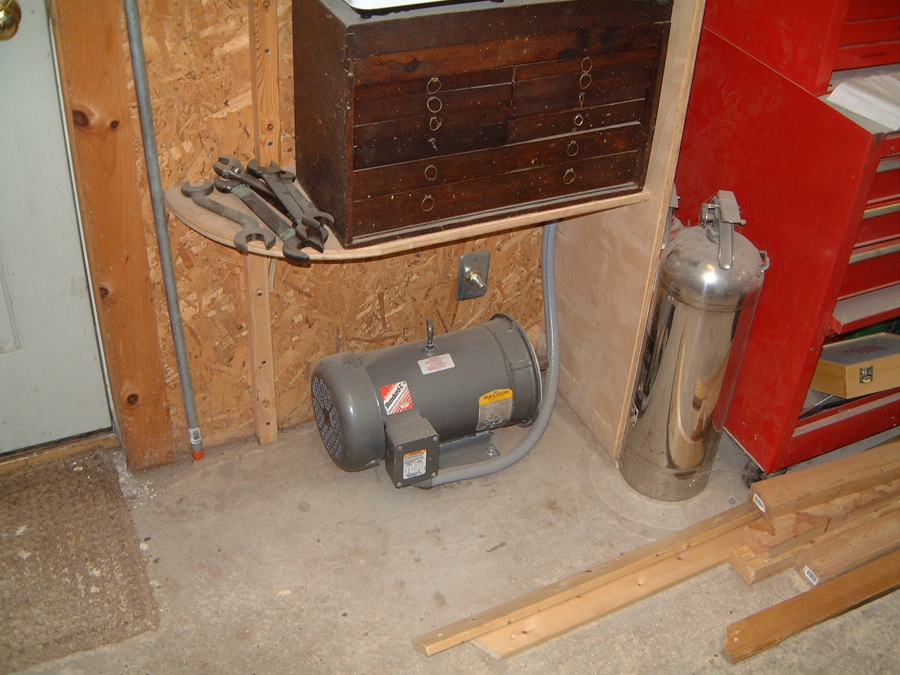

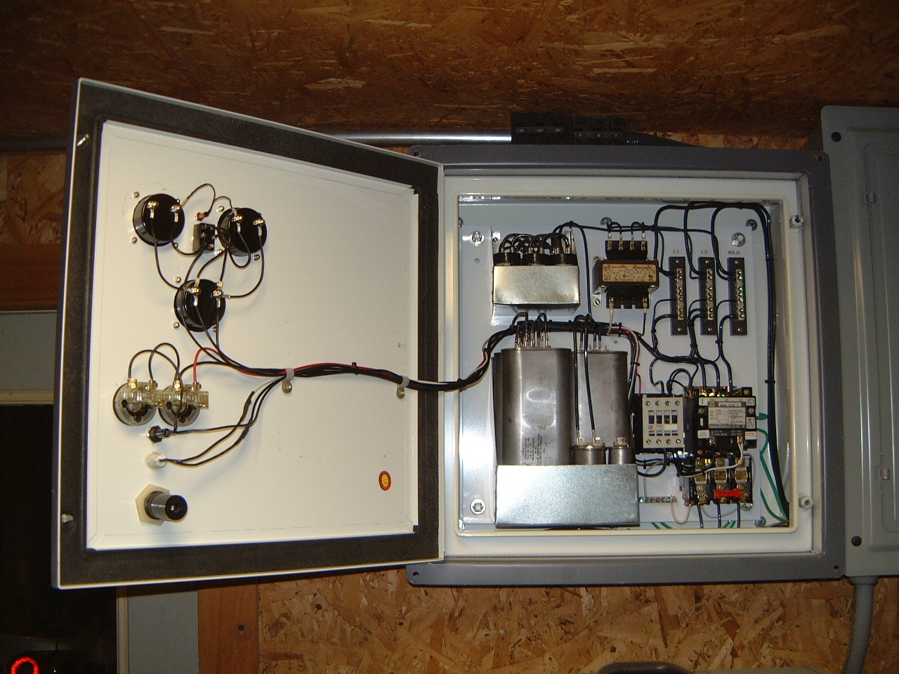

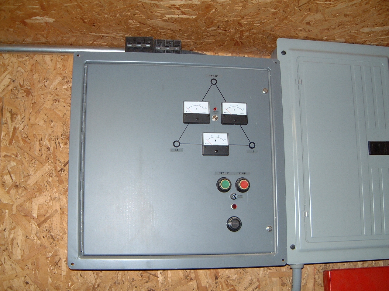

I have a rotary phase converter panel that I no longer use, with a compact 7.5 hp idler. If you need one, send me a PM. I'll probably end up selling it way lower than the cost of the parts alone, just because I want my shop space back.
