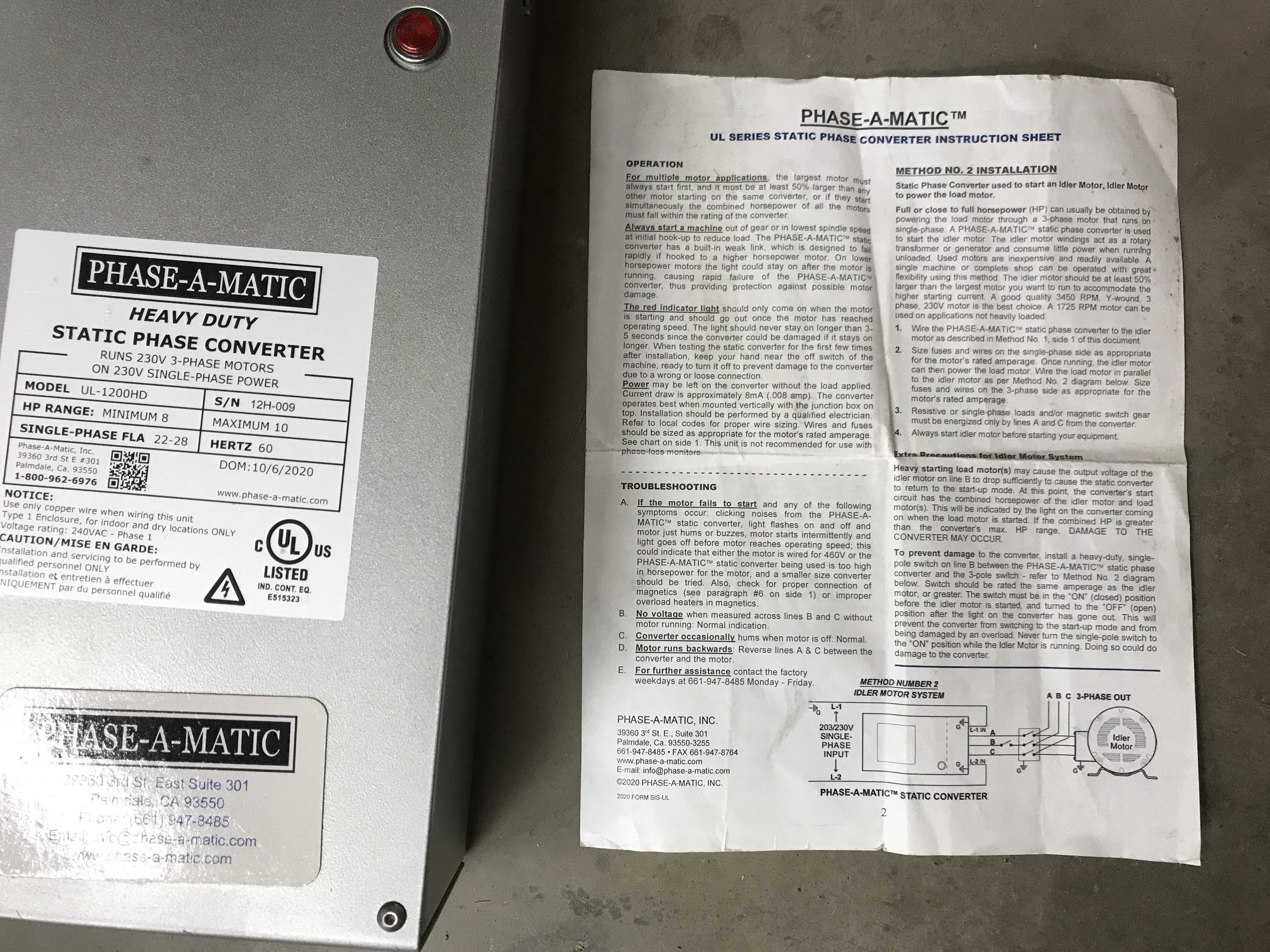

In the late 70's my dad got a deal on a 5hp 3ph Powermatic planer. We looked into making a RPC even running down a 15hp 3ph motor but dad ended up buying a new Ronk RPC.
We had an electrician install the unit. Upon testing, the planer wouldn't run instead making a loud grinding noise with the cutter head barely turning (20 rpm?) There was nothing was wrong with the planer or bearings. After much troubleshooting and calls to Ronk the answer was "not every 3ph motor 'likes' a generated 3rd leg." The Ronk was returned and dad bought a new 5hp Baldor 1ph motor and controller for similar money.
Sounds to me like someone made an error generating the phase of the 3rd leg.

Not all "generated" third legs are the same.
Static phase converters generally do a pretty rough job of keeping the third leg voltage and phasing constant with load. The trouble is that, with the running machine representing 100% of the load, any change in that machine's load (e.g. putting a board thru the planer) causes the third leg voltage and phase to change.
Rotaries can do a much better job, but even then, there's some adjustment to be made for your idler size and loading. One of the few advantages of the RPC is that, with an idler running, the variable machine load is a smaller fraction of the total. One trick RPC owners can sometimes play to get a larger machine started, assuming their contactors have sufficient capacity, is to start several smaller machines first, each of which add to the total "idler" capacity.
Thanks for that! I just deleted four attempts to say the same. These (any) motors don't use max energy input without max load, and idling another connected can help with voltage balance & stability vs say a switchable capacitor bank. (see large scale/industrial PF correction)
That said, like with any VFD that converts 1ph to 3ph we want a fairly larger RPC motor than the load, which also lets us use those other 'idlers' for balance & for starting the big one. Each will have a min power usage, but don't expect a 5hp RPC to draw full rated current when used for a 2 hp's full load.
btw, I might use a pull rope vs a pony motor to start a RPC <10 hp, surely <5. Also, often a 5-7.5 hp 3ph motor can be had as cheap as a 1 1/2 -2hp. The hint is to plan ahead, shop surplus center or ebay, and buy 2x the hp for an RPC than the largest 3ph motor you'd use it for or plan to buy. The rest has already been said. :)
