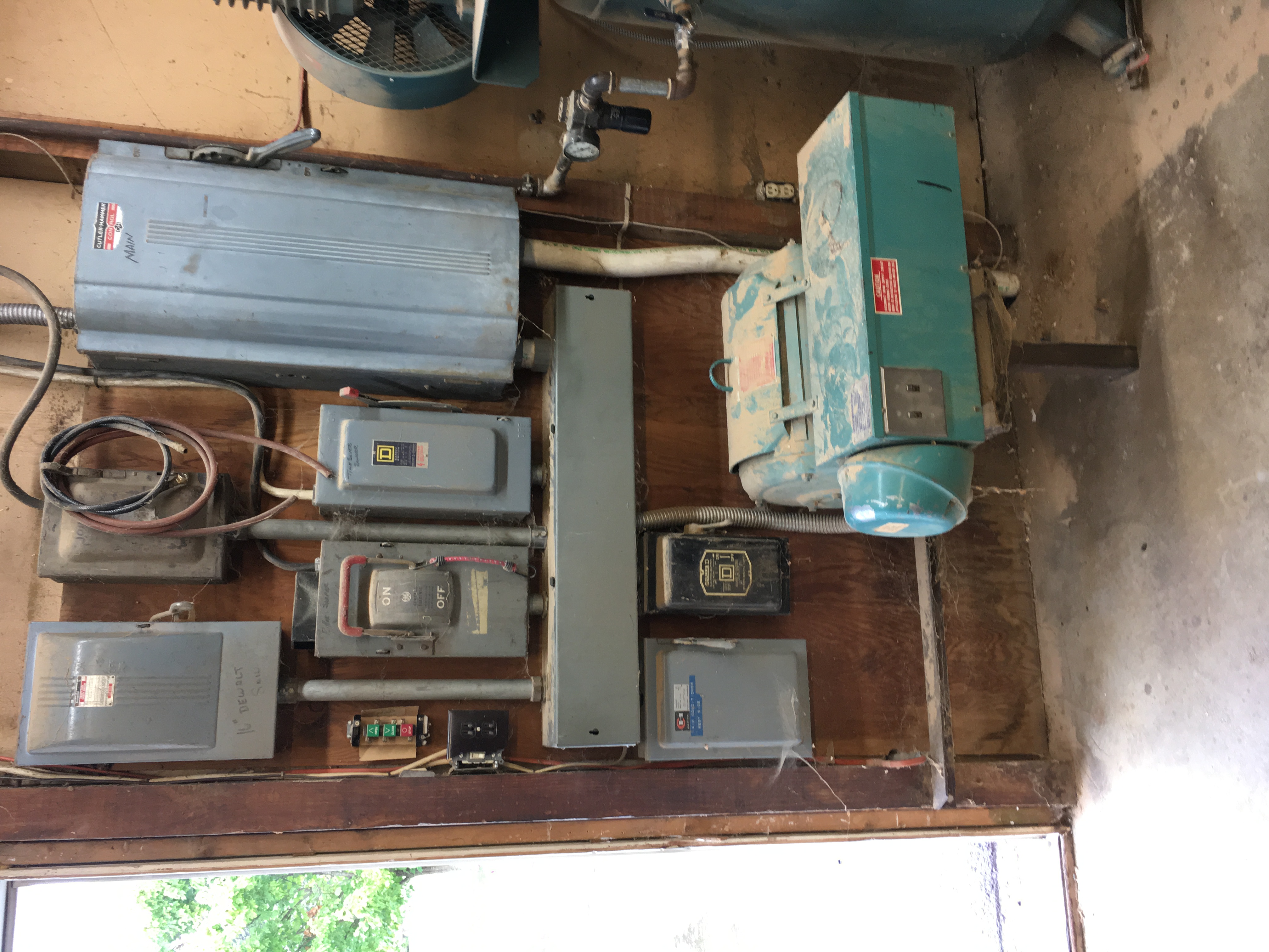

I love my transformers! Just wiring another up as I write this. Thanks Mr. TESLA!
