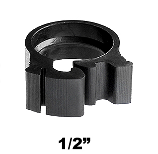

It doesn't get any simpler than this clamp, no special tools required. However, I think its pretty new so it doesn't have much history and as such I'd be hesitant to use it somewhere that I could not check for leaks like behind a sheetrock wall.
   / PEX crimp tool? #32
I've never seen that before, I will be watching for reviews

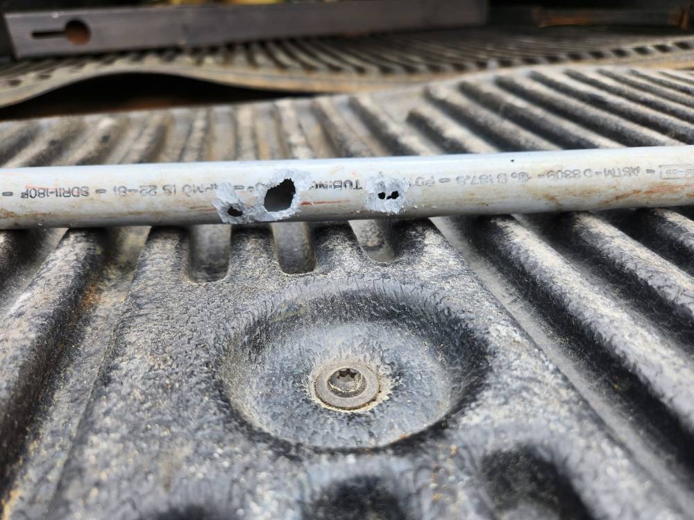

Well, I'm glad I guess that I bought that crimper. Ended up having to basically redo the entire house. I started off with Pex-B, cause the PolyB to PexB connectors are cheap, and readily available, thinking I only needed to replace one or two places where rodents chewed the line.
Well, that went sideways fast, and they ate threw most of the cold water side, and a couple places on hot. At that point, I had already started with pex, but I seriously considered just starting over with CPVC, but I didn't.
My feelings on Pex are more mixed now, instead of 100% negative. It's dang difficult to crimp in tight areas with a 2 handed crimper, and in one case, I couldn't get the crimper in the area and resorted to sharkbite tee ($17). As mentioned, long runs are marginally easier than cpvc. The big plus was snaking it around obstacles, and yanking it out from top, and feeding it top down through the existing holes, and going below and pulling what you need.

Couple examples of what they did, in a pretty short period of time.
