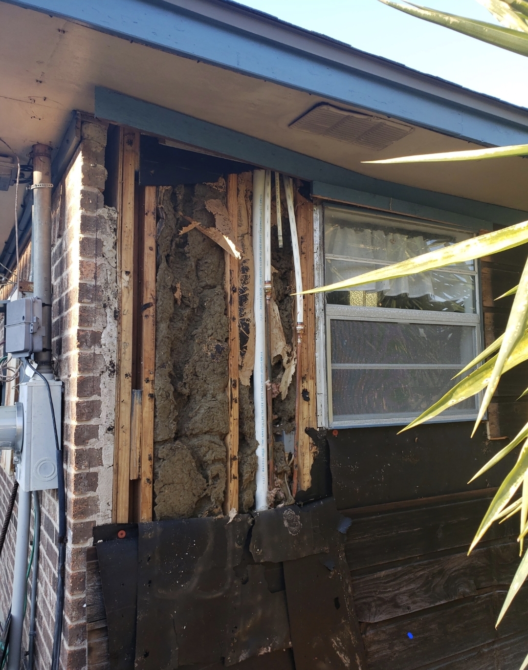

I don't know the relative humidity in the house but I know it isn't good. The house might as well have a door open year round. Electric bill gets up over $500 in the summer. I had all the windows replaced with double pane energy star windows and it made zero difference because the windows weren't the problem. The walls are. There is no sheathing. I learned when a pipe in the exterior wall burst, I pulled the shiplap siding off and I'm looking right through the "vapor barrier" (disintegrated, eaten up tar paper) at the back side of the insulation. Except in the spots where the rodent tunnels are all the way through the R11 insulation, in which case I'm looking at the back of the drywall. The siding needs to come off the whole house and reinsulate the whole thing, put up modern vapor barrier, put up sheathing, and install siding that isn't full of knot holes and welcome signs for mice.

here i found a picture.

If you decide to stay, I would highly recommend that you use spray foam insulation between the studs (relatively easy with the siding off), but you also need it up in the attic (not so easy).

Well, given the local salt air, what seems like a relatively porous house, and the likelihood that the home insulation probably gets at least damp, if not wet in storms, it would seem that you have some real issues there. I hope that you don't have any mold.
