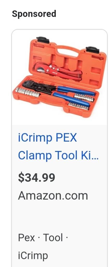

I need to crimp a new toilet supply on a 1/2" pex line, the old valve was dripping. First, yes, I Hate PEX, worst pipe ever made, but it is what it is. I have already tried a shark bite, and although it seems to grip, it leaks around it, so maybe the crap PEX is out of round? Anyways, I will hopefully never work on anything PEX again, anything new, I always use CPVC/PVC, so I don't want the "best" PEX crimper, but just want a cheap one that works. Any recommendations. Thinking about getting the iCrimp, but figures I'd ask first. Around here, PEX is only used on manufactered homes, anything else is CPVC/PVC
/ PEX crimp tool? #2
I have one of that style and it works well. No leaks on maybe 30-50 uses.

If you're just doing a small number of crimps I prefer a block-style tool like this:
It works better in tight spots and gives you more latitude to make sure it's aligned properly to avoid spoiling the crimp by getting it crooked. It's a lot slower than a lever arm style but that won't matter for a small job.

iWiss/iCrimp have fantastic crimpers for just about everything, a great value compared to many brands. I have them mainly for connector (electric) assembly and they are great. Some AMP/Tyco crimpers are in the hundreds of dollars and unaffordable for the hobbyist and small business. If I needed a PEX crimper, this is the first place I'd look.
