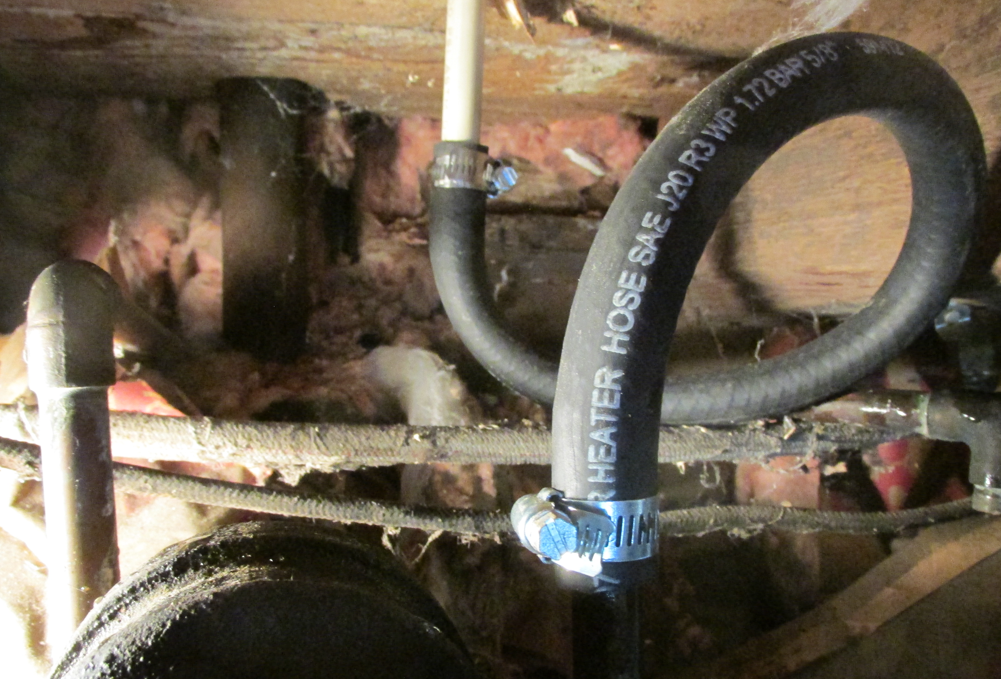

I suppose you could get away with a hose clamp, never tried it on pex, but I did have a copper pipe burst a few years earlier and did a temporary repair with some automotive heater hose & hose clamps.
