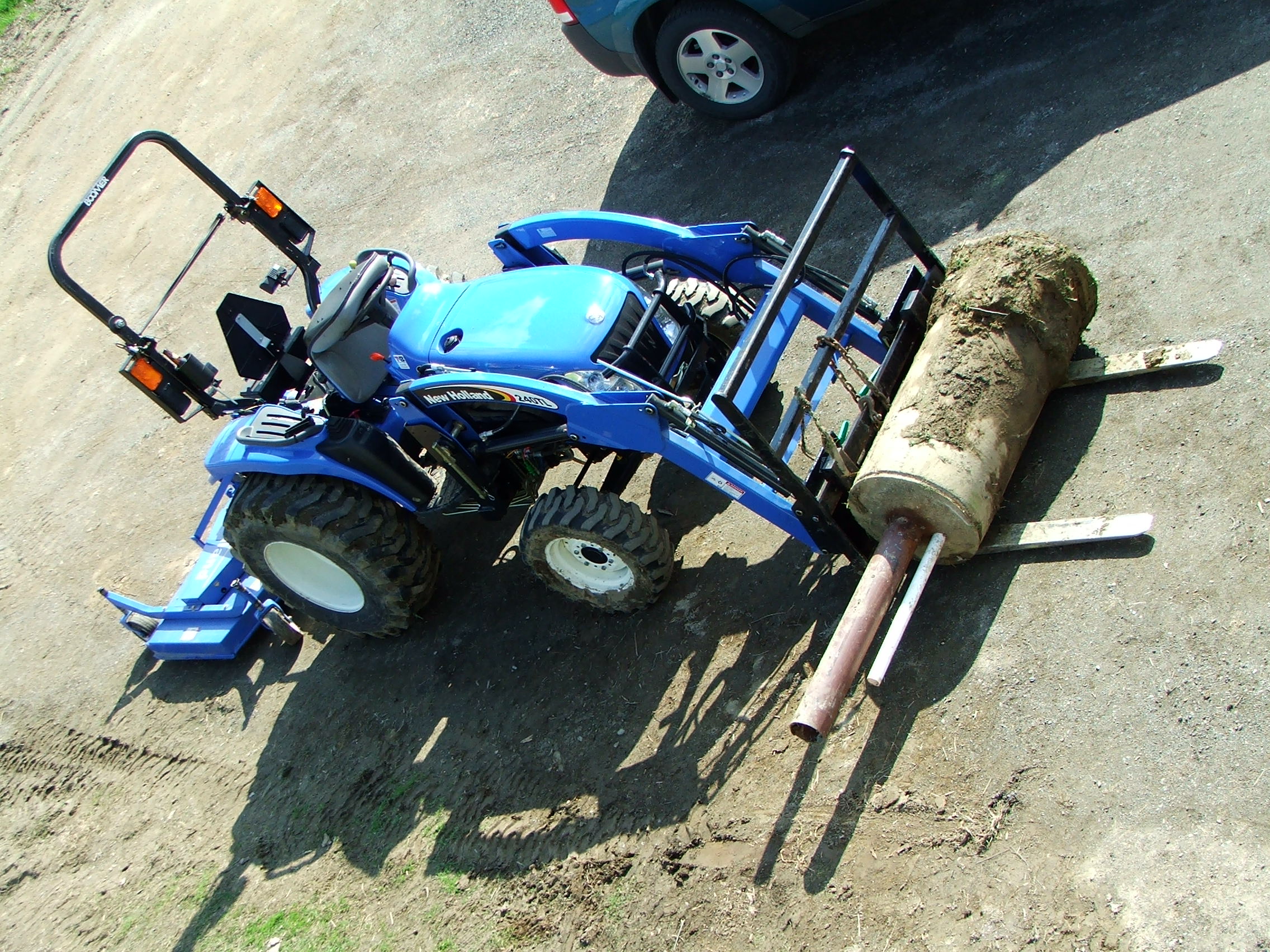

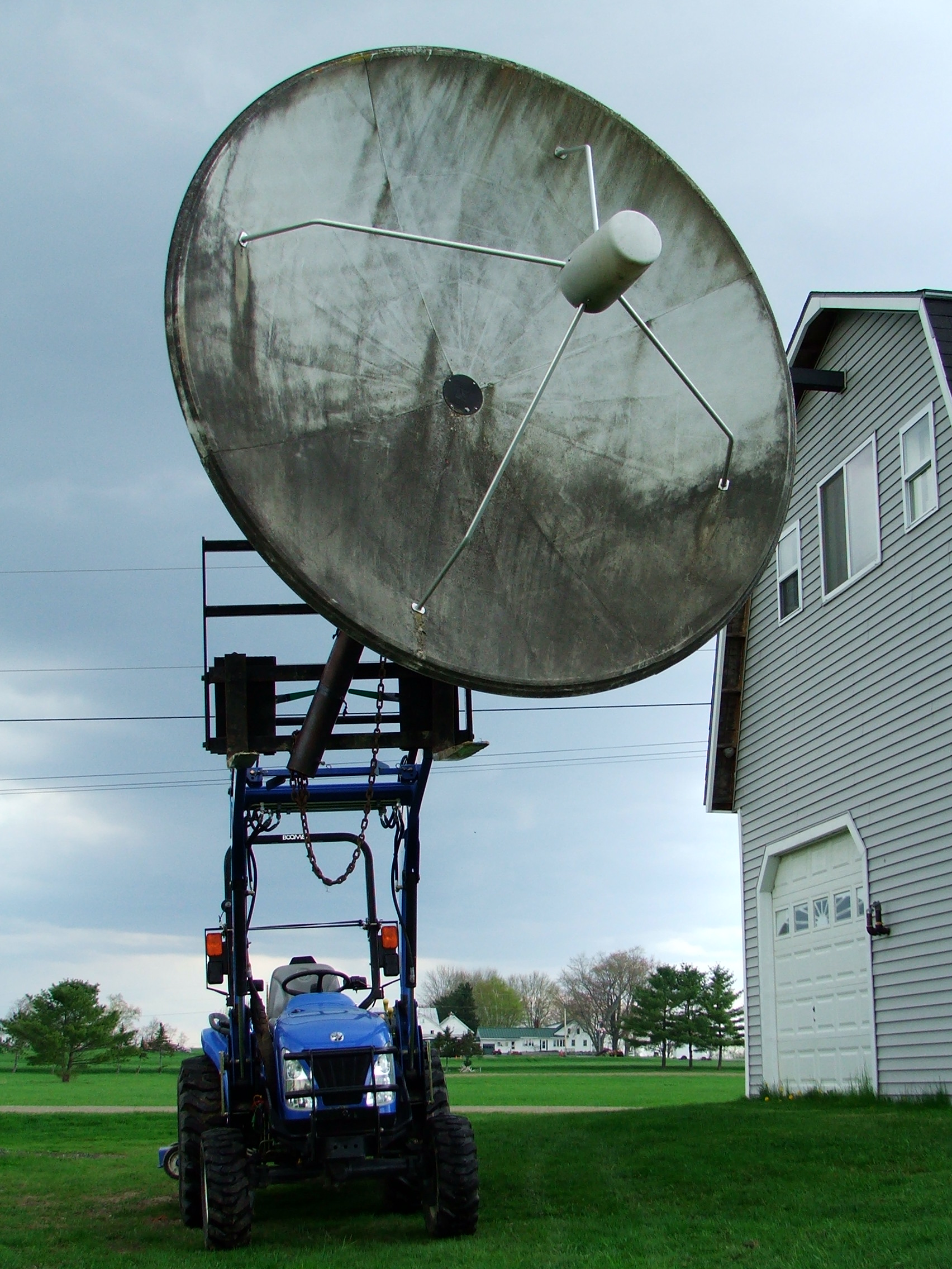

I'm looking to purchase a set of pallet forks for my JD FEL. Mostly I want to use them for unloading large purchases from delivery trucks: Box blade, cultivator, large furniture, etc. This will save me a ton of money in shipping charges so I don't need to pay for lift gate service.
Since my use will be limited I'm looking for some that clamp or chain on the bucket. Any thoughts on pallet forks that clamp on the bucket versus those that attach using a chain?
Thanks
Loader Forks Bucket Forks Skid Tractor Pallet Fork | eBay
I agree the high end stuff is nice to have.
For my $135 this set of forks works for me. They can be installed and removed very quickly and really need no storage.
As you can see in the last photo (power line poles) the cutting edge does not carry the load as the clamp on type. I tried to see if our 60 HP back hoe would break them but the loader bucket would by-pass when overloaded and they did not bend or break.
They are round which at first I was upset about because I did not catch that when I ordered them but it turns out in the hollow line of forks the oil well pipe is stronger of the options.
Keep in mind they are only $135 forks and the bucket blocks the view but I found putting a 2x4 in the standard loop helped know their angle. I have a spotter in most cases anyway.
