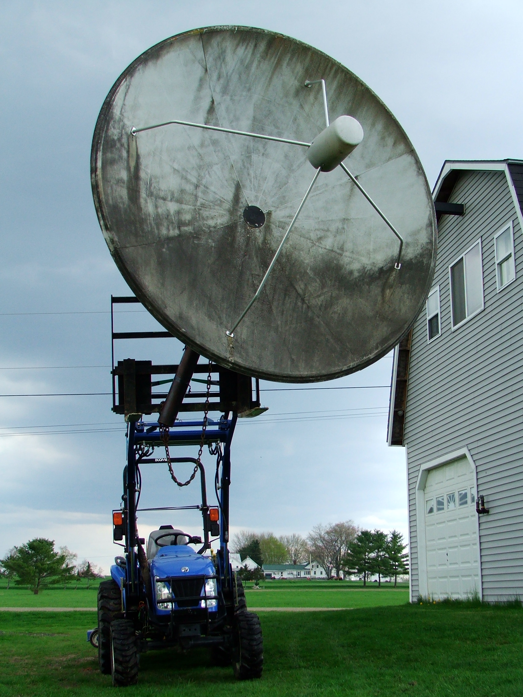

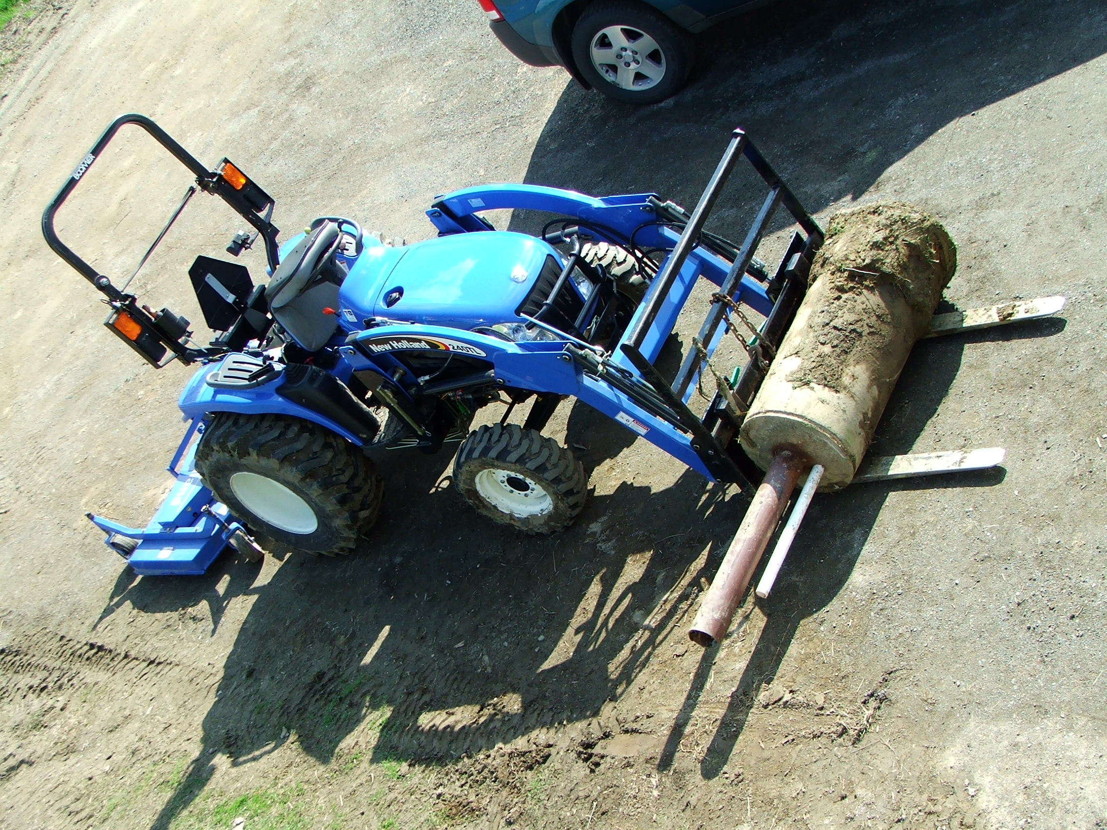

If you have a quick-'tach bucket, go with dedicated forks. I got mine off ebay; NEW 36" PALLET FORKS 2300lb & TOP AND BOTTOM BAR | eBay
Made my own frame, mostly from scrap iron I already had. I store my tractor with the bucket off anyway, so it doesn't take any longer to put the forks on than the bucket.~~ grnspot

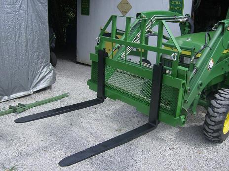

That is an awesome set of forks you ordered.:thumbsup:
That's what I'm expecting. They appear to be rated at 2300 lbs, and my little tractor has a lift capacity of 2000 lbs. So I shouldn't be able to mess them up (assuming proper operator habits). I believe they shipped yesterday, and I'm supposed to receive them Monday, so I'm pretty excited.

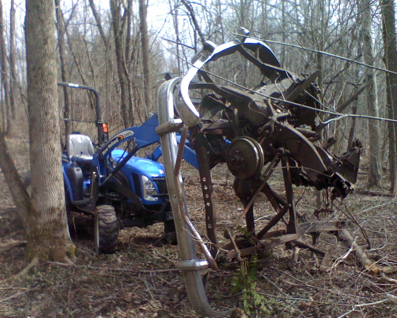

You can also use forks which they are not made
but necessity knows no law
