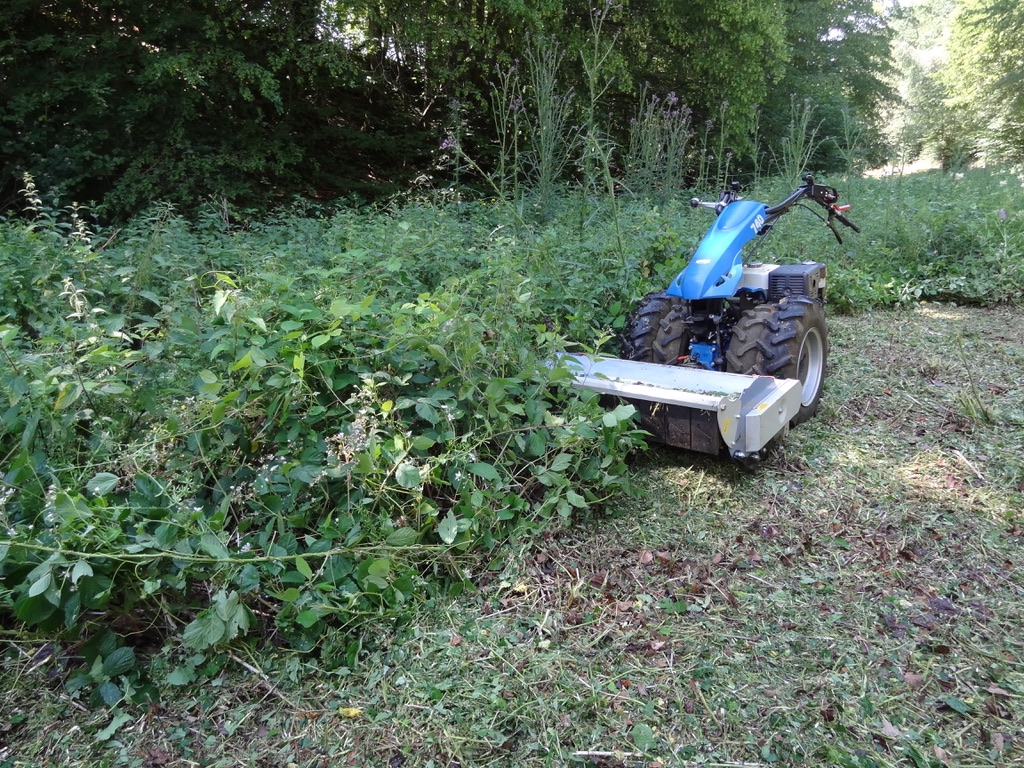

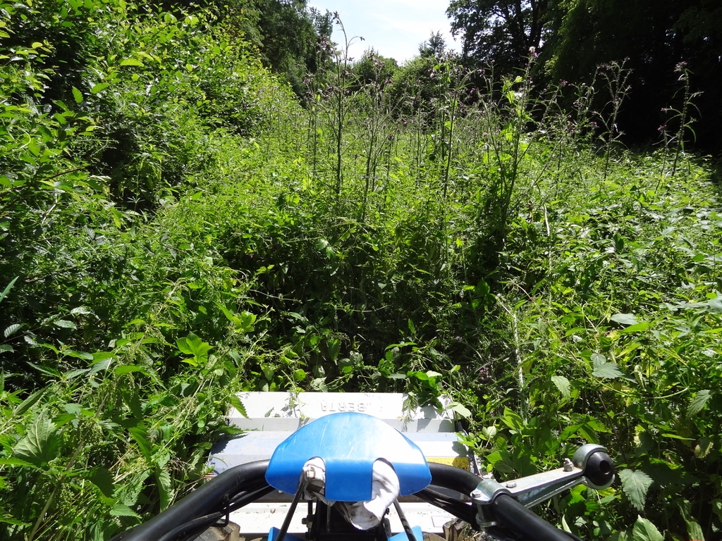

Most of my jobs are tougher than that, and are quite similar to what I see on your photo. In my area briars and honeysuckle are rarely a problem, but we have a lot of blackberry, eagle fern and other plants with up to 1’’ woody stems, which the flail will happily mow. On the following photo you have the operators view as I looks when I begin a job. As the first cut usually has to be full width, I try to find the part of the plot with the least dense material:
Subsequent cuts I usually do with 1/2 to 3/4 working width, depending on how dense and how tough the material is:

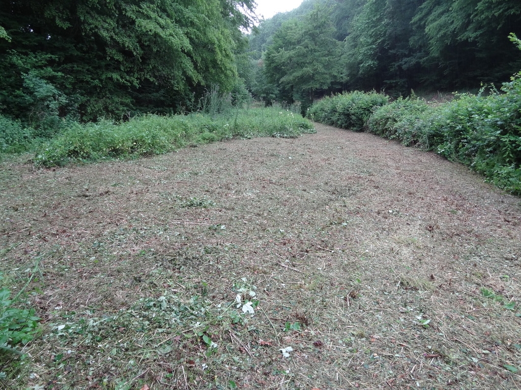

The final result might then look like this:
I think the Grillo G110 with the 85 cm (34’’) Berta flail mower will do the job pretty clean, but you are surely in for a workout! 5 acres is quite a bit, and I would do your job with 1/2 working width to allow the Honda engine to maintain maximum engine speed, but also to basically run over the plot a second time, cutting the stems that „survived“ the first pass. Looking closely at the front of your photo, you have a number of stems still standing. Based on my experience, I would need around 35 hours to do the job to the standard shown above, so that would be quite a job for this old man ;)

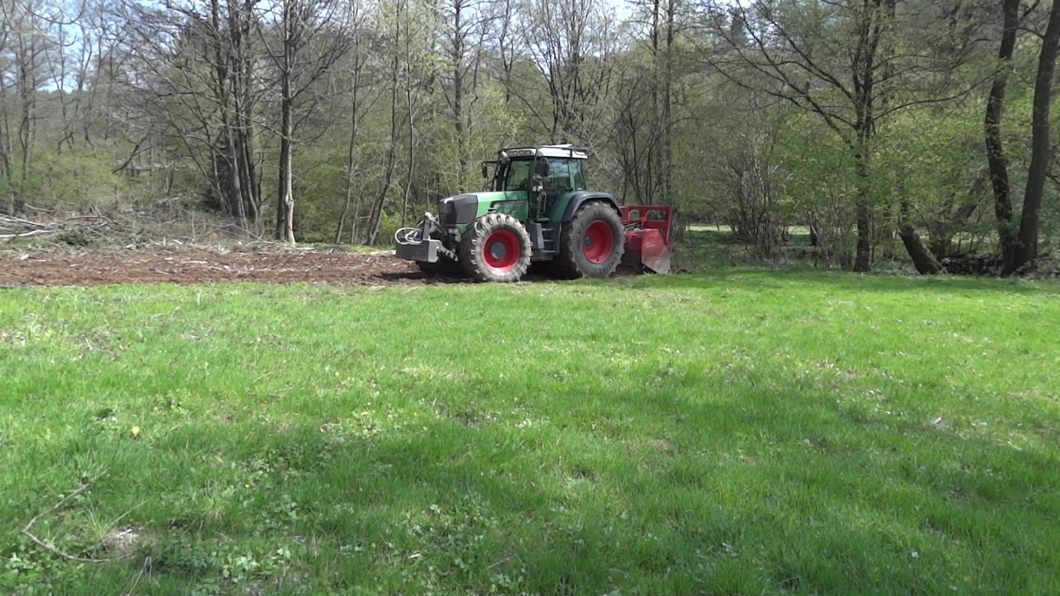

I got a meadow some years ago that had been neglected for years, and was overgrown with blackberry, briars and even smaller trees. I cut down the trees and took the best parts home for firewood, and left the rest on site. A contractor in my area has a big powerful tractor with a forestry mulcher, and he did a marvelous job in cutting everything - including tree stumps - into small bits to make everything easier to decompose
On top, this mulcher will even out your plot, find any hidden obstructions that might be there, and it will be very easy to keep the plot clean with the flail mower once or twice a year.

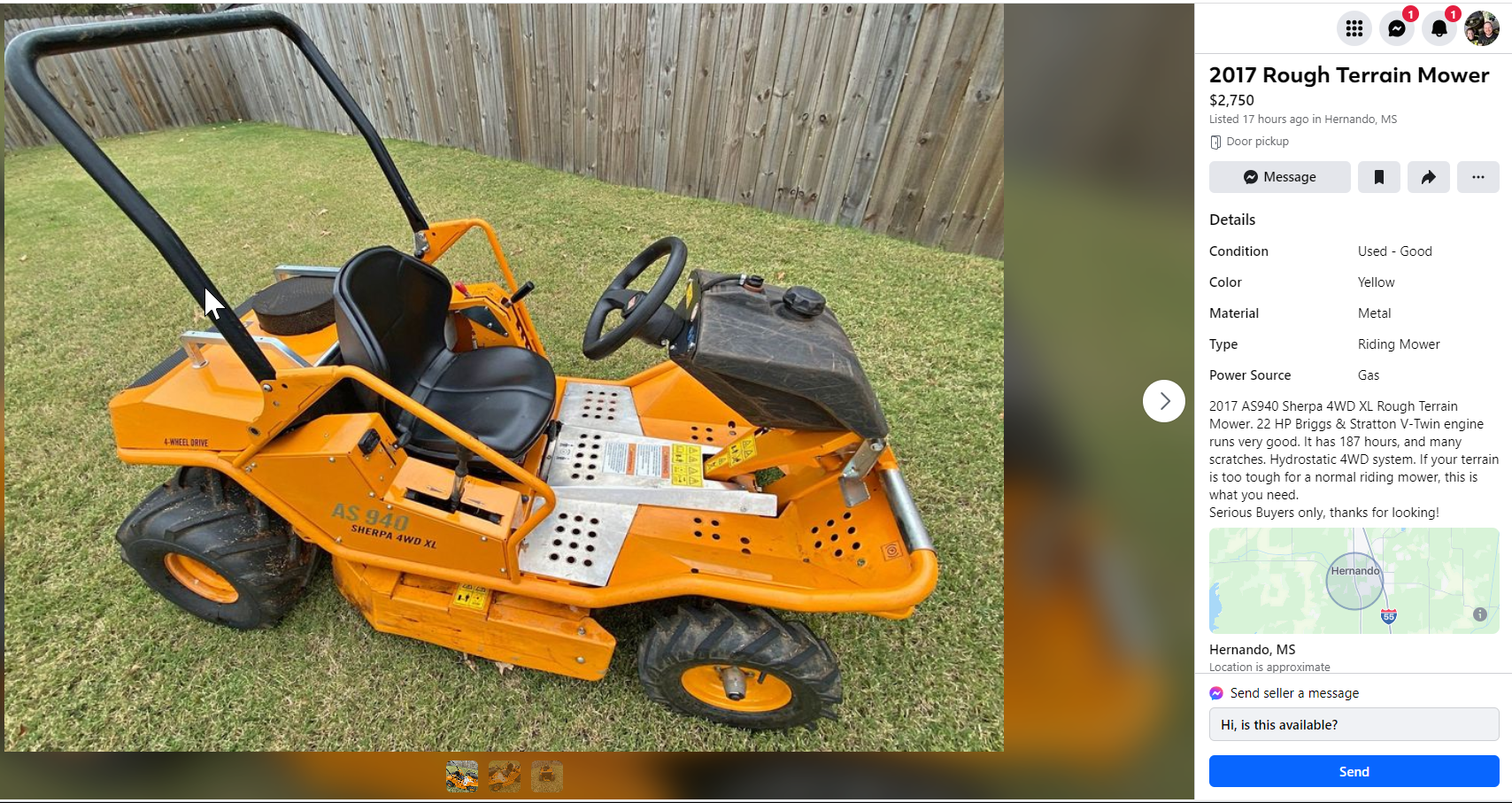

I just saw something for sale on FB marketplace that made me think of this thread. Not sure if you will be able to see it but I found the manufacturer's website. Looks like it just may be the tool for the job. Minus all the thorns in the face obviously.
