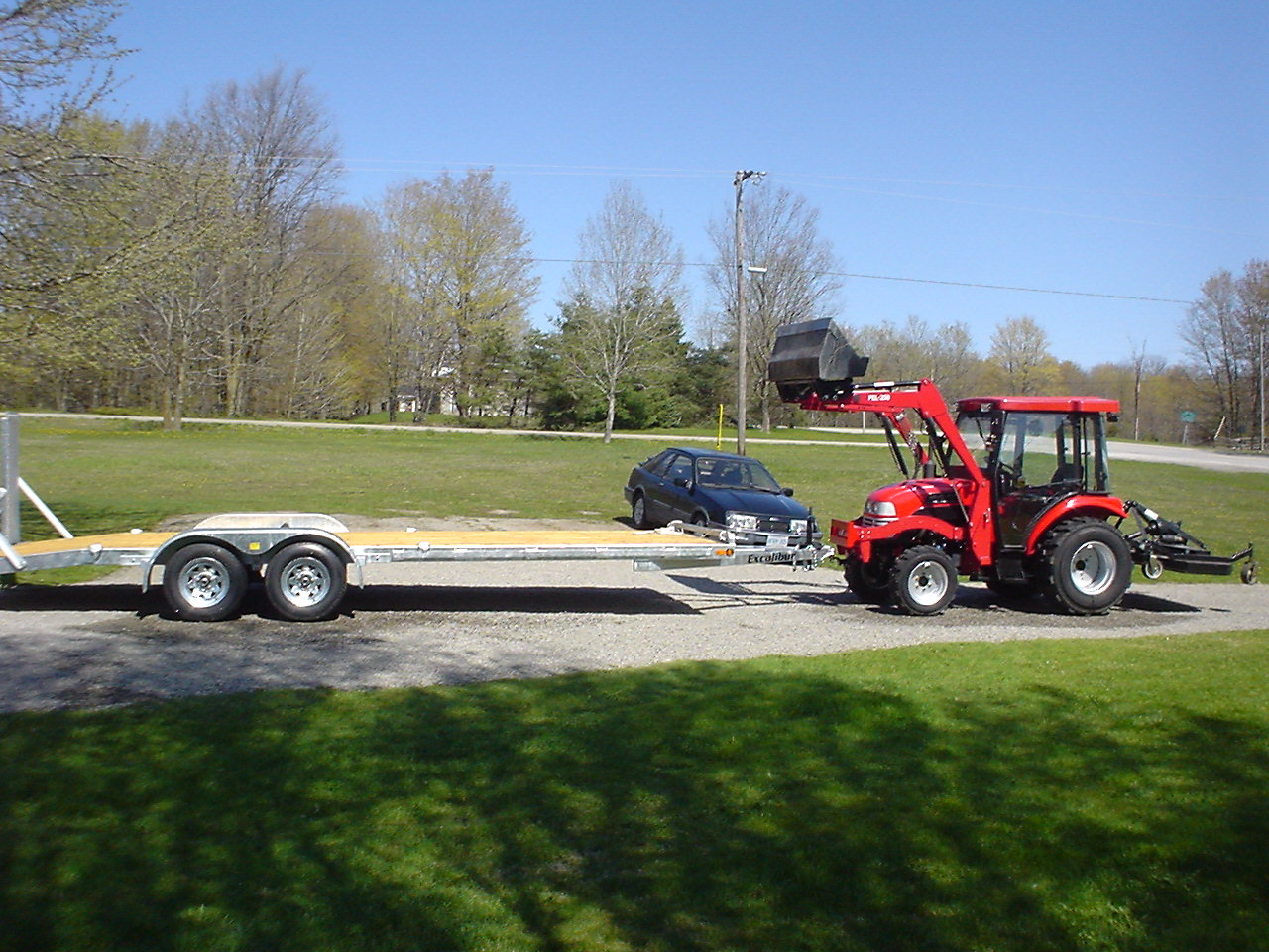

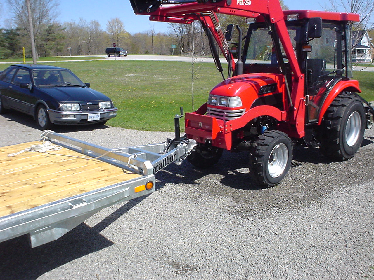

One thing I have noticed with a tractor's loader arms moving trailers, is that single axle trailers move and turn easier. Tandem axle trailers tend to want to go straight and not turn. Especailly if on an incline. I have a circle drive that has a slight incline leading up to a garage door. I need to get headed out the main drive and then back/push the trailer in the door. If I try the other way, I loose steerage with the tandems pushing them up. Jon
   / Options for SSQA trailer mover (receiver hitch) ? #82
Well, one thing i noticed about moving trailers with ball on fel is that since the ball is so far out in front of your front tires it amplifies all your inputs and makes it more sensitive to steering, but less steering force out there as well.
But as far as the tandem axle not wanting to turn, if its empty i would just pick it up further with the loader. Front axle may not come off the ground but should be unloaded enough to make it easier to slide those tires sideways a little as youre steering it around.
   / Options for SSQA trailer mover (receiver hitch) ? #83
Tail drags if the tongue is lifted too high. Jon
#84

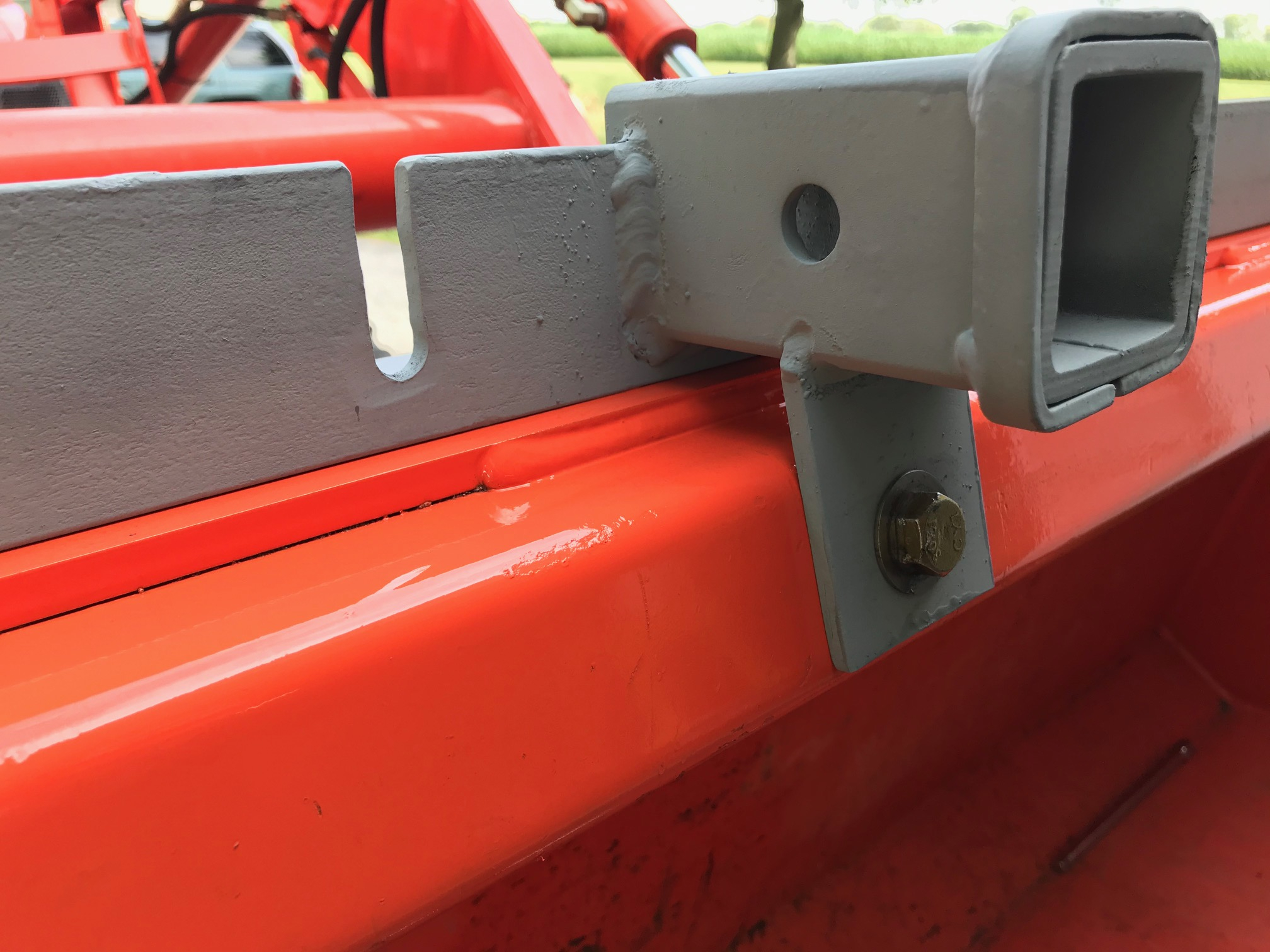

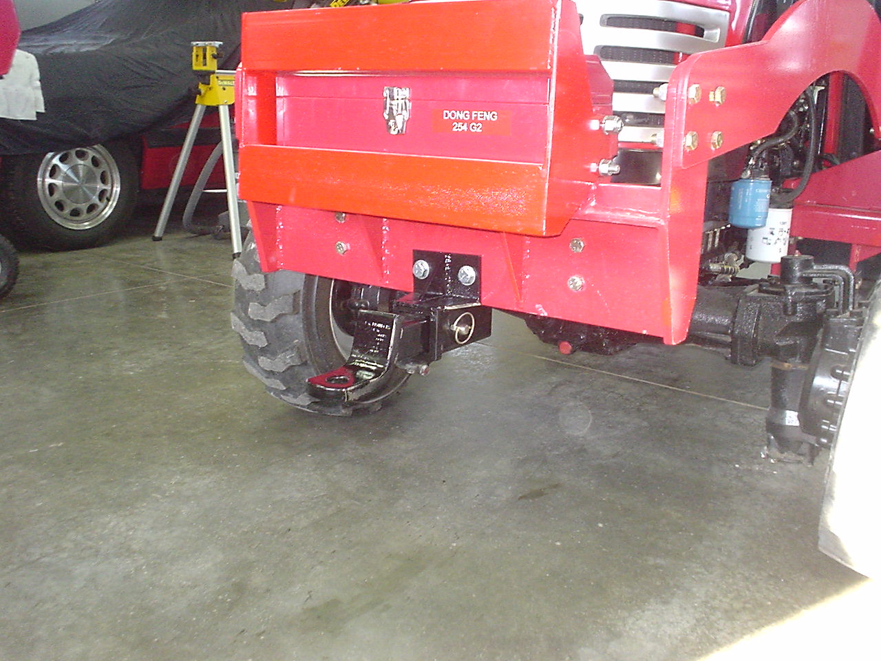

That is an advantage of my single arm hitch receiver mount. I do understand that I could be twisting the loader arms, but my trailer are empty at the time and are light tongue weights. Jon
Yeah - I would have definitely bought that style also, if I could have found one for sale anywhere. Instead I went overboard and got more attachment than I really even needed. 🤦‍♂️

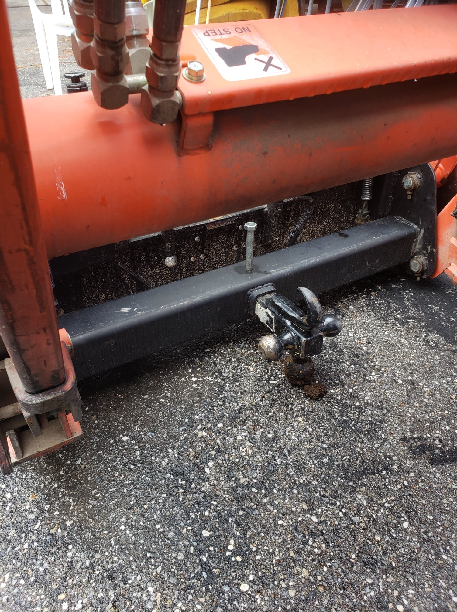

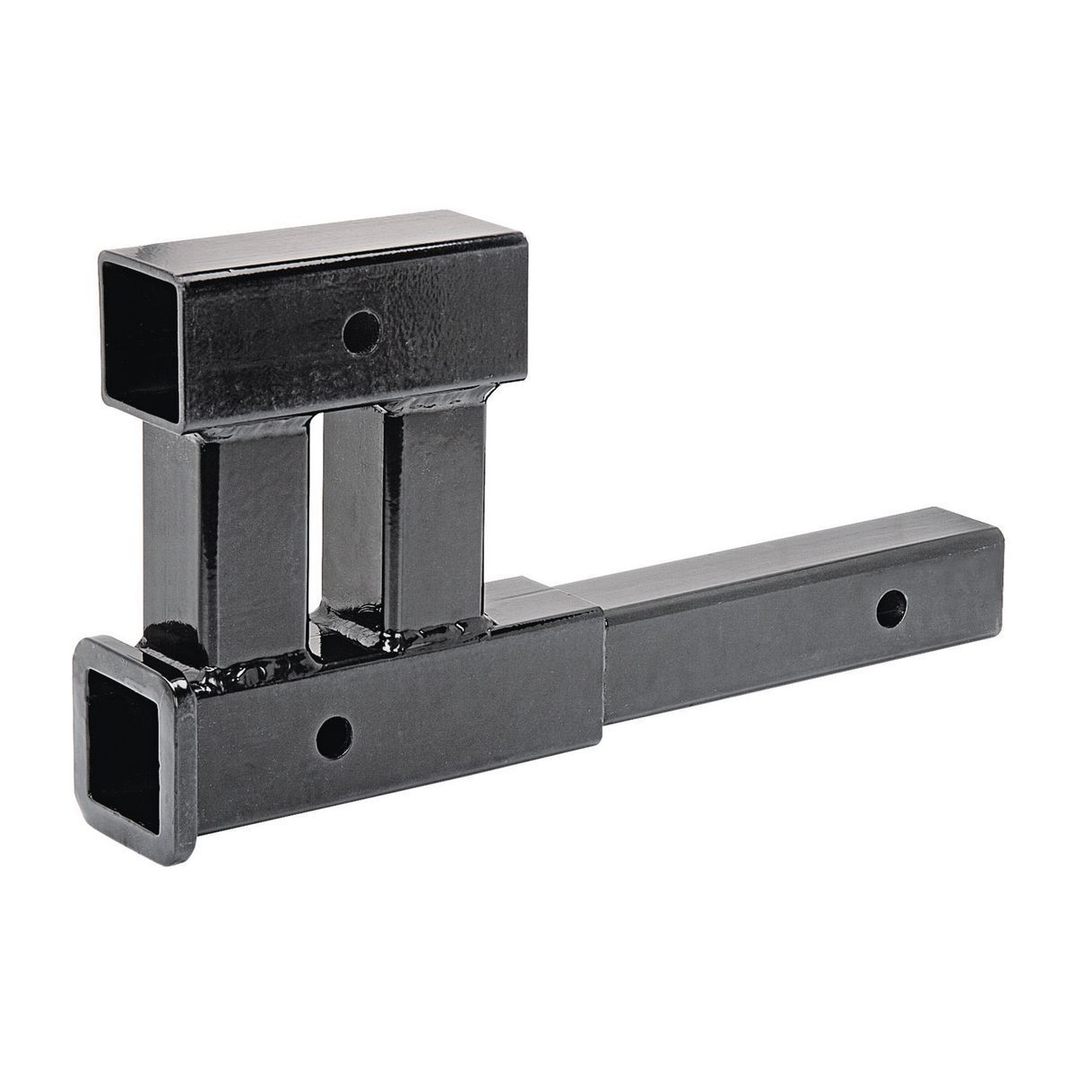

Well in some sorta mostly good-news a $32 hitch extender from harbor freight made this thing work a lot better for light trailer toting.
I can now see the ball when I stand up, meaning I can snatch and move trailers without dismounting. huzzah.
I'll probably still get off and latch the coupler on any heavier trailers I shuffle around, though.

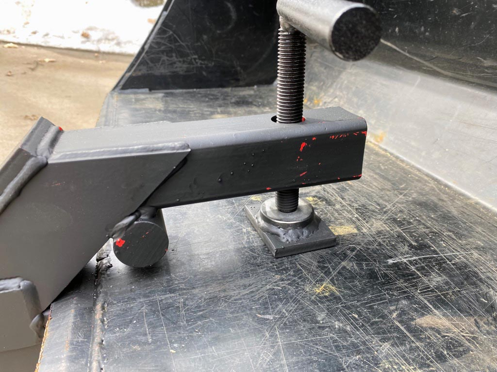

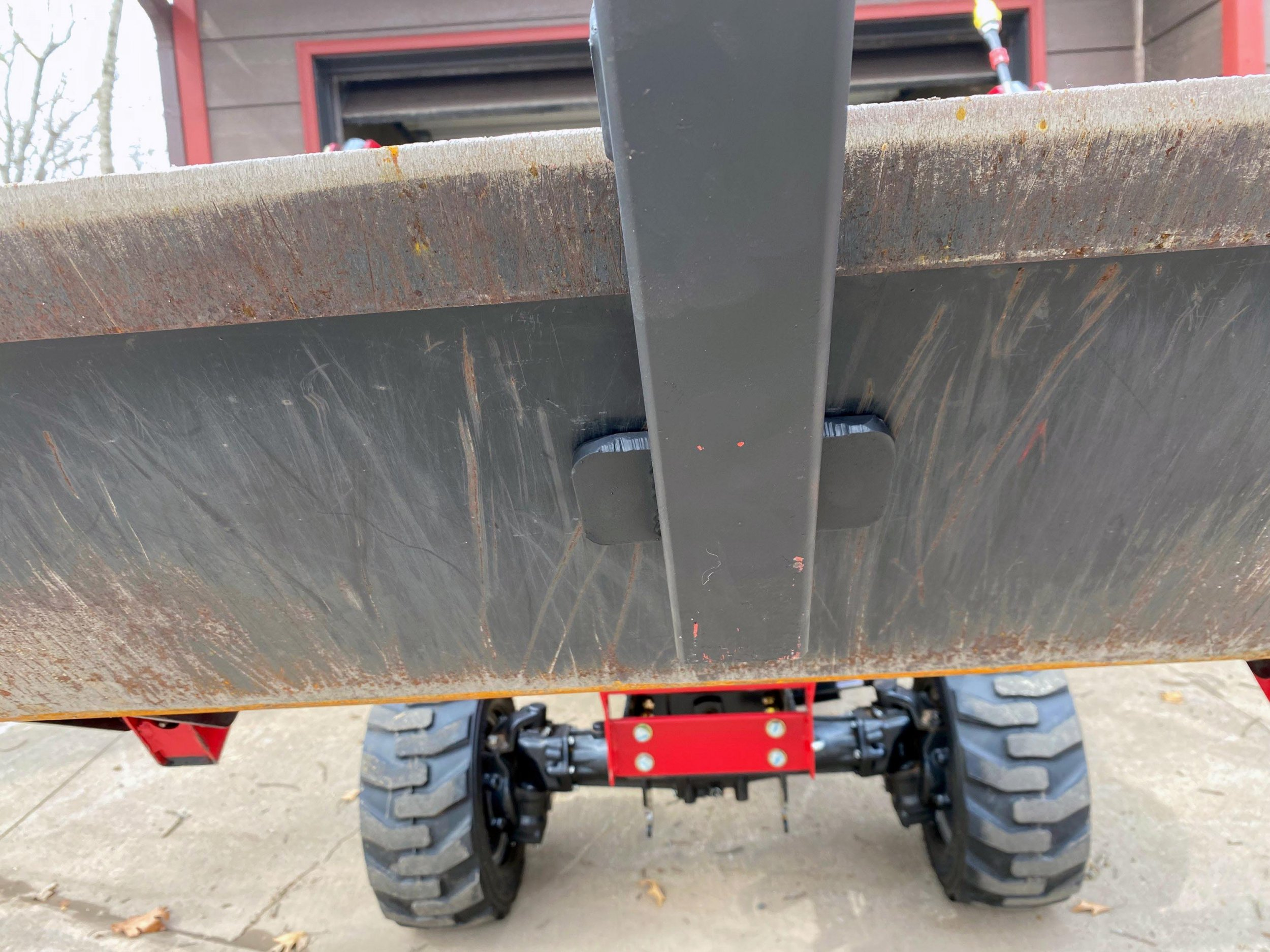

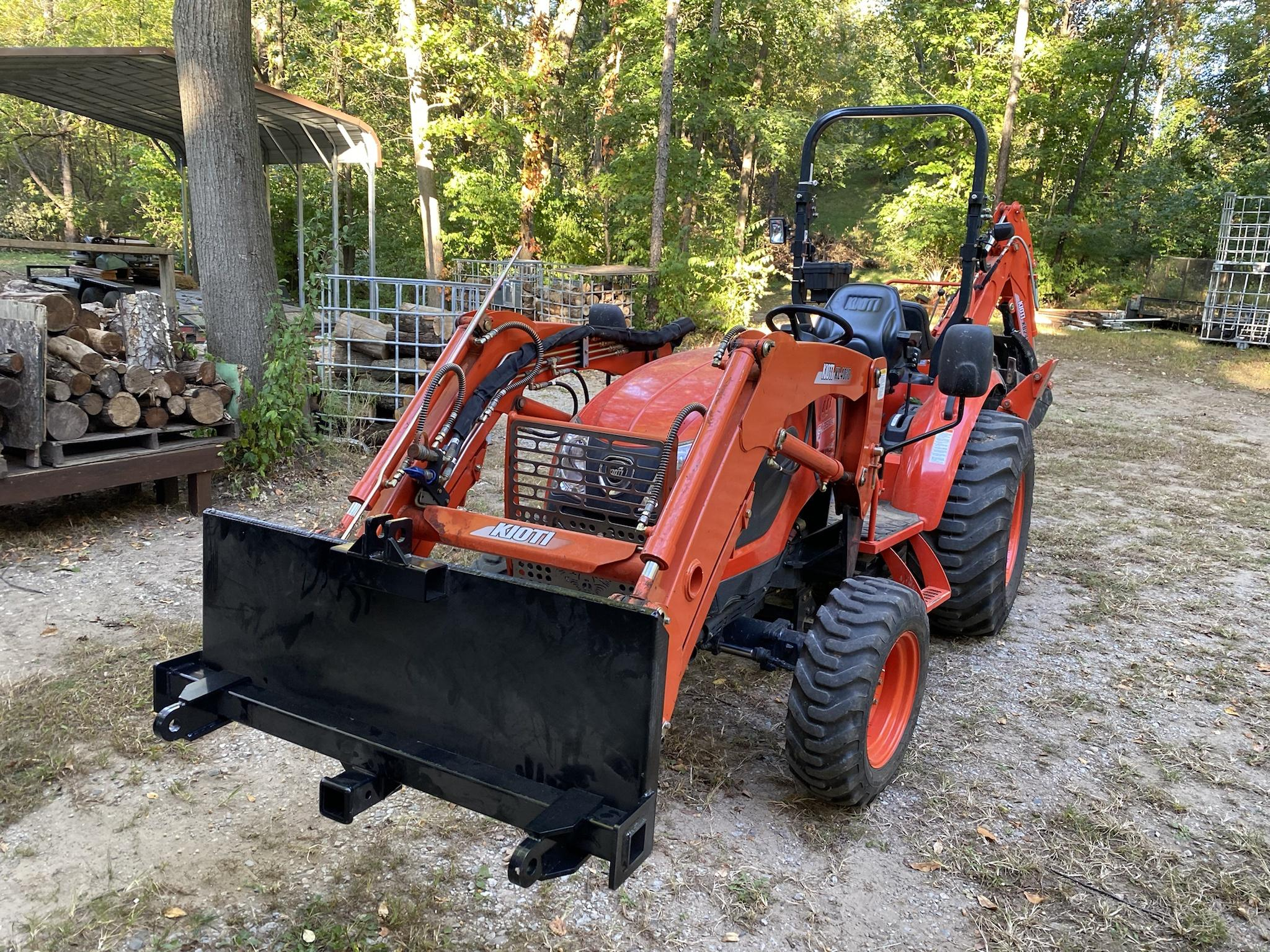

Old Thread, but I have had great success with the bucket mounted hitch, and moving easily 3500-4000 lb trailer with 300-400 tongue weight, up and down an incline. I purchased the one found on Amazon:
(https://www.palletforks.com/skid-steers/bucket-and-accessories/clamp-on-bucket-hitch-v2/192102.html)
Then welded larger iron parts on the clamping surfaces. I then built a wood frame for the hitch, to control any tail movement. This has fixed all the previous faults I had read about. The 'Adjust-A-Stud' supports the wooden frame with lateral tension to the sides of the bucket.
