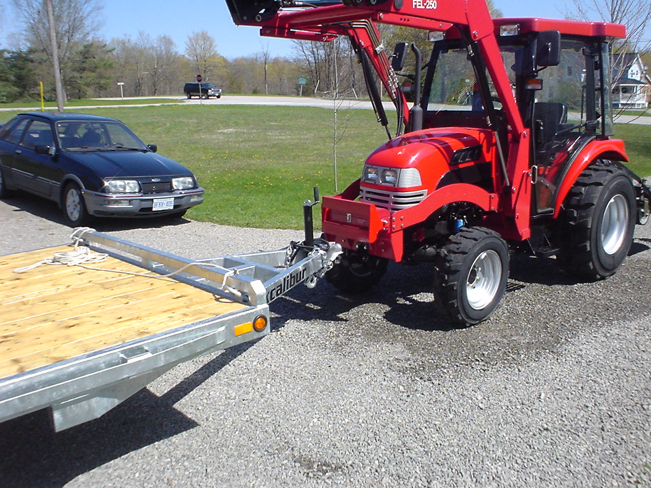

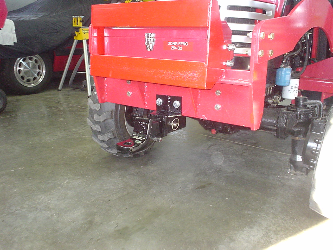

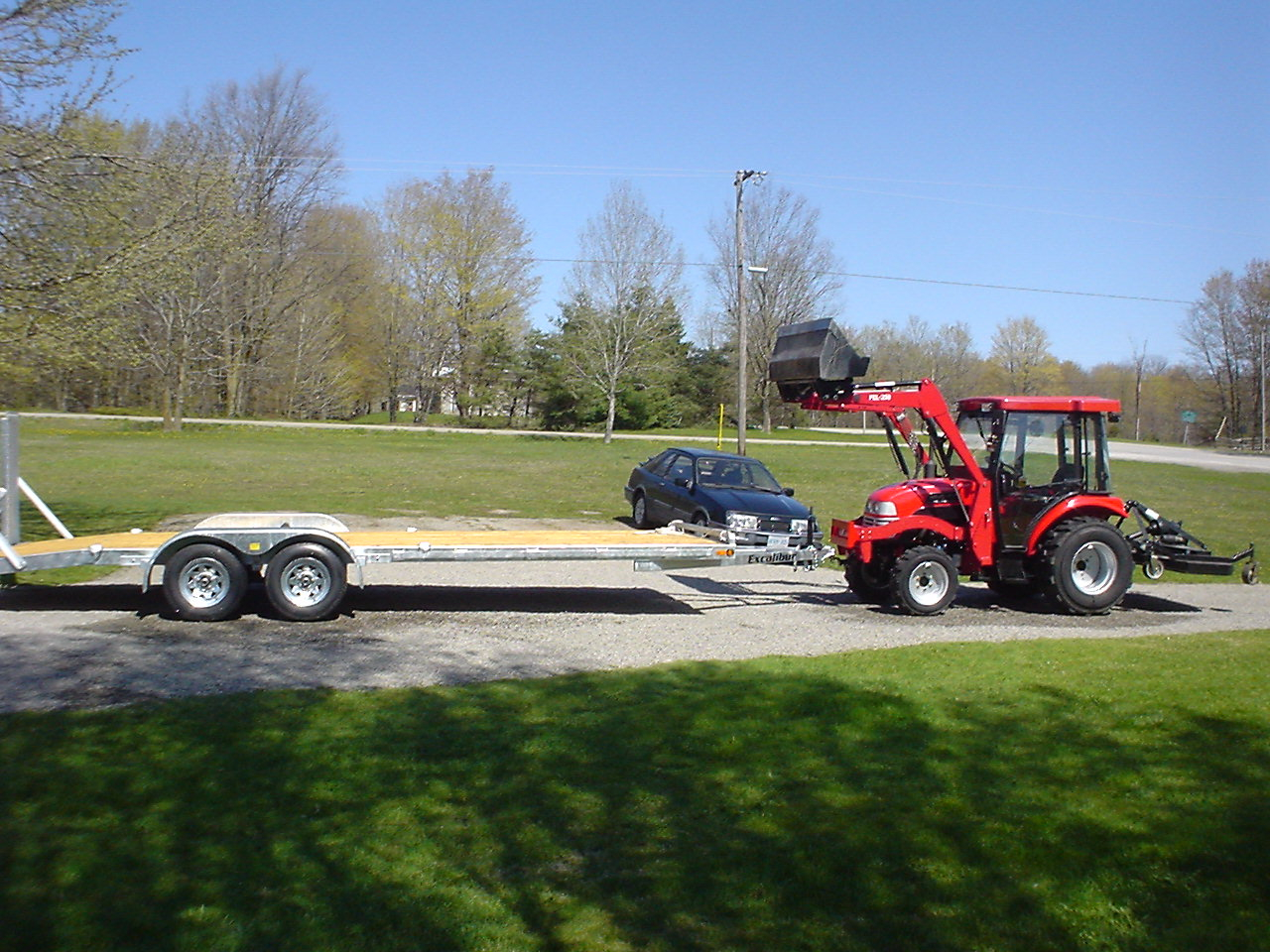

I added a receiver hitch to the front of the tractor.

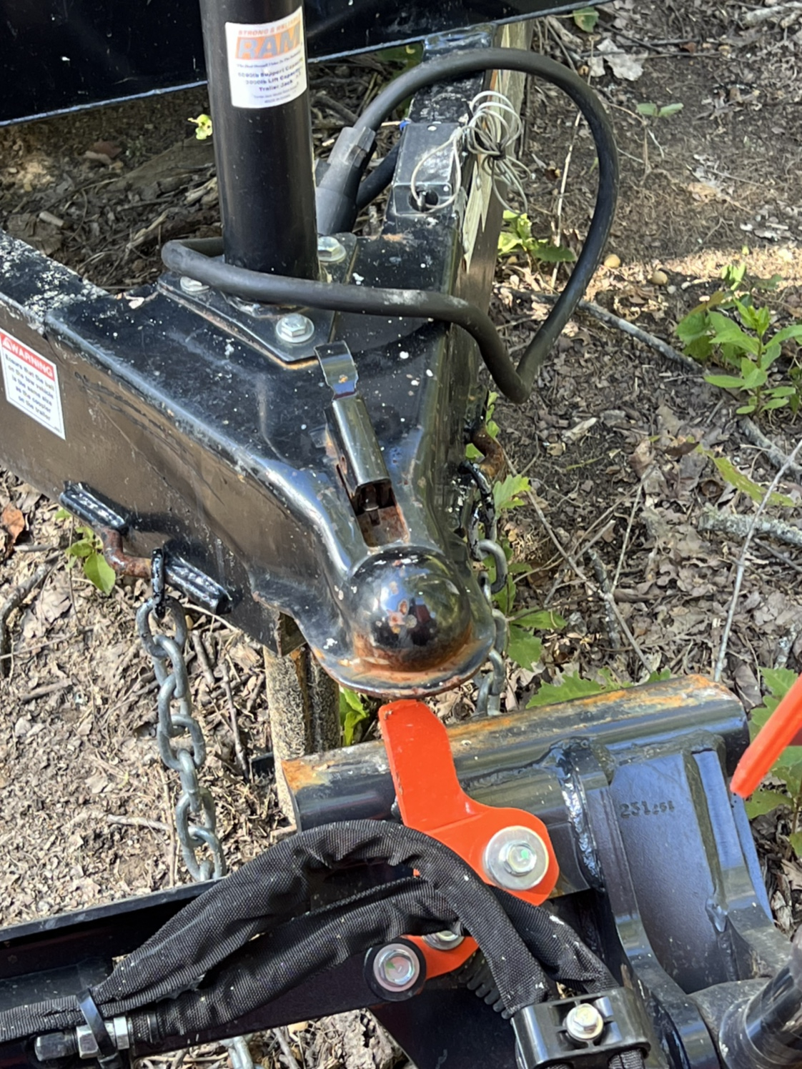

Ok, my SSQA to 3-pt adapter arrived yesterday so here's some pics.
It arrived in a mutilated box that was completely covered in packing tape, that obviously didn't hold up real well during shipping. But my wife and the UPS guy ripped it open to inspect for damage prior to accepting it. None seen.
Unboxed and it looks pretty decent, to be honest.
Drove up with my tractor and it went on the SSQA smoothly
BUT, it is a bit sloppy. I don't want to put heavy load on this thing until I weld on a bit of bar/plate to tighten up the SSQA pin fitment on the bottom. Right now, it doesn't really seem like it would fall off, but I would sure hate to find out during a heavy trailer haul or aggressive 3-pt implement operation.
Here's a pic underneath showing the excess clearance and how the SSQA pins are not engaged far enough to keep it on real tight.
Overall a fairly decent product for $319 shipped, at least compared to some other options out there. It was in Illinois and got to me in just 3 business days, very nice.
What I bought:
All the other options on Amazon prime appear to be identical. The titan one too, just for an extra $100.

#56
If you can see over it, you can spot both rear corners and see the angular adjustments much easier.
Campers are tall, i dunno if any CUT would get the operator high enough to see over one.
   / Options for SSQA trailer mover (receiver hitch) ? #57
The trailer is much higher than the tractor, there is also an A/C unit atop of the trailer. I can't see over it when backing it in with my truck either. What does seeing over the top of the trailer have to do with pushing it through the barn door?
How do you know where the edge of the door is when using a tractor? At least with a truck and its mirrors, you can see down the edges of the trailer. On my B26TLB, I can see over the pop up camper. But once in the barn and trying to get close to something down low, I need to get off the tractor seat or have a spotter. Jon
   / Options for SSQA trailer mover (receiver hitch) ? #58
As of right now the Jayco RV trailer is in the barn, for the winter as camping season is over for us now. Backed it in, as I have done before, took quite some time and many get out of truck and look. Back up 5 feet and look, pull out and try again, back up 5 feet etc, I am willing and hoping that by pushing with the tractor it will go easier.
#59
Aight. I brought my ssqa to 3-pt adapter to work today so I could get it made more betterer. 1/4" plate added to close up the gap under my loader's ssqa arms a bit, retain the ssqa pins by that much more material, and simultaneously tighten up the slots. Hopefully gets all the slop out and makes it fit nice and tight.
I thought I ground off enough powdercoat to get these pieces of flat stock welded on nicely, but my poor dude steady-eddie had to melt out a bunch of powercoat still. Sorry, Eddie.... smelled pretty gross.
Test fit in a couple hours.
#60
Fits like a glove. Add 1/4” stock of height, remove 1/4” of ssqa pin slot breadth. Now i gotta grind, prep and paint this sucker.
