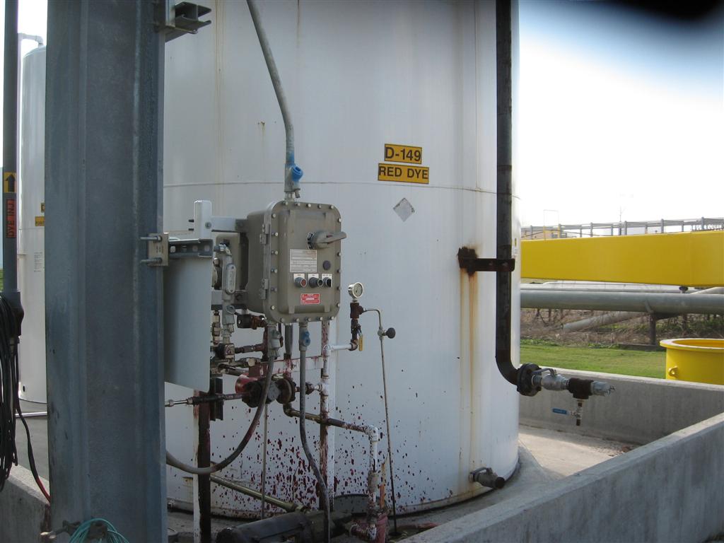

It doesn't. Time to whip out my dye pictures again. Picture taken at our refinery. We sell diesel to the public (mostly barges, tankers, not by the 5 gallon jug). If you have the paperwork and are exempt from taxes, you get red dye, if not we charge the taxes and you get no dye. The dye is injected at the last minute. We don't store dyed diesel. As you can tell, no one likes working on the dye machine. :D
Personally I buy it at the local gas station. But my tractor only uses about 1/2 gallon an hour.
Rob
