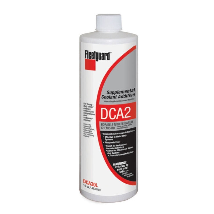

Well on coolant, a heavy engine antifreeze with the additive that stops pitting of the cylinder liners or the cast cylinder block.....forget the name of it.
Anti-Cavitation additive

If it's monitored for condition and coolant additive or spin on filters are used coolant will last forever. The PH balance is the critical element in keeping coolant where it needs to be. We literally had a couple thousand pieces of machinery and it was far cheaper to maintain the coolant than to replace it every couple years. We had spin on filters and PM mechanics that checked the coolant as part of the inspection. As someone mentioned. Heavy duty coolant is an important factor. Coolant isn't all the same and if you go buy cheap automotive coolant and mix it in the long term results will not be great.
