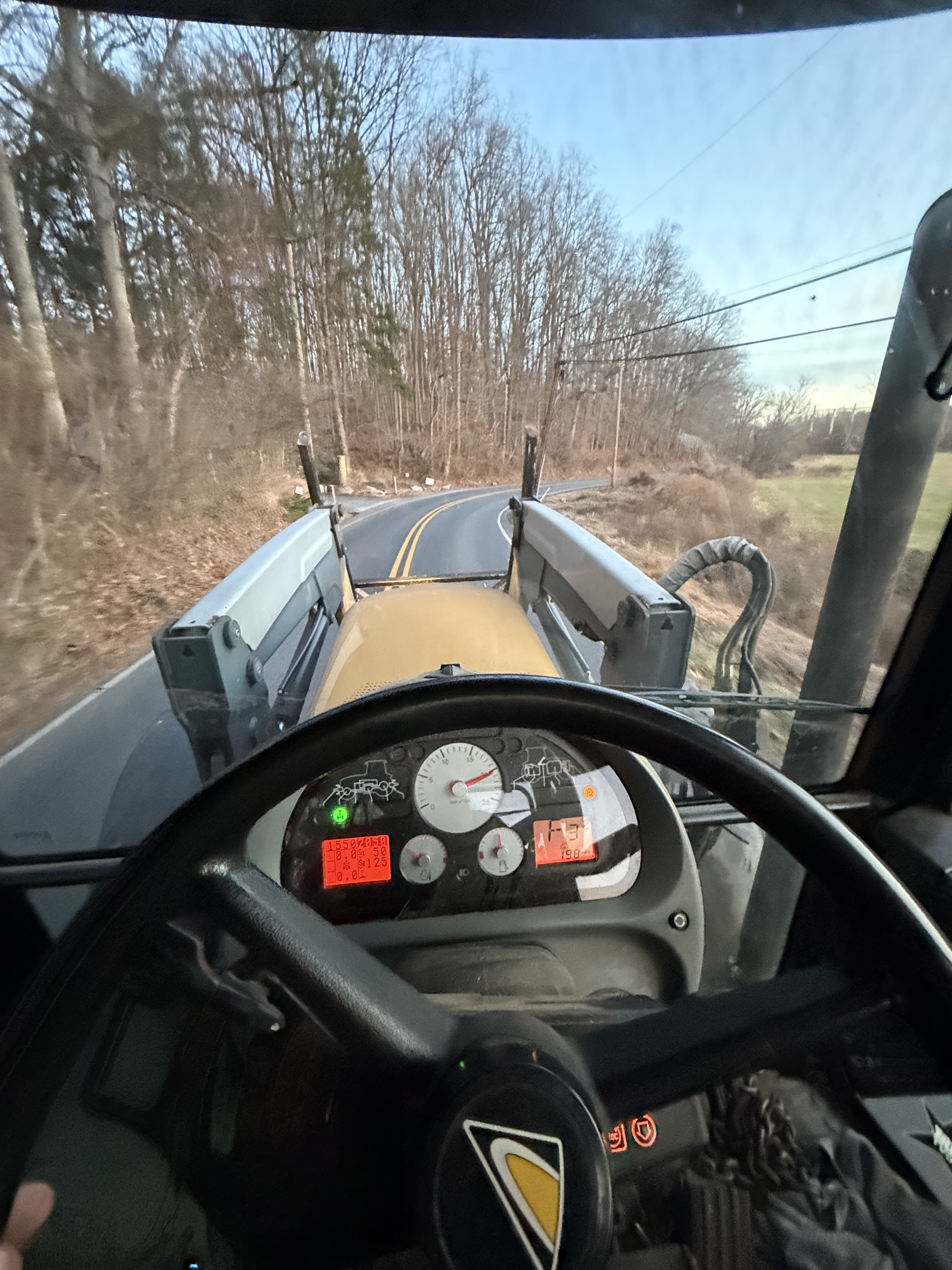

Regarding shutting off with a hot turbo. I see why not to do so but how long should one wait. There is no gage to check that it has cooled. Is this 30 seconds at idle? 5 min?
It’s a good question. I usually wait ~5 minutes if I’m coming in hot and you can hear the turbo spooled-up, but that’s just a guideline.
I usually come into the shop at road speed from a field miles away, so I tend to wait longer since I’m probably 1200 degrees at the turbo. Here I am on the road, not exactly pushing it because it’s a windy, dangerous road, but still the turbo is boosting pretty good.

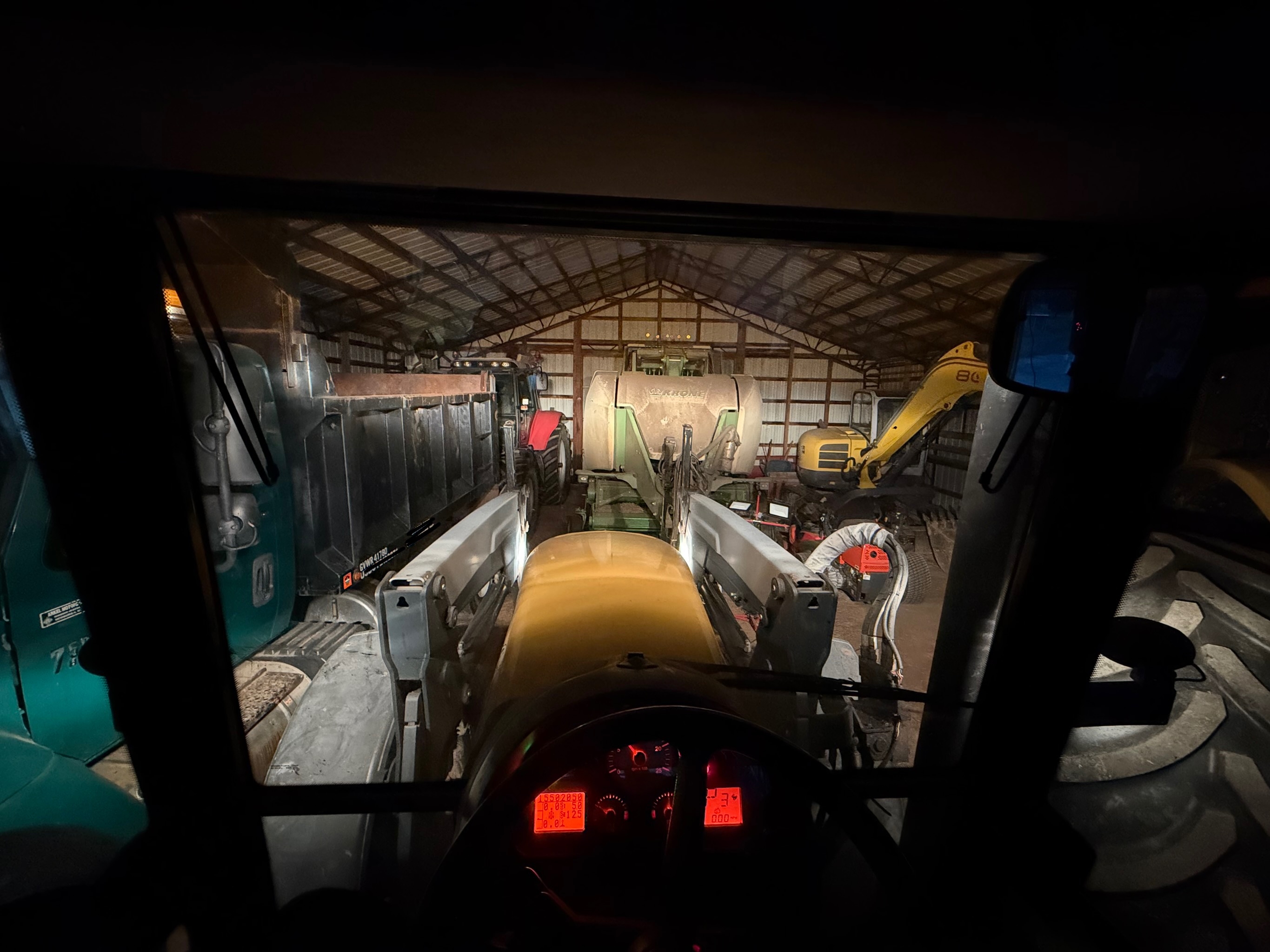

Here I am pulling in tonight into my barn. I’ll just let it cool off a good 3-5 minutes.
If you are just moving around your yard at partial speed, a few minutes of idling is all it takes.
Just park, idle down, and find something to do for a few minutes (grease fittings, blow out radiator, clean-up, etc.) and that will help your turbo bearings and oil from coking.
